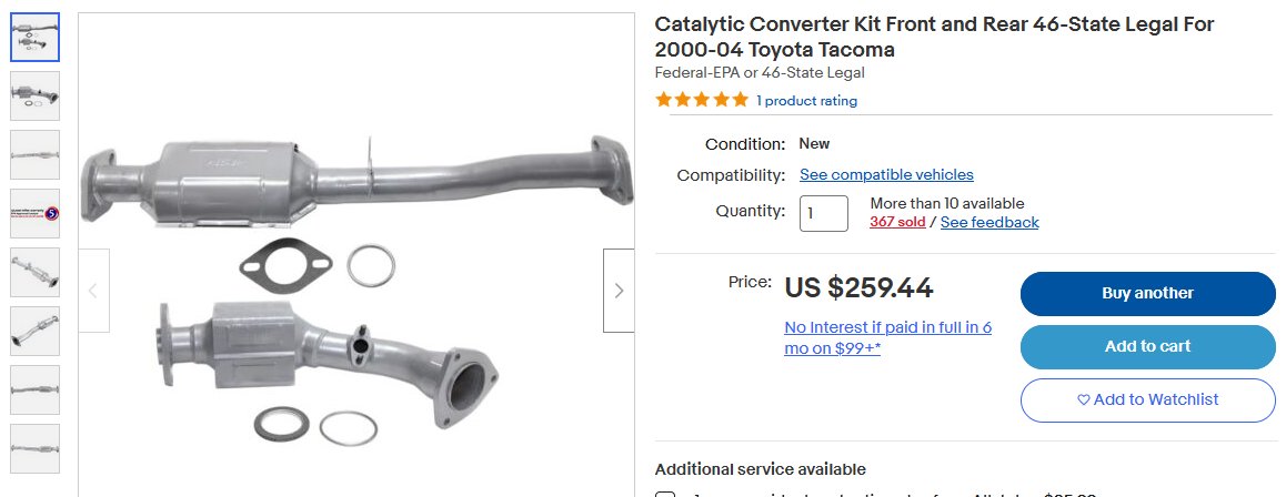

    I did have a CEL for the O2 sensors, so i replaced those and the code cleared, I did replace the cats while I was at it since the flange studs were rusted beyond repair. Replaced with some cats from ebay I found referenced in another thread. (pretty cheap, the paint melted off on the first drive)

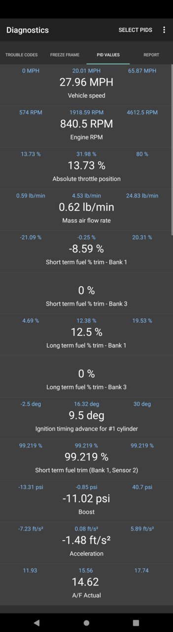

    Also ran an OBD diagnostic and got this screenshot after driving about 5 miles. I don't know what I'm looking at for most of this, never had to troubleshoot this in depth before.
