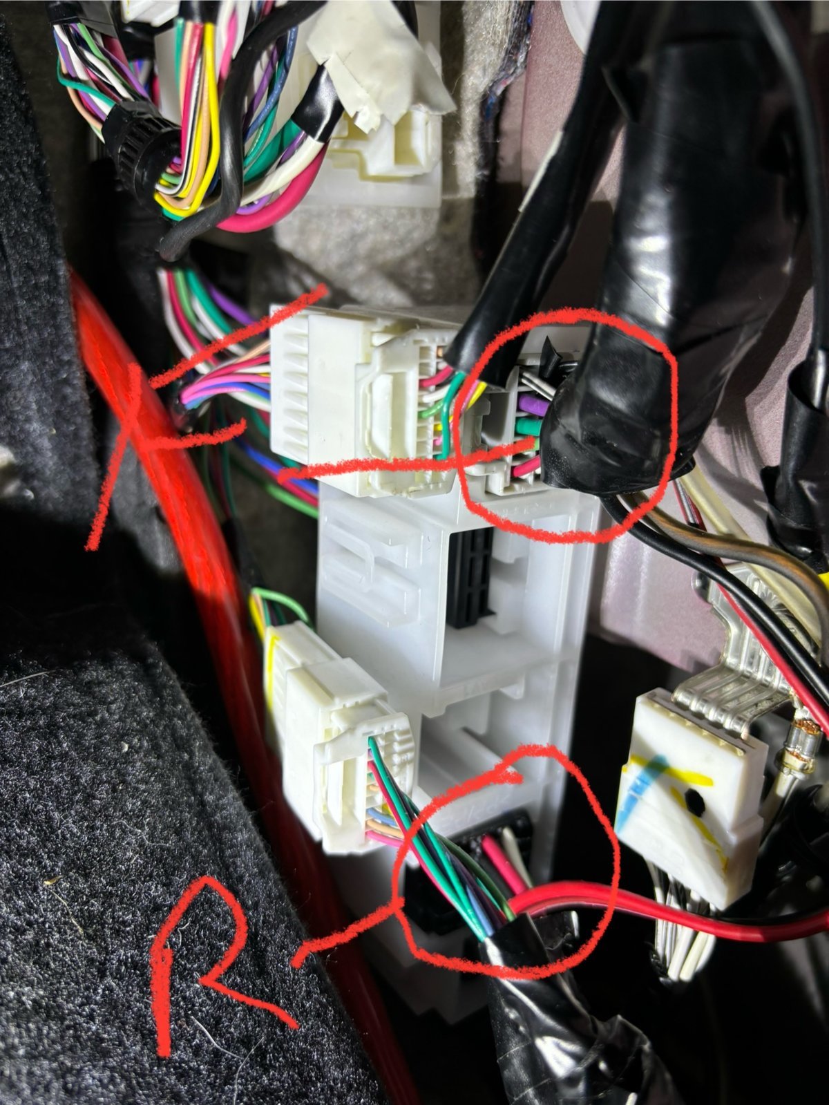

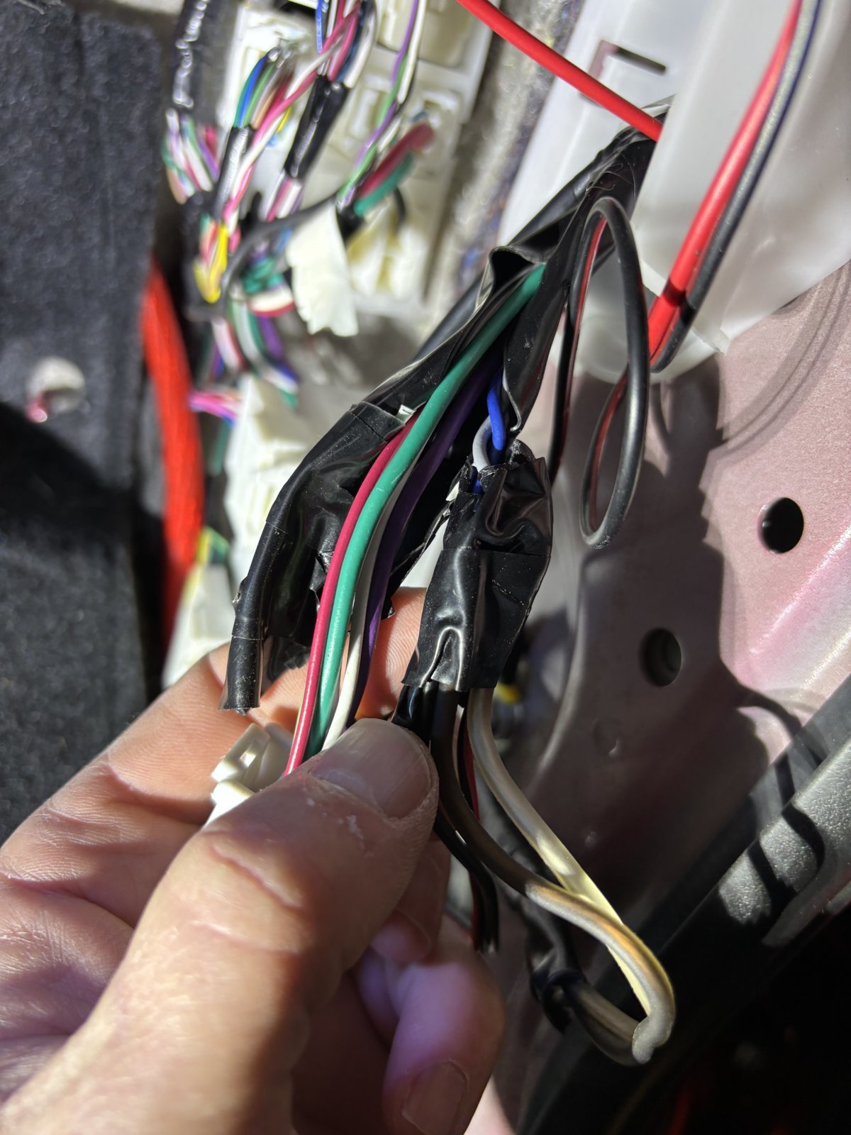

    Here you go. Pull kick panel and scuff guard... this took me 30 seconds.
    find this plug. use the f (front plug)
    pull the plug that says front pull the black loom off look for the wires twisted together this is your front signal tap into it...run a new speaker wire from this wire to your convertor. now since you have these covers off run your 12 volt amp power wire from your battery. Find a ground near your amp, ground it... hook up wire from battery to amp... plug in rcas hook up remote turn on wire from convertor to remote turn on, on the amp turn the key on. You're done.
    My 2020 front wire color. twisted together as from factory. It is blue/gray. the only twisted wires.
    This took me about 10 minutes to soldier up and run this wire.
    NickAdams2112 likes this.

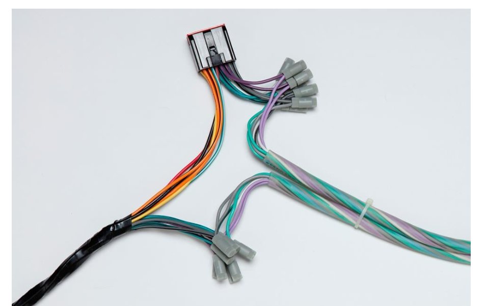

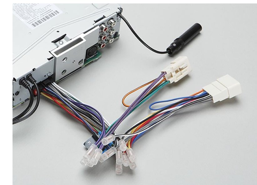

    My solution was to use the Red Wolf harness above, buy some structured wire from Crutchfield (https://www.crutchfield.ca/p_007CSW9W20/Crutchfield-CSW9W-20.html).
    The steps I followed were:
    1. Cut all of the Red Wolf harness wires at the mid point of the 8 wires.
    2. Connect (crimp, solder, posi-connect - your choice) the wire harness half (8 speaker wires) that you plug into the back of the head unit to one end of the structured wire.
    3. Run this structured wire to the input side of your amp (to high (or speaker) level inputs on the amp). My amp came with harnesses to connect this wire to that plugged into the high level inputs.
    4. Run another length of structured wire from the connections (color coded properly) on the output side of the amp back to the head unit (obviously doesn't connect directly - see next step)
    5. Connect the second half of the wire harness half (8 speaker wires) that connects to the EOM harness, that sends the signal to the speakers, to the other end of the structured wire coming from the amp (should look kind of like below without the wire bundle on the far left (orange, red, brown, etc).
    6. Plug the first end of the wire harness (from 2. above) into the head unit and the second end (from 5.) into the EOM harness.
    DONE
    This setup essentially interrupts the signal coming from the stereo, reroutes it to the amp where it is.....amplified, and then reroutes it back to the speakers.
    This negated the need to tap into any OEM wiring or pull any new speaker wire from the amp directly to the speakers which would require a lot of effort. The structure wired is a great solution as it is easy to pull and doesn't require to be loomed or taped to protect it.
