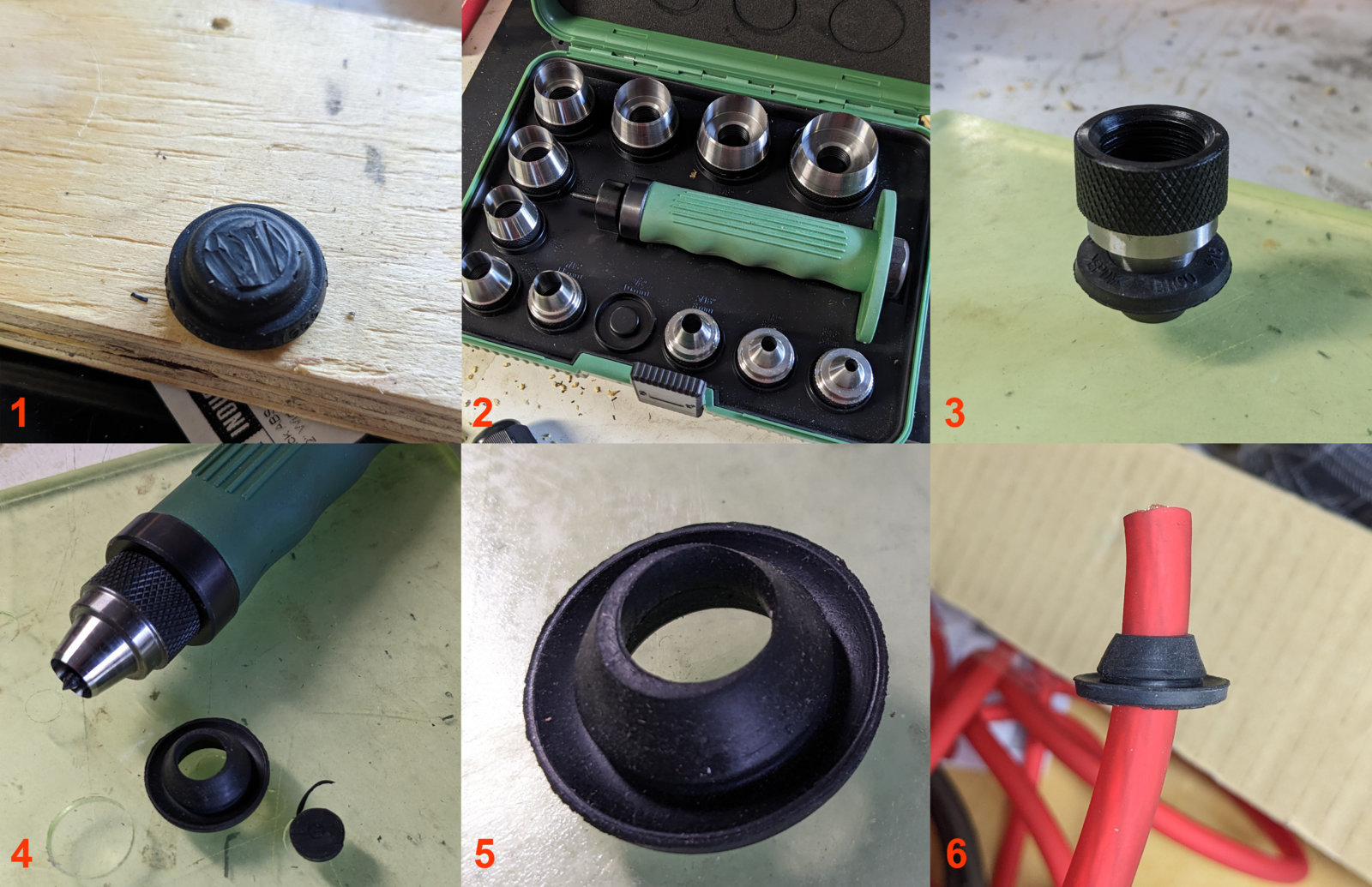

    1) Remove the grommet from the firewall and invert it so the nib protrudes out. Then with a utility knife shave the nib off.
    2) I used a leather punch set to make the hole. I tested it on a piece of plastic to see which diameter (10mm) gave a tight fit on the cable before I punched the grommet.
    3) Flip the grommet over and the punch fitting actually rests in the 'cup' of the the grommet.
    4) Two good taps with the hammer did the job.
    5) I was a tad off-center but what a clean hole. (I should have marked center before I punched)
    6) Very snug fit will not allow water in...and Bob's your uncle!
    Important note: No need to punch through the felt padding on the inside of the firewall...just feed the wire through and down between the firewall and the felt padding.
