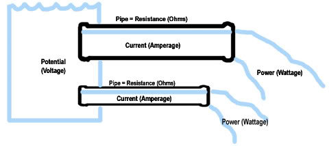

    If you run the subs parallel it will cut the ohm of the subs in half...so in your case to 2 ohms. With 300 (rms) required for each sub and your amp supplying 600 at 2 ohms...they will be nearly perfect. Here's a diagram to explain the ohms thing...
