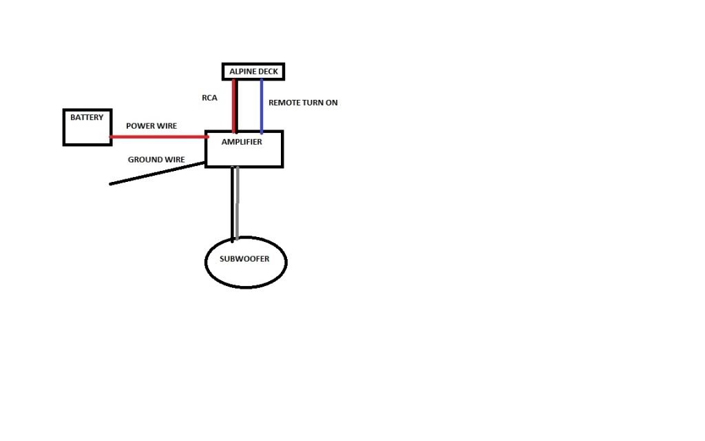

    I drew you a diagram. look at it.

    ya that makes perfect sense. i just gotta actually see it to be able to do it lol. im gonna take apart the dash tonite prolly and run the wires and set the sub and amp in places n tack it all down =D

    The diagram I drew is pretty generic. Don't forget to put in a fuse between the AMP and the battery. For the amp ground, You can use any part of the car frame for the ground. There should be plenty of grounds under the seat or behind the rear seats.
