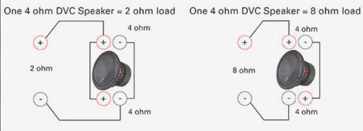

    Ok so JL audio likes to run at a 3 ohm load, and JL is pretty much the only one that runs at that load also, so with that saying... if you want to buy a JL audio sub, they are best paired with JL audio amps.
    Now... as far as finding the proper ohm load for a sub... that will depend on what sub(s) you get. Also the ohm load will determine how they will be wired.
    Example: this is a single 4 ohm dual voice(DV) coil sub wiring (they also make single voice coil subs(SV), and 2 ohm load subs)
    This is 2 4 ohm dual voice coil sub wiring
    So you can see that wiring does make a difference. SV and DV subs are wired specifically for the amp to run enough power.
    a kicker cx 1200.1 can run 1200w RMS @ 2 ohms, 600w RMS @ 4 ohms, and it doesnt say its 1ohm stable but i watched someone dyno the amp and it ran at just over 1500w RMS @ 1 ohm!
