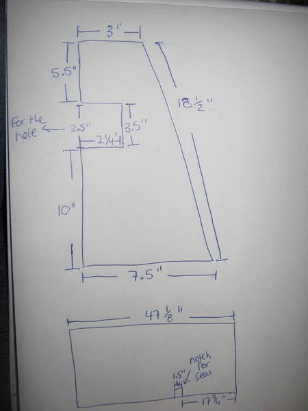

    heres mine: just finished building it today.. took me about 3 days.. 6 hours each day and with the help of my boyfriends little brother lol.
    dimensions:

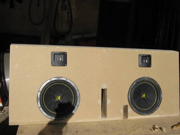

    Two notches- one for the "port hole" or air release and the one farthest right is a notch for the seat.

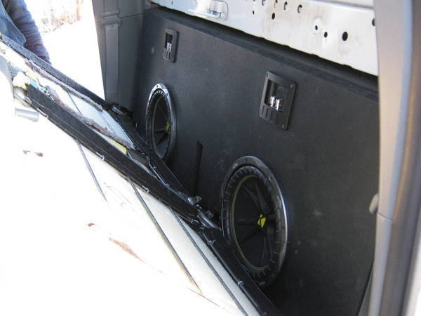

    Finished product. My word of advice is to not do what I did and forget to measure where the seat bracket is when you are going to cut out the subwoofer holes.. as you can see my sub is very close to it and it was hard to get the bolt back on to the seat.
    If you move the subwoofer over an inch or 2 it will clear that middle bracket (right where the notch is) and you won't have to take your seats out to install the box.
    Hope you understand what I meant. Also always check to make sure your sub box fits properly before glueing pieces together. Hope this helps!
    PS sorry about my dimsension writing.. using fractions and decimals.
