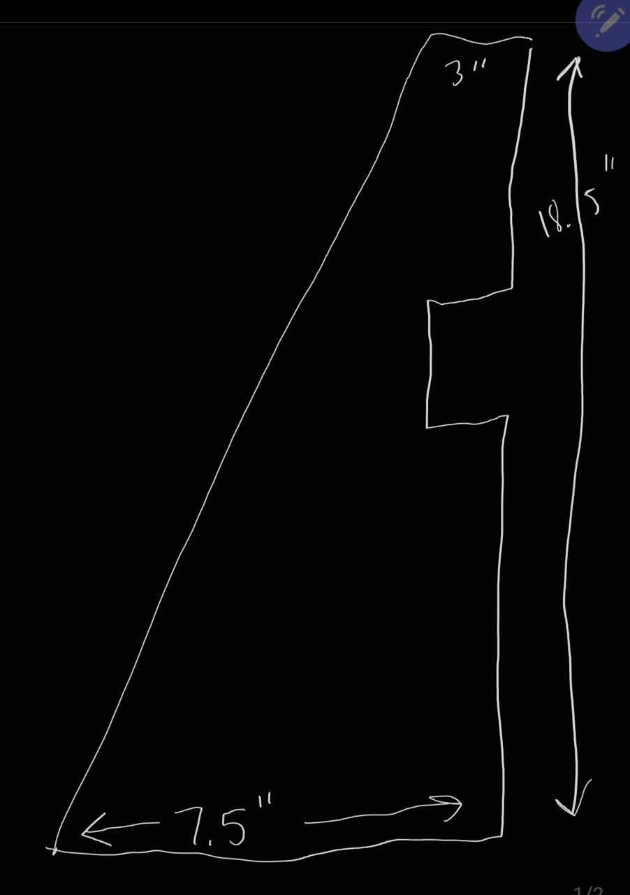

    So I just installed a JL audio 10w1v3 in a sealed box behind the rear drivers side seat in my double cab. The sub is being powered by a jl audio jd250/1 and is spec'd for .55 cubic feet in a sealed box. Attached is a *rough* drawing of my box which came out around.57cuft. The sub isn't very clean with punchy rock bass... it almost has a flap/ vibrations noise when it hits. My question is, should I be looking at the geometry of the box or stuffing it with something to clean up the hit?

    What did you build the box out of?
    If it's a sealed box, any leak will make noise.
    Generally, it's a good idea to staple or glue some insulation to the walls of the box to help damp any vibration.
    Could the subwoofer be hitting something, like the back of your seat?

    ⅝ mdf . It's got a ring around the sub preventing the cone to travel beyond the ring and contact anything

    So, the ring sticks out beyond the (foam or rubber) surround?
    5/8 seems flimsy to me, but IDK what's typical in car subs.
    I would suggest taking the box out of the truck and playing it to see if it still makes the same noises. Then, you can feel the panels to see if they are vibrating excessively.
    It's possible that the panels of the car are just vibrating due to the SPL. If that's the case, you'd need to damp the truck with Dynamat or something similar.

    5/8 is fine for anything under about 700W RMS; normally, I[d recommend additional bracing and damping fill, but he has a minuscule enclosure

    I would think it would be based on cabinet size more than wattage.:notsure:
    My home speakers are only rated for 300 watts rms, and are 3/4 or 1" MDF. But, they're larger and produce more bass than anything most people would ever put in a car. :D

    FTR you should not ever be using something to physically clip the mechanical extension of a cone. For sound quality, the driver should be recessed behind the enclosure based on maximum extension of the cone, but that doesn't seem to be your goal. I would very much reconsider a vented design, then refocus on setting the SPL to the correct level.

    I mean, thicker is always better. You just don't want transmission obviously, so you're right that a smaller enclosure would suggest thicker walls

    Don't you mean that a smaller enclosure would suggest thinner walls?

    No. You have more force pressing on a smaller area (greater PSI), so you want thicker walls to resist that motion, and therefore resonance and distortion.
    This is all considering a sealed design, of course

    Ah. I would think a larger panel would be more likely to vibrate, unless there is internal bracing. I get what you're saying, though.

    Ya I mean without modal resonance modeling, it would be impossible to say for certain which walls should be braced further (I'd assume the back wall should be the thickest in most cases), but in a spherical enclosure, smaller should theoretically be thicker
