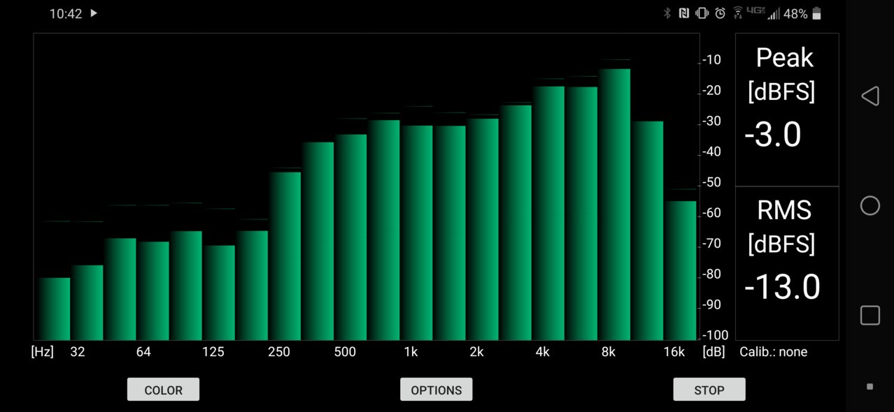

    Ok, so plugging that in: V = sqrt(P*R) => V = sqrt(300W * 2ohm) = 24.5V (RMS)
    1. set the multimeter to AC volts
    2. disconnect all speakers & sub (leave amp connected)
    3. find a tone generator and set it to 100Hz and start playing it on your head unit
    4. turn volume to max on head unit
    5. probe the speaker outputs on your amp
    6. adjust gain until the outputs reach about 24.0V*
    If you're running in a bridged mode or anything, make sure to take that into account
    7. Turn the volume down a little so you don't blow your brains out
    8. Reconnect the sub to the terminals you were just probing
    9. Play the same test tone and Report back
    *Note that this is a no-load measurement. Loaded will drop voltage, but drivers are rounded up, so 2 ohm might actually be something like 1.8ohm, so the two effects cancel each other and a safety margin is probably about 0.5V under the calculated value: 24.0V

    I just downloaded this, might work for ya. Allegedly 100HZ but I'm on a laptop so..can't really hear it.
    An app is probably easiest though.
    BTW also make sure your source (phone, CD, USB, etc) is at max volume when you do this as well.
