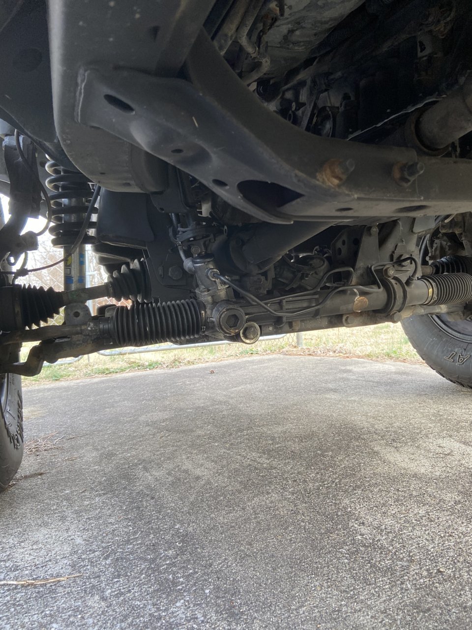

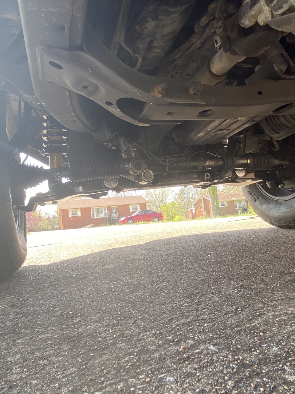

    I called a Toyota dealership in PA to get the crossmember but he said you can’t get a welded one without getting a frame. So now I’m back to getting one fabbed. Good news is I found a shop that will take me but they can’t get me in until April 13. These are photos of the underside. Most of the crossmember is still there they just removed enough for the diff to come down. It’s hard to tell where it’s cut from the photos, especially on the driver side because it’s hiding.I think I’ll be in decent shape in the end but boy am I tired of this drawing out. In the meantime I’m gonna get my CVs done as the passenger is spitting grease.

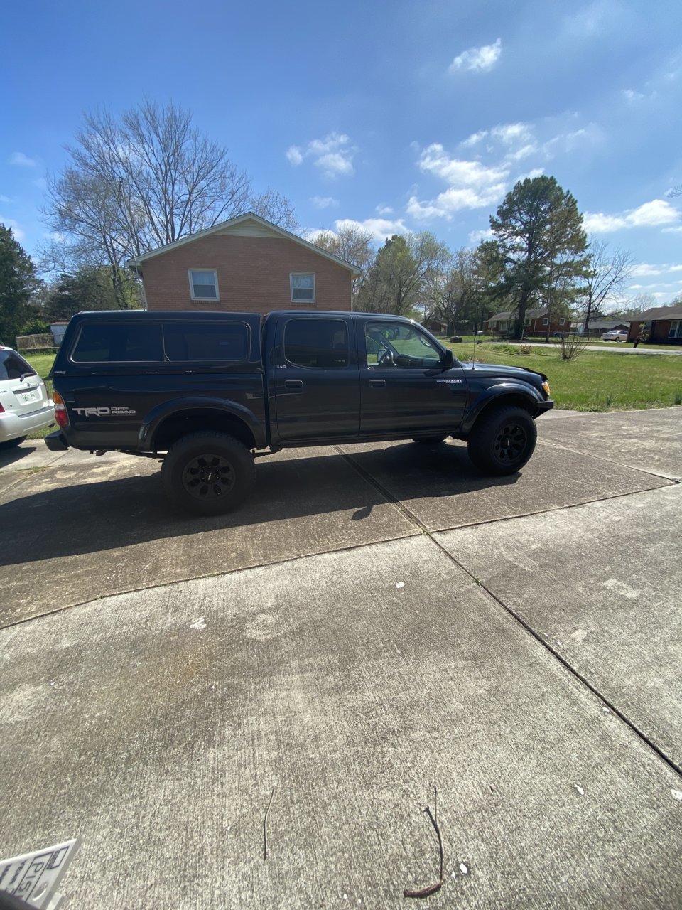

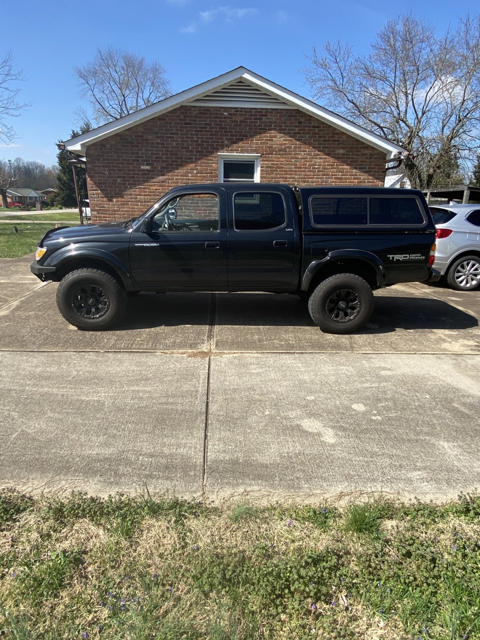

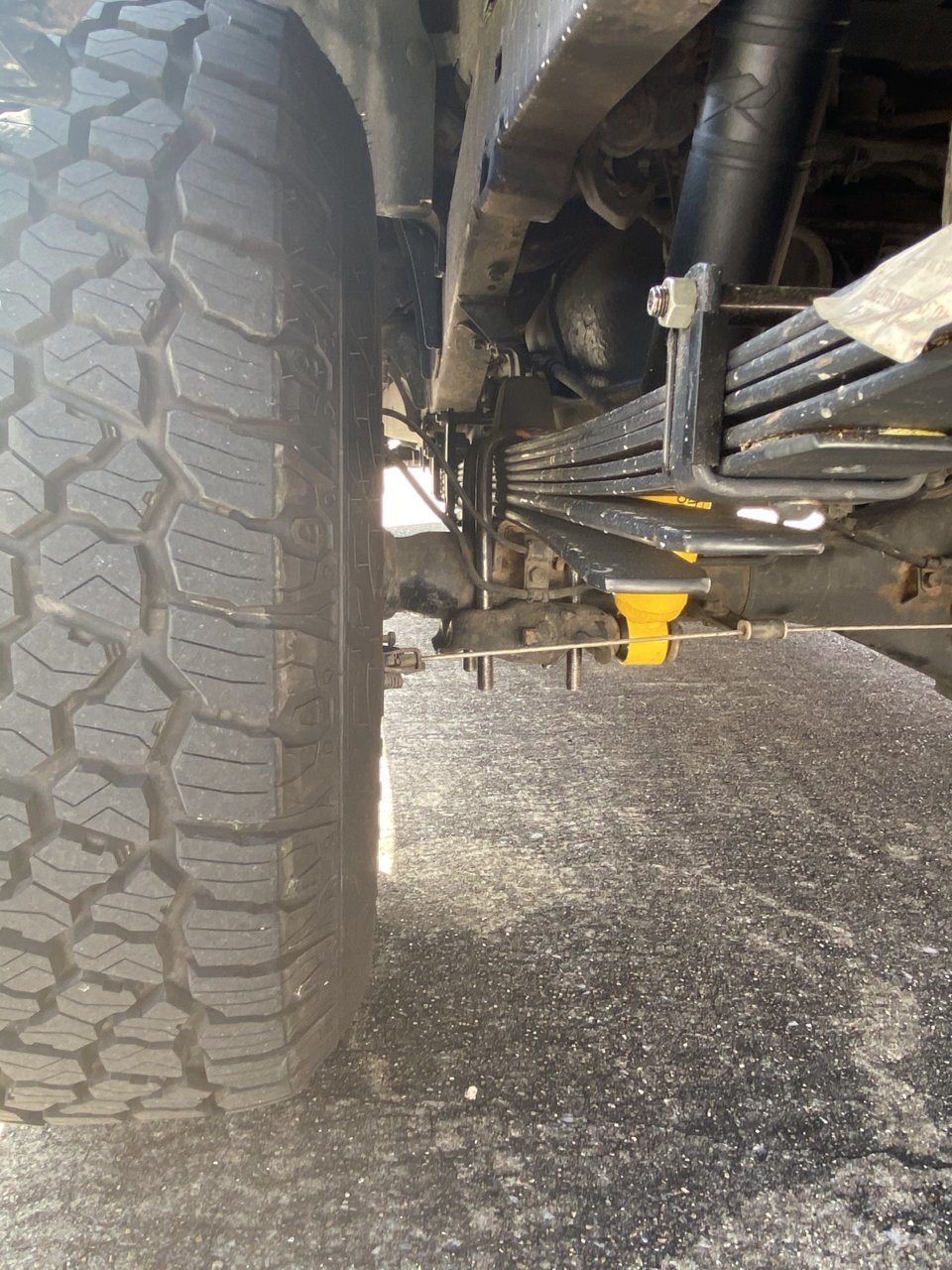

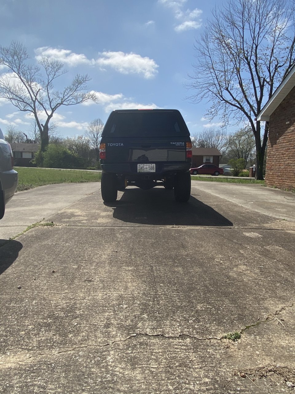

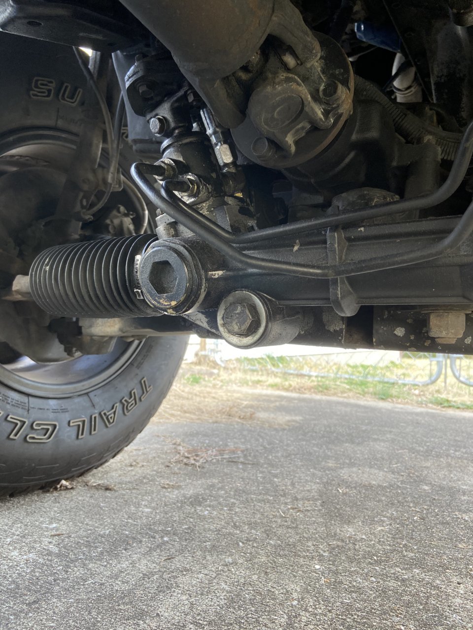

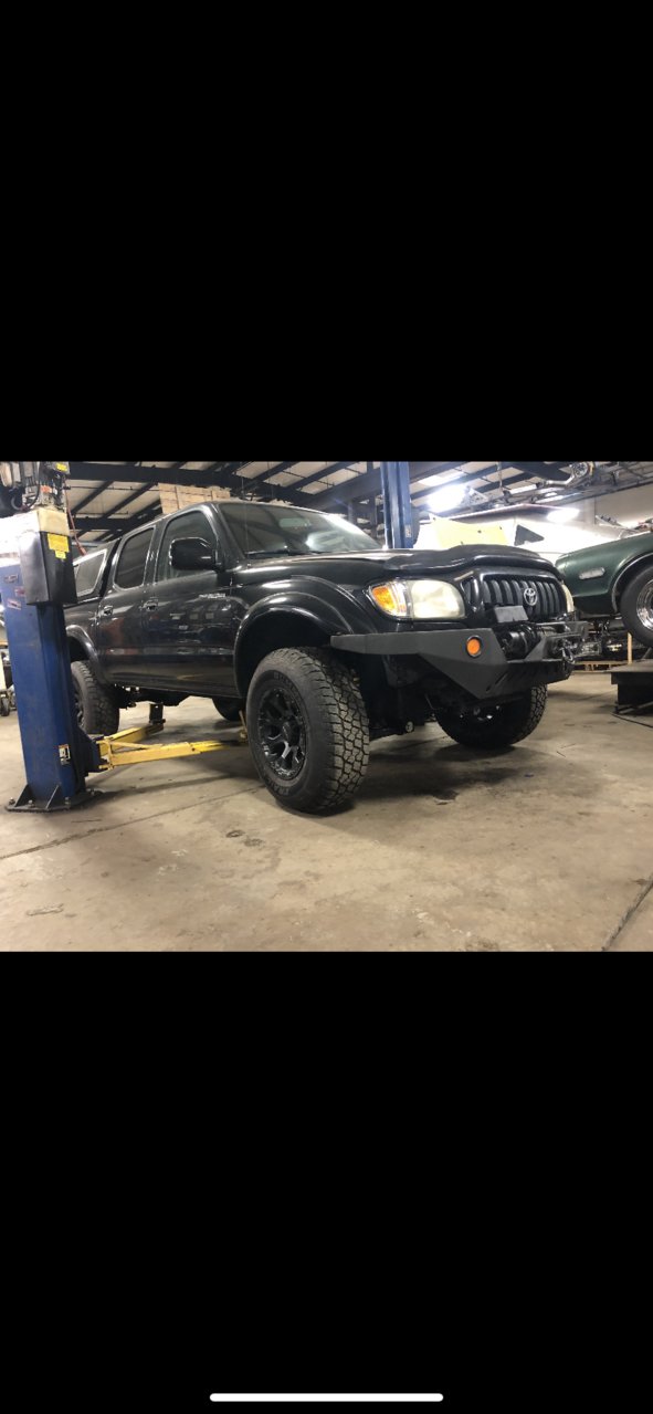

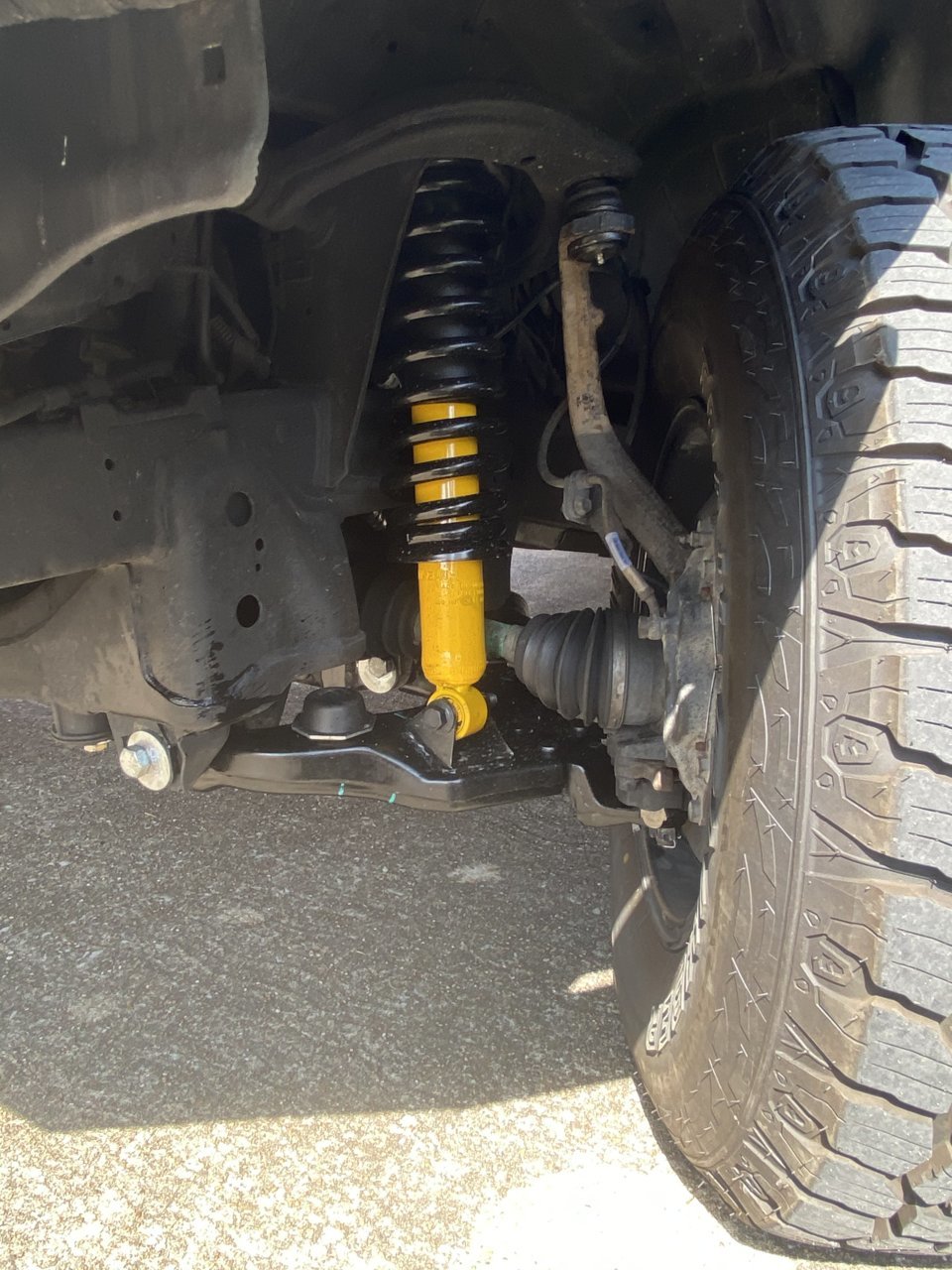

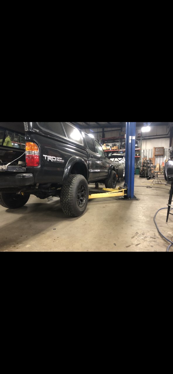

    I just picked the truck up and wobbled her home. After everything I ended up with new leafs, new coils, new shocks front and back, new lower control arms, exhaust redirect, old lift delete, diff raised back up, crossmember gabbed for steering rack, new components installed and a bill 2x what I wanted lol. Obviously I need an alignment something fierce but the geometry and suspension feel really good. It’s very tight and solid but not stiff or jarring. I still need a sway bar but I’m happy with the work. It’s not done though... here are some photos after we got home. One thing I noticed is that the rear is a bit leany to the driver side but I believe that’s probably due to my driveway as I checked and the leafs are on the proper side. Next on the list is alignment, sway bar, wheels, tires, better looking bumper and oh! I just realized I forgot to mention I found a matching camper shell the other day so I jumped on it. The one in the photo goes to a Colorado and will come off to be replaced. Everyone please lend me input on if everything looks to be in order or if you notice anything that needs to be at the top of the list. CB187446-E3F7-413A-9856-4F53AD58B373.jpgED790726-EF54-4407-A1F6-E0224909DECF.jpg4CF806A6-52C0-4C04-A36B-54A890309071.jpgC660BCE1-52EF-4603-A51B-EDC466C34889.jpg9D71EB8E-64A7-4CA9-B58E-D30F3686ABC7.jpgEF2A9517-1D88-4D95-8D6F-3357016C74EC.jpg44E056EA-D07A-495C-8FC0-BD0E794252E8.jpg95C22E61-1EFA-478D-B791-CA45527C999F.jpg

  14. Mar 25, 2020 at 3:59 PM
    #34
    Sogoku19
    Sogoku19 [OP] Well-Known Member
    Mar 12, 2019
    #286359
    158
    03 Tacoma (black)
    Also if anyone knows a good location or internet link to order a front sway bar I’d appreciate it so I can start looking at prices. Forgot to include that this is the OME 881 coils with 265 75 r16.

    Not as relevant now that you've had other people look at it, but you definitely CAN get the sub frame assemblies that are welded in place. For the 1995-2004 Tacoma, all of them have part numbers and are orderable. The only pieces you can't get, more or less, are the side frame rails. For 2005-2020 Tacomas there are a few Toyota no longer sells separately.
    1995-2004:
    51202-04010 is the sub frame for 4WD and Pre-Runner trucks.
    51202-35330 is the sub frame for 2WD 5-lug trucks.
