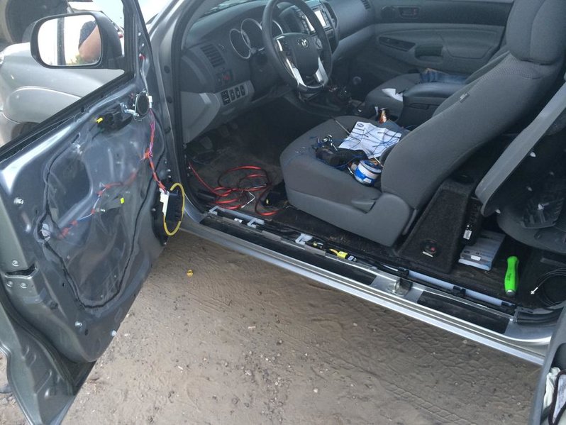

    Well I have a high low converter wired in behind head unit and nothing. I tried wiring into speakers too but same result. Tested amp and subs they work but no signal from stereo.... Is their any way i can use the high low converter or do I need a different product in order to get signal to my subs? This is they only pic I have of when I installed it and it didn't work.... Not the same of the last car I wired that's for sure.

    Are the gains on the line out converter all the way down?

    What is the make/model of the converter you are using?
