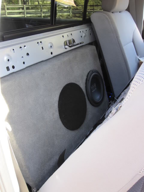

    I did 1 8" polk sub in mine. Don't know how much bass you want, but mine sounds awesome. I would do 2 8" subs if I were you... Heres my box
