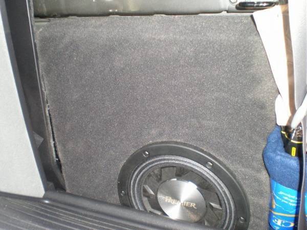

    Hey jason awesome sub choice i have the 10" in my truck and it pushes hard, two 10's would be nice the amp im pushing it with is a rockford fosgate 300-1 i couldnt be happier with the outcome

    Amp is under the driver seat clears no problem its alot of bass for one sub theres a guy i met had 3 subs and said my one sub sounded better deeper bass

    thanks for the pics!
