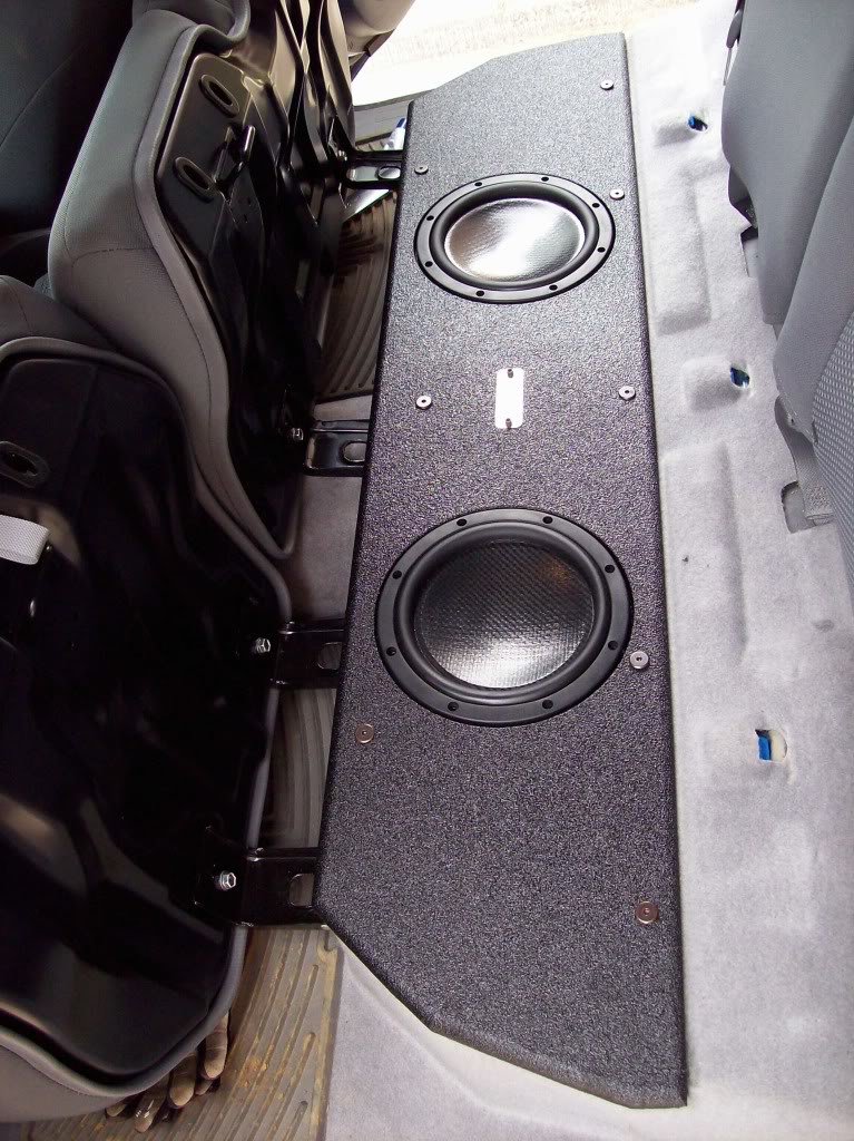

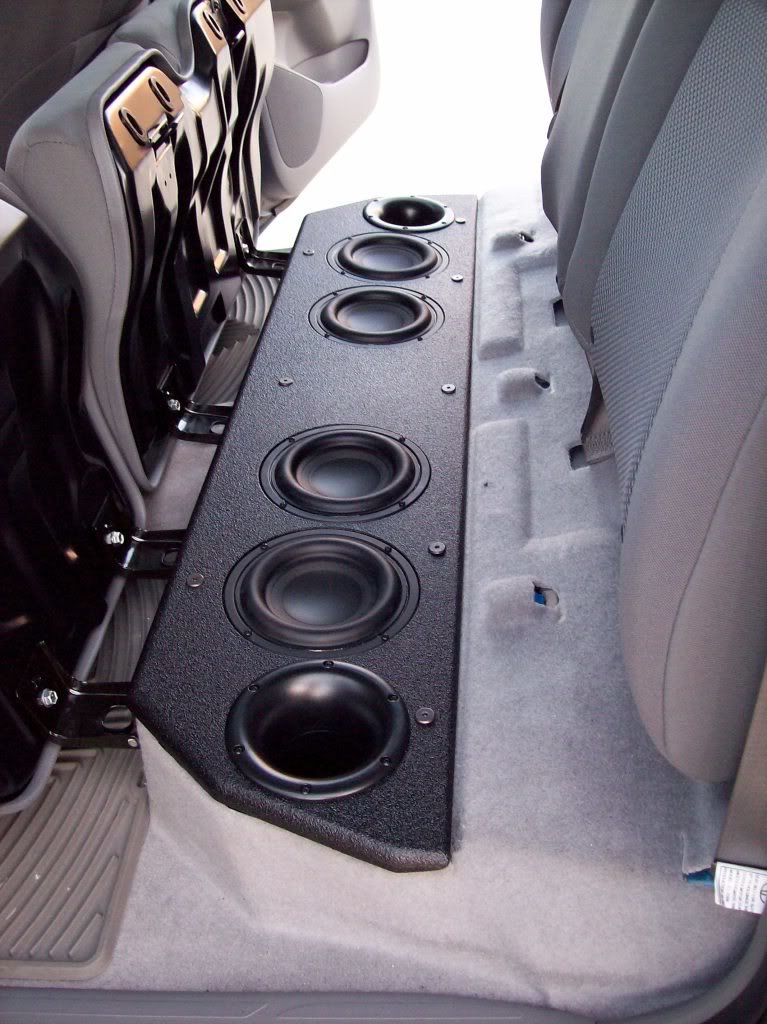

    How much depth is there? And since I am fairly new to car audio please explain what your an by one motor structure and why it will be easier for me?
    What is the set up in that pic?
  14. Apr 4, 2013 at 9:25 PM
    ItalynStylion
    ItalynStylion Sounds Gooooood
    Jun 15, 2009
    #18467
    5,127
    Steven
    DFW, Tx.
    09 Double Cab TRD Sport 4x4
    The motor structure is the magnet on the back of a speaker. It makes the cone move. In my last picture I had two speakers per side (the side is divided by the hump in the middle where the driveshaft goes). So it was tricky to get the 3" pipe tube in there without hitting the magnets of two speakers.
    In your case, if you're using 1 sub per side you'll have more room so it will probably be easier. And I can't remember how much depth there is. I think someone tried Alpine Type R's down there (8" version) and those are 4.5" deep so there should be at least that down there. You should be fine.
