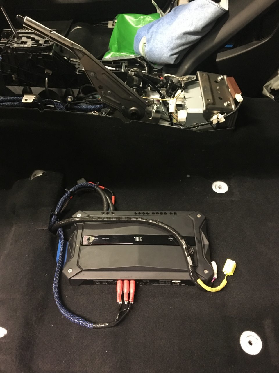

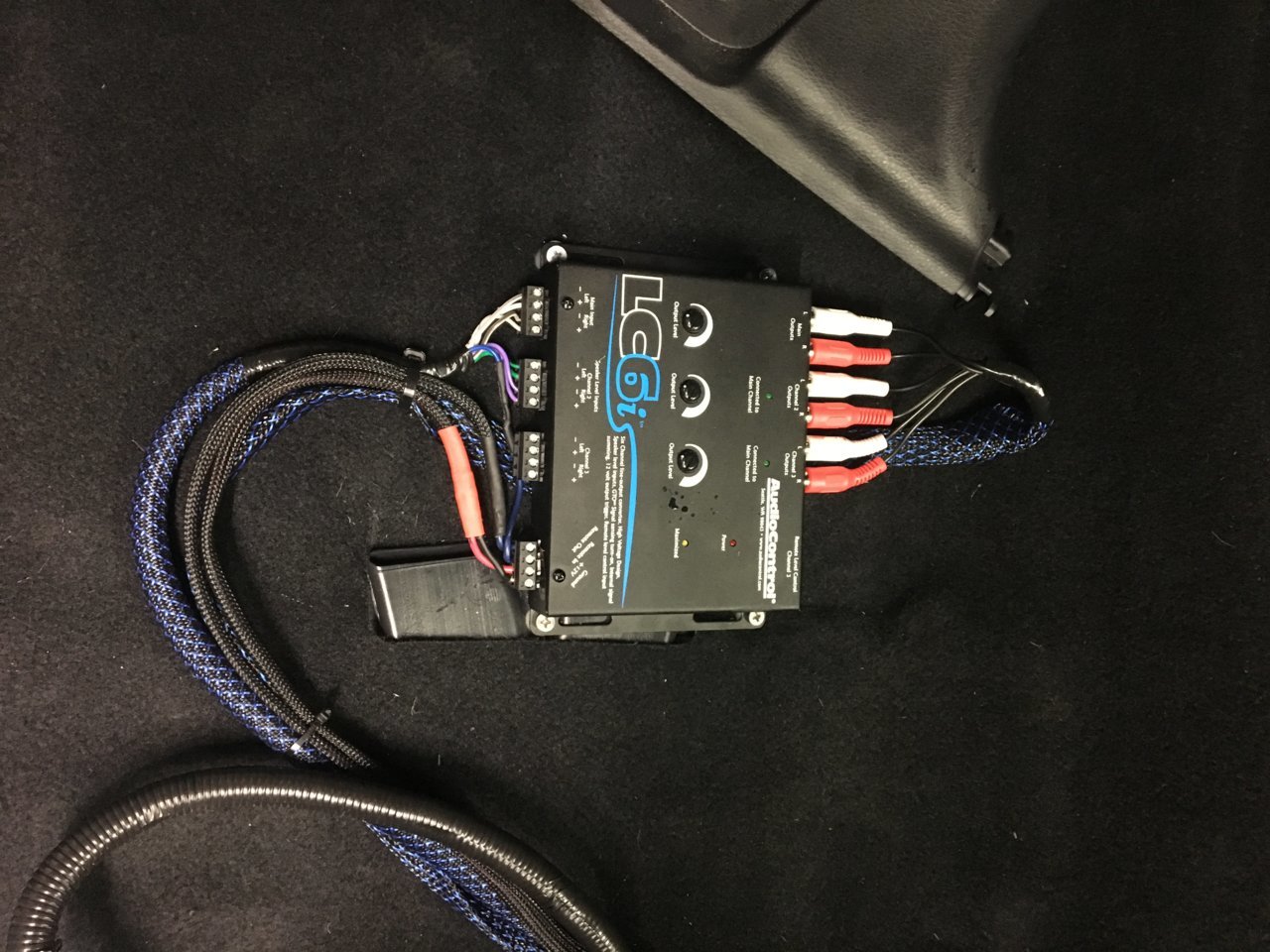

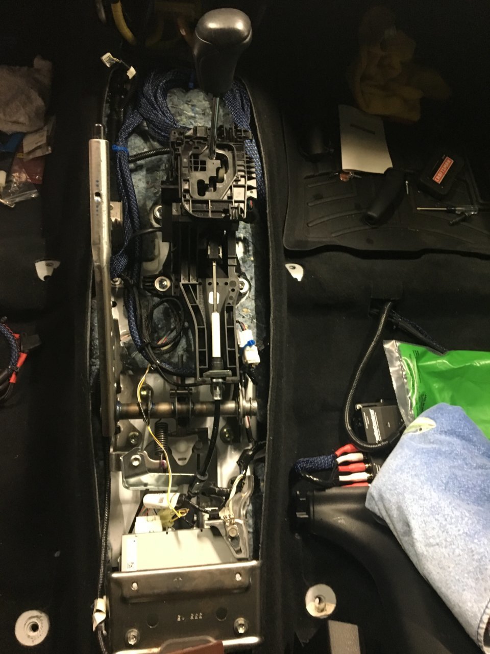

    54916056440__F6F05C9D-4FAD-4527-BF06-4008F95D0987.jpg 54916053107__8B4E4484-7A9F-43D7-94BF-4C13B18B5538.jpg 54916053659__7CB25AFE-3C01-48BC-B088-89ED422A4756.jpg IMG_1761.jpg IMG_1763.jpg
    Line out converter under passenger seat, amp under driver seat, wires run under the center console and door jambs. Did the same thing as above for amp 4 gauge power wire.
