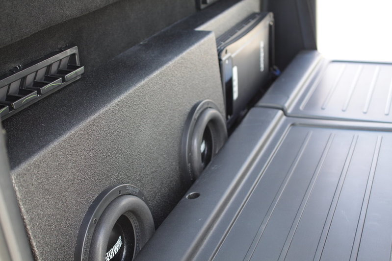

    I'll post mine up. Have this on it's own thread, but since he asked. Two Sundown 8's sealed with Audison Amp. Fit-up is tight in the 2016's. The vent in the rear wall get in the way of going all the way up.

    Clean rig! Is that the SA8? Care to offer your opinion on it? I'm torn between a single SA8, SD10 and E8 for my next enclosure.

    No its the SD 8. Opinion is hands down the best sub I have ever owned. I was actually a bit surprised. Running the pair with the Audison Voce amp. Very clean 1000W which is quite a bit over their RMS rating (300 WRMS). I talked with Sundown and got a response back saying not an issue to push them over RMS. When we tuned it and set the gains the amp is actually pushing more like 1.2K. Subs literally don't care. Been running them for about three months, pushing them hard, and not a single issue. So for less than $400 for the pair they would be pretty hard to beat.

    Aha! The surround fooled me. I forget the inverted surround is a new thing.
    That's a solid endorsement I'd say. Thanks for the review. Yeah, I've run across a few articles where Jacob (of Sundown) mentions RMS power is very conservative. You clamping for your numbers?
