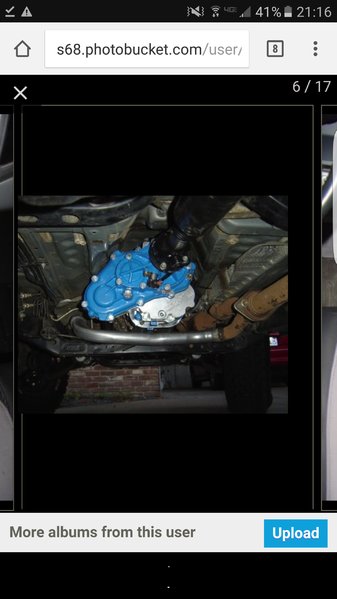

    Bought some exhaust pieces, going to reroute like this one[​IMG] in the same location, just an inch or so higher

    Go further behind the t-case and much higher. Rotate the Y and it makes it easier to gain the height

    But I only need it to be even with the bottom of the cross member right? And it follows the same path just tucked up a bit... It looked really difficult to get it back to the stock y after going around the back of the t case

    And how do you rotate the y? It looked a little complicated...I feel like mine is different than all the photos I've seen

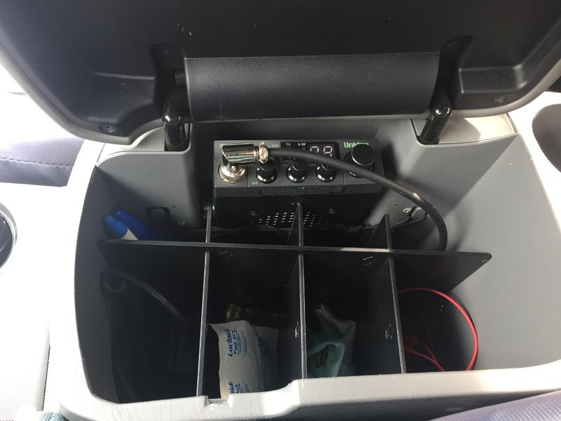

    Did you guys cut a hole in the bottom of the console to clear the antenna coax?

    I did. Tried to trim the little felt pad at the bottom to cover the hole as much as I could.
    Ryan, what size hole did you drill to make that extension go to the outside?

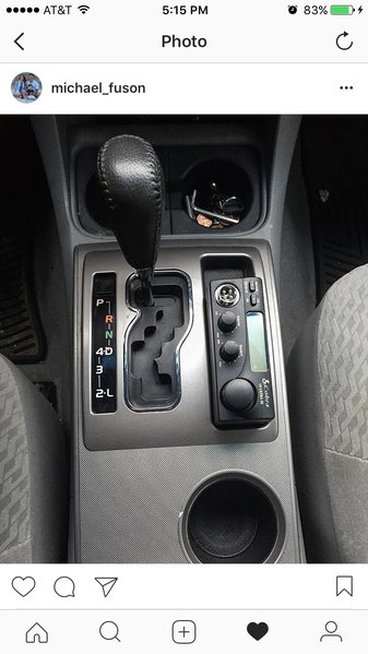

    Also, @Subway4X4 i found this good idea.

    Yes I drilled a few holes at the bottom of the console, and I folded the carpet up against the radio. To make the hole I think I used a half inch, just check what size the fitting is

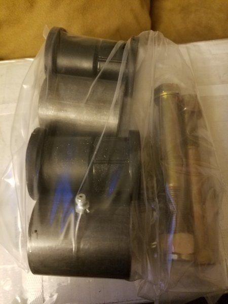

    Let the shackle flipping begin!

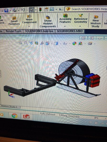

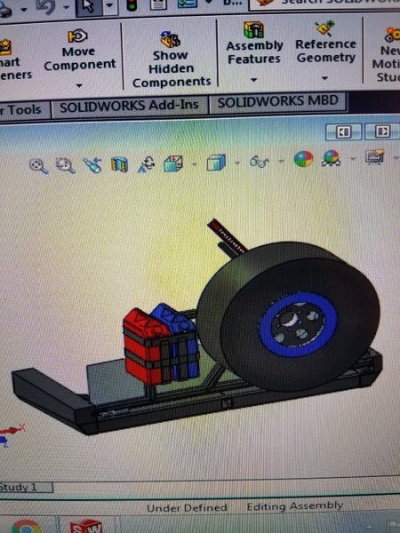

    Everything is drawn up for the most part. Still a few things to figure out. Any thoughts good or bad?

    Looks great. You have gussets planned to add support for the bearing for the swing out I assume?

    The way I have it, it goes all the way through and is welded in at least 2 places...think it needs more?

    That upper corner of the swingout that's holding up the twin fuel can holder might have to be gusseted.

    I can run another diagonal square tube

    That'll work. It will intersect with the other diagonal tube coming from the tire carrier assembly.
    You have a 2" receiver in the bumper?

    Yea
