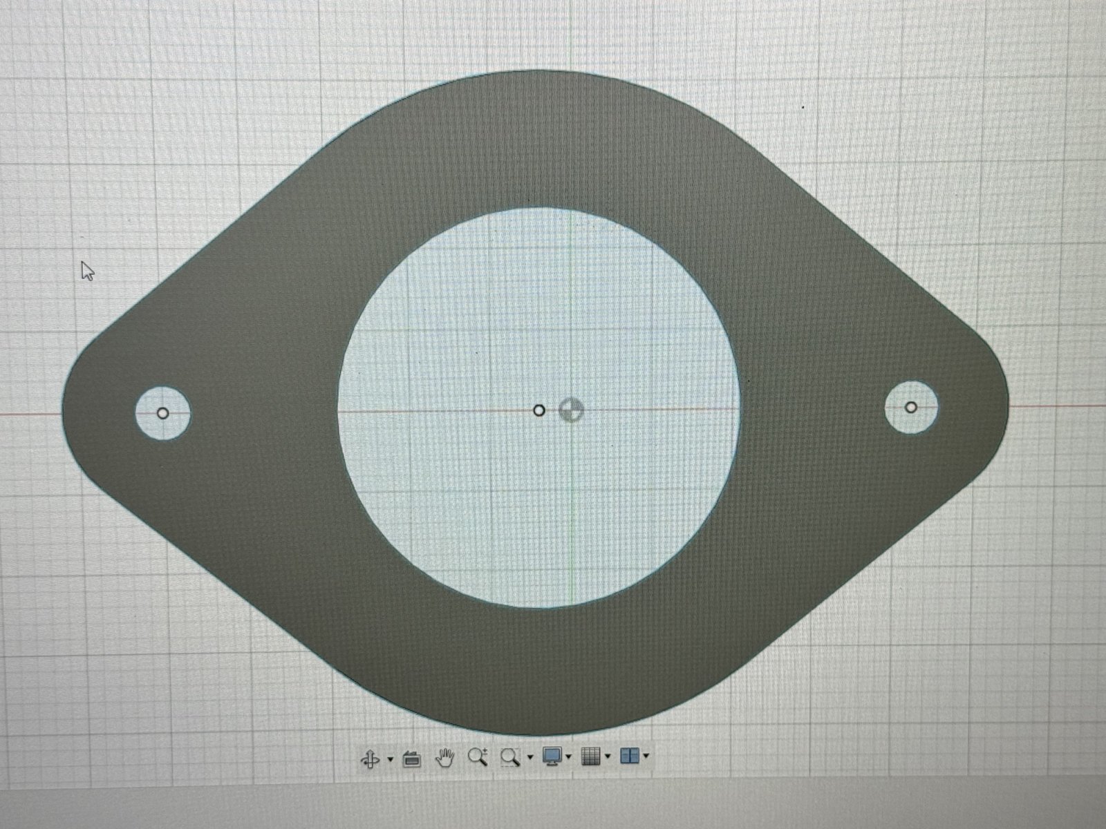

    Just drew up a flange to do just that. Will be 3/8” 304 tapped for factory hardware. So there will be a secondary “mid pipe” to adapt from the y pipe to a factory style “cat back” in either 2.5 or 3”
    It just makes more sense to have things “boost ready”. We all know the whole “I’m not doing that” then 2 years later you do exactly that.
