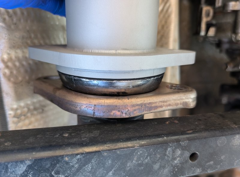

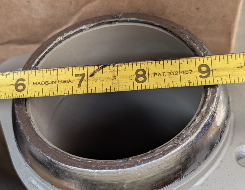

    Fwiw, I'd probably wait for @906taco to produce a true 3" system. Cory and I discussed that there's a difference on the ball flange aka bell mouth end.. it basically steps down to fit the 2.5 donut gasket. Will be modding my exhaust to fit the 3" intermediate pipe

    Thanks for your reply. I had looked into URD’s 3” system, and like you said it steps down at the flange to bolt up to stock 2 1/2” size.
    I had spoken to Cory about it, and he suggested I buy the 2 1/5” mid-pipe for now to bolt up to what I have, and at a later date move to a 3” mid-pipe when he’s ready to offer a 3” system.

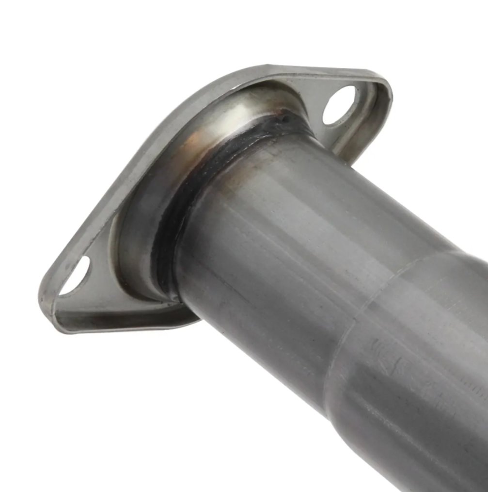

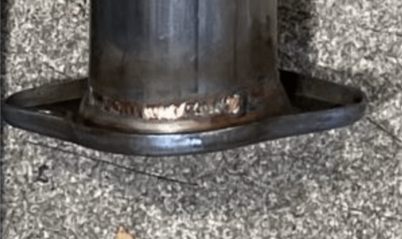

    Agreed and you're on the right path! Thanks for taking it in and offering a solution. I just wanted to give people a visual to match with what the OEM flanges offers and why it'll be important to either go with a quality kit from you or plan to modify. Unfortunately, I think it's just an "us" problem that decided on the 3". Located 3" bell mouth flanges, just got to see if I have any 3" pipe to weld to my muffler at this point.
    The mark4 looks true 3" as advertised. But the stepdown is from the y-pipe/intermediate pipe. If what the listing is true that it fits the OEM flanges, then it was made for the 2.5" donut gasket. I think on their previous system, mark 3, the piping and flanges were solely for the y pipe mated to exhaust as full Y-to-catback. Maybe and a big maybe is the bell mouth flange on an aftermarket is wide enough that it accommodates a true 3 exit on the Y.
