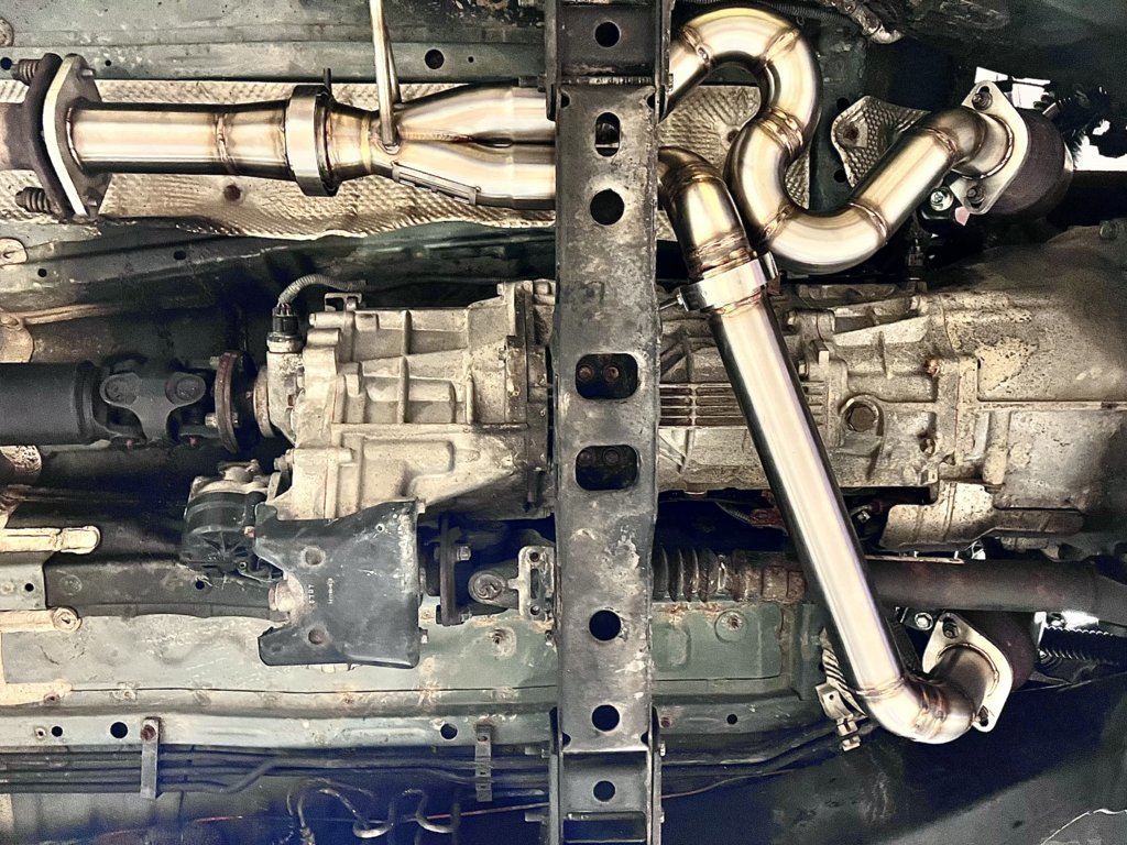

    @TWTaco, yeah, 3rd gen with glass just looks right. My truck is a 2nd gen and sits flush right now on stock length controls arms with 0 offset wheels. I put a lot of miles in offroad so having the tire covered is important.

    Very nice! Did you slap new hardware in there as well?

    Hell yes! I might just use this pic on the website if you don’t mind!

    nope. Reused the nuts for the manifold and the two bolts for exhaust .

    Sure go ahead. I like how that pic turned out too

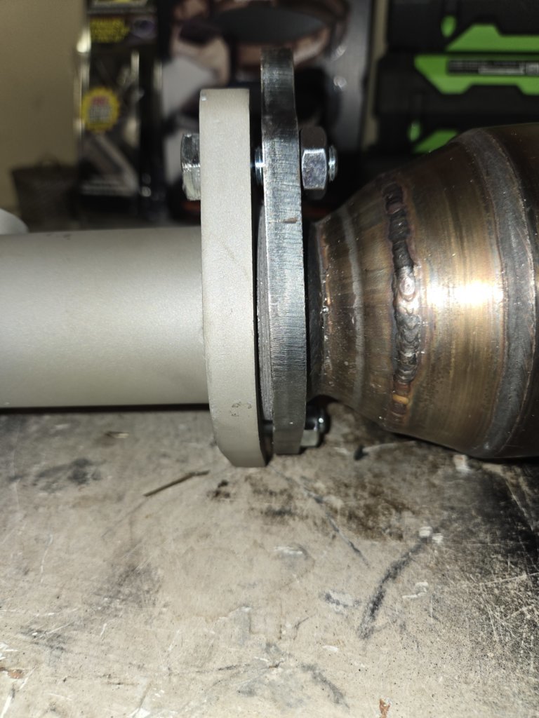

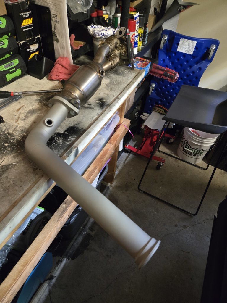

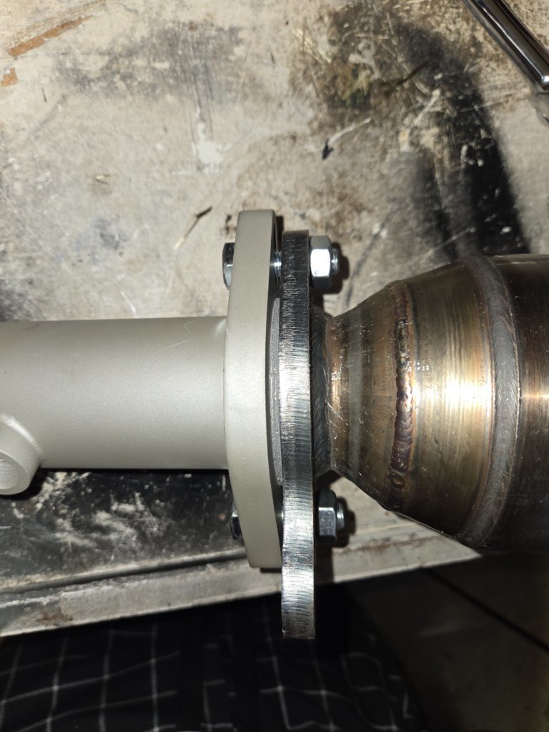

    Tried a little fit test with my AFE Twisted Steel exhaust manifold on the work bench this evening (please don't judge my wrap job, it's a work in progress). Both of these flanges combined are THICCC. I'm wondering if I should get a slightly longer bolt to compensate. I took a few pictures. I didn't torque to spec but what are y'alls thoughts? I'm slowly dragging this project out because I'm nervous about switching out the manifolds and life is pretty busy at the moment. Just seems for a lot to go 'wrong'. I may send it to a shop if the price is reasonable.

    I’d probably put a washer on one end and a lock washer on the other at which point I think you’d need another 5mm of bolt length.

    Lock nut for sure! I don't know why AFE didn't include washers in their kit. Thanks @Chris(NJ)

    I would just use 2 normal flat washers OR a flange bolt and a single washer under the nut. For the nut I would use a stover style lock nut.

    Awesome, I will definitely go this route. Thanks!

    No problem! Flange bolts are always my preferred route for an application like this. Can even get them serrated for extra grip.
