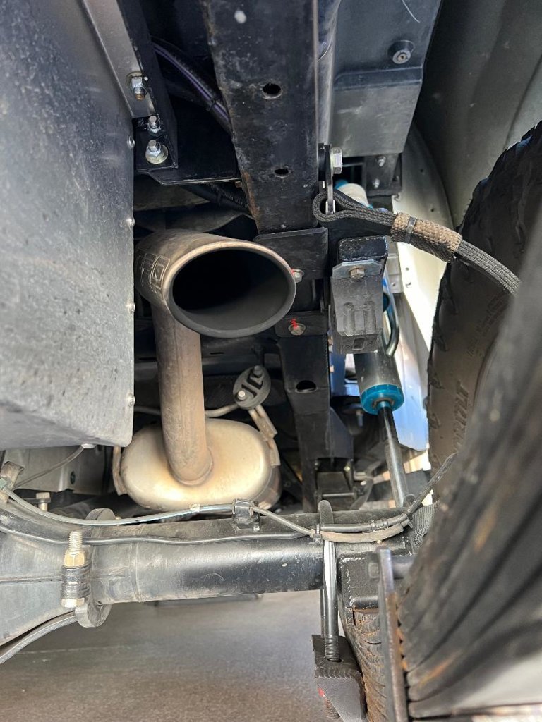

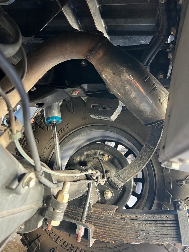

    I changed it pointing downward to keep the cabin drone down. At a side angle it gave a bit more cabin drone.

    Interestingly enough, the 3rd gen I developed the Y on had a MBRP setup that dumped before the axle. It had horrendous drone. After the Y-pipe the drone was decreased to a point you had to pay attention to find it. Not saying what I’m doing won’t cause some drone, because it’s only theory until it’s finished. But I feel fairly OK about the idea as of now.

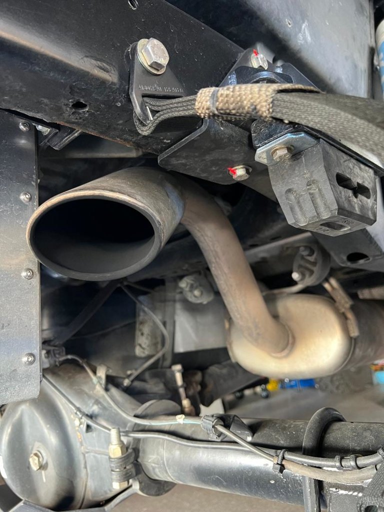

    Not saying it’s impossible. After all, I like to carry the thought anything is possible. But MBRP has had a pre axle dump exhaust for some time now.
    Raised it up a bit more and sent it! Best option that fits most!

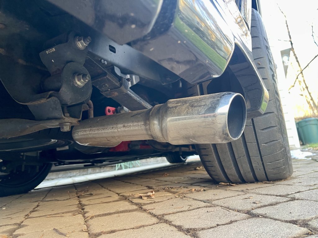

    Here’s a pic of the stock exit on my x-runner. As you can see there is a cut-out of the bodywork for the pipe. My particular tailpipe is a little low and that’s my fault for not paying enough attention when we welded on an ultraquiet resonator. My point though, is it would pretty much look like ass without some sort of pipe there. Any chance of making something that will work for us x-runner guys? :)

    I would need an X runner in front of me to make it happen. Unfortunately just the way it is. I don’t know of a single one close to me unfortunately.

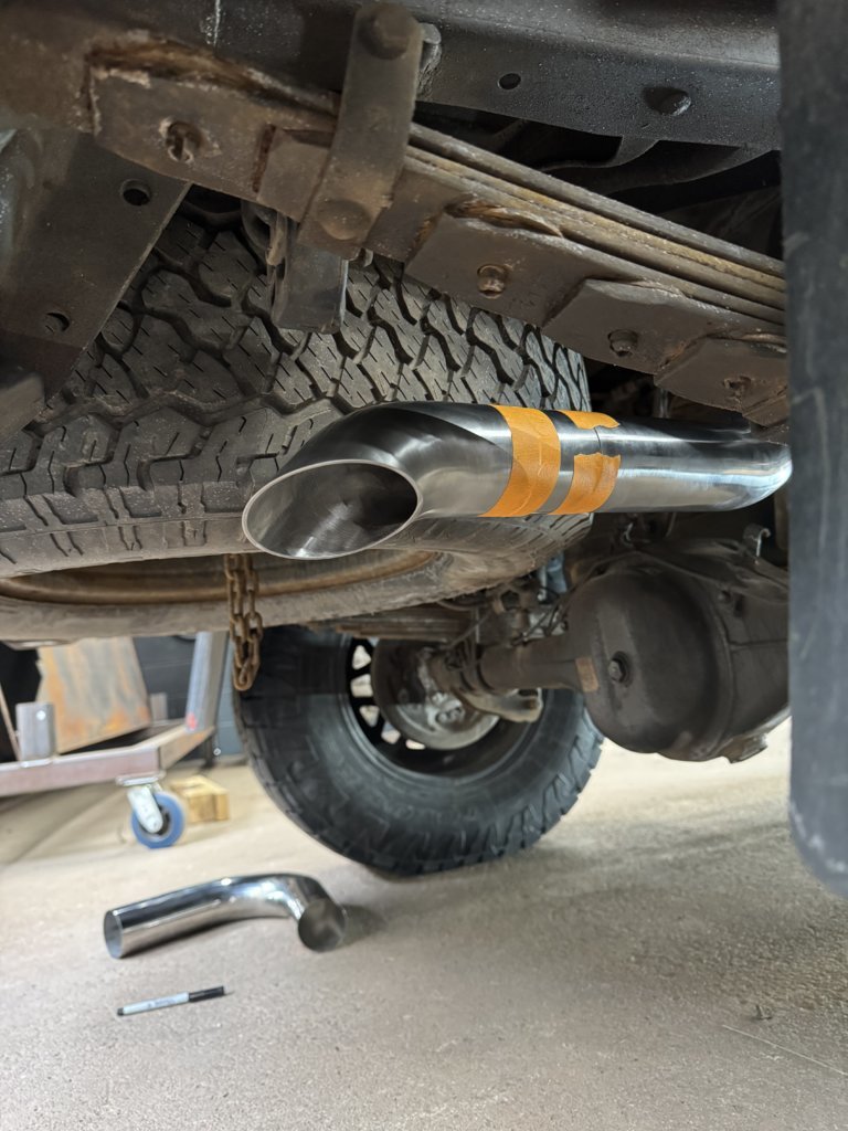

    So I think the best course of action would be to omit the tip and have a local shop bring it out the side. One bend and about a foot of tube is all it would take.
