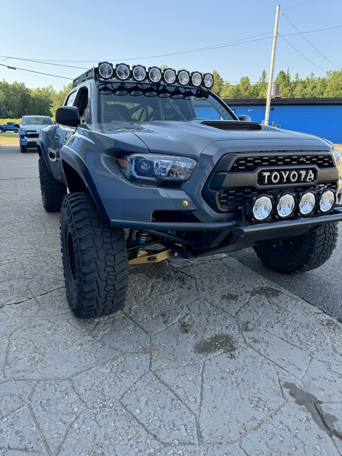

    Houston, TX
    2013 Tacoma TRD Off-Road 6MT
    TRD SC,HPTuners
    This is a 1GR ?
  5. Jul 9, 2024 at 10:24 AM
    #45
    nudavinci64
    nudavinci64 Robert @ Holy Horsepower
    Nov 14, 2013
    #116533
    10,128
    Robert
    San Mateo/Cayucos, CA
    13 S/C TRD OffRoad 4x4
    Boosted Money Pit....
    I believe he is running the 3rd gen glass kit on his 2nd gen.
  6. Jul 9, 2024 at 11:48 AM
    #46
    906taco
    906taco [OP] Well-Known Member
    Jun 22, 2021
    #369289
    3,851
    Cory
    08 Taco
    Sure is!
