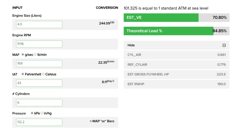

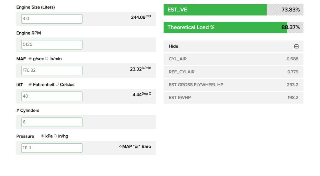

    I know this may be meaningless to many. Dynos seem to be the only way gains can be proven these days. But that is far from reality.
    We tossed the factory Y back on and did some data logging. Took a compilation of 4 pulls and found our average numbers at a set RPM.
    We then tossed on the equal length, along with my 2.5" system and did it again as similarly as humanly possible.
    Its showing about a 10HP gain up top, However we plan to do some mid range stuff as well. We feel as though that is where most of the gain is coming in. But either way, 10HP from a bolt on part for an NA engine, is pretty respectable!
    Either way, it was a cool little experiment we did. You can take it as you may!
    We hope all of you are doing well! We have lots of new fun stuff going on in the shop right now, so please excuse my absence!

    Respectable number for N/A. I’m looking forward to getting your full 3” set on my supercharged x-runner. If I wasn’t so far away from you I’d let you use my truck for research, I’m betting supercharged applications would benefit quite a bit more than a 10 peak hp gain.

    Oh absolutely! And truthfully, this truck is on 33’s with factory gearing and a couple inch lift. So realistically on a bone stock truck it is likely to be over 10hp. But I don’t really want to make claims I can fully back up, either.

    Mid range is where we notice it the most as well. Nice to hear others saying the same thing! It’s definitely noticeable in the seat. Even though many may say it’s not possible.
    Really, these engines NA start rolling over at that 5,000 mark. So to see a gain there is pretty cool!
    I have a local OTT guy that I plan to get with soon to see what can happen with a tune as well.
    Still up for Dyno stuff, however I’m fairly confident in saying the way we did these calculations is going to be accurate.
