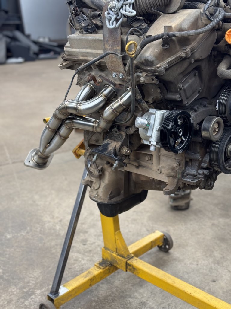

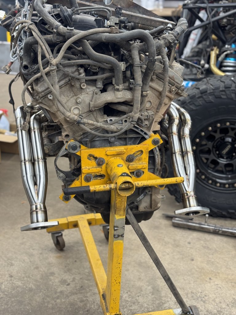

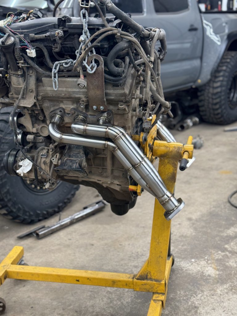

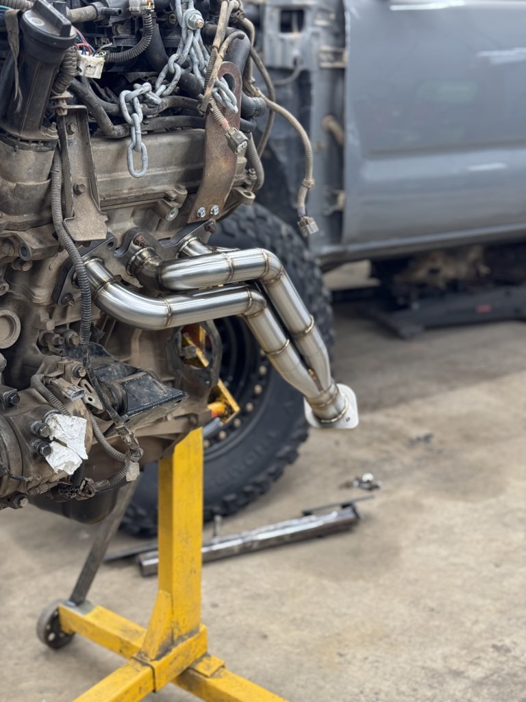

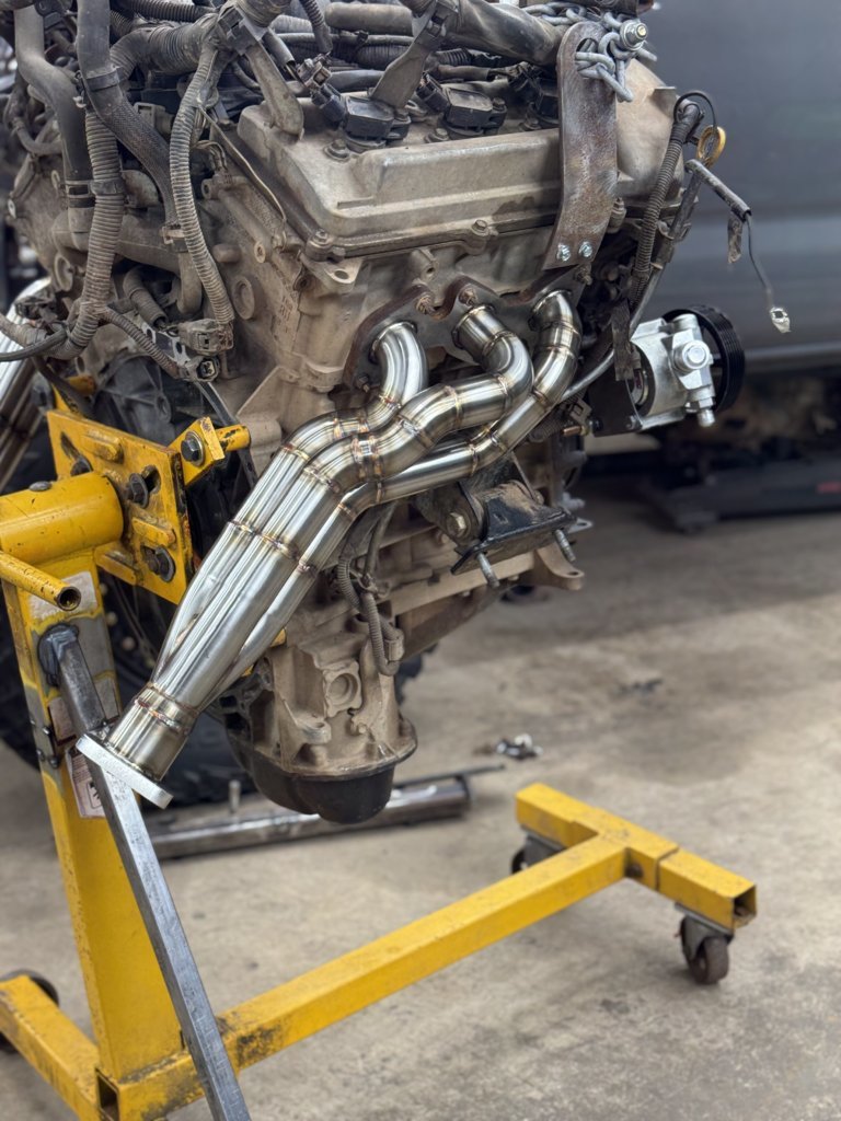

    Feels like we’ve been going non stop here lately. But I’ve been taking nights and weekends to dedicate to our own projects. So, I finally found time to wrap up the headers.

    Man, that is a great piece of machinery. Looks amazing!

    Just make sure they can clear a double shear UCA kit, looks like it shouldn't be an issue

    They clear everything in my truck very nice. Aside from having to redo my steering shaft. But that’s far from stock. Honestly doubt I’ll be reproducing these anyways.
