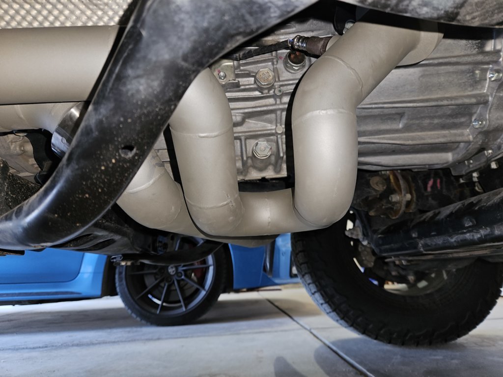

    20250830_184518.jpg 20250830_184750.jpg 20250830_111548.jpgReceived and installed the Y-Pipe on my manual transmission equipped 3RD Gen using otherwise stock exhaust system. Plenty of room around the manual transmission.
    Since I work with V-Band clamps often as an aircraft mechanic, I like to use never-seize on the V channels and studs of the clamps to ease installation and future removal or adjustments.
    I've only started it so far, doesn't sound obnoxious revving it to 4000 rpm and no CEL light. Fabrication quality of the product seems excellent!
