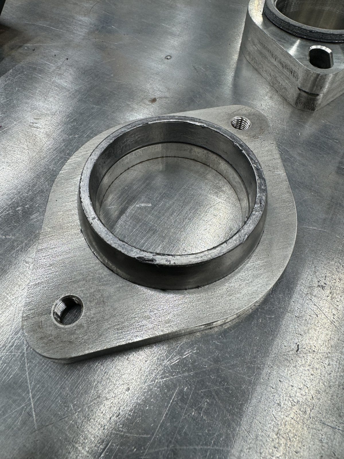

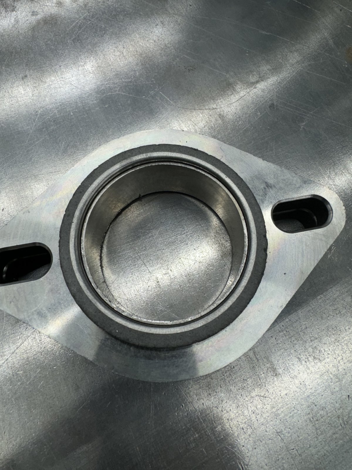

    These factory donut style gaskets are going to be a huge win! Perfect fitment and a perfect seal!
    Hours upon hours of designing and sourcing.
    Doing everything I can to make this kit a big bang!

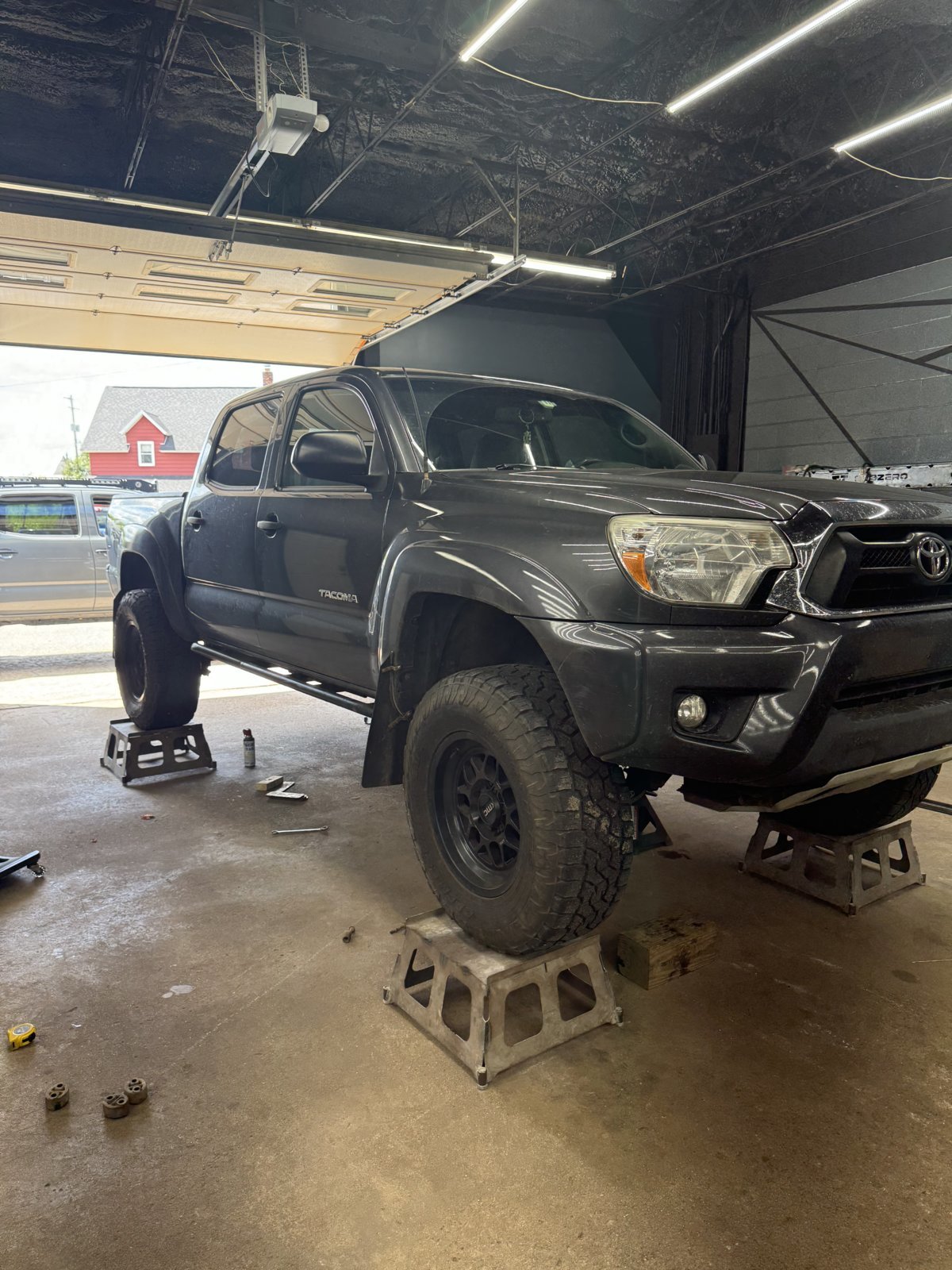

    Everything is coming together super killer for only having the truck in here for a few hours!
    Progress will be slow over the weekend as I do have shows Saturday/Sunday. But I will keep things rolling as it comes!

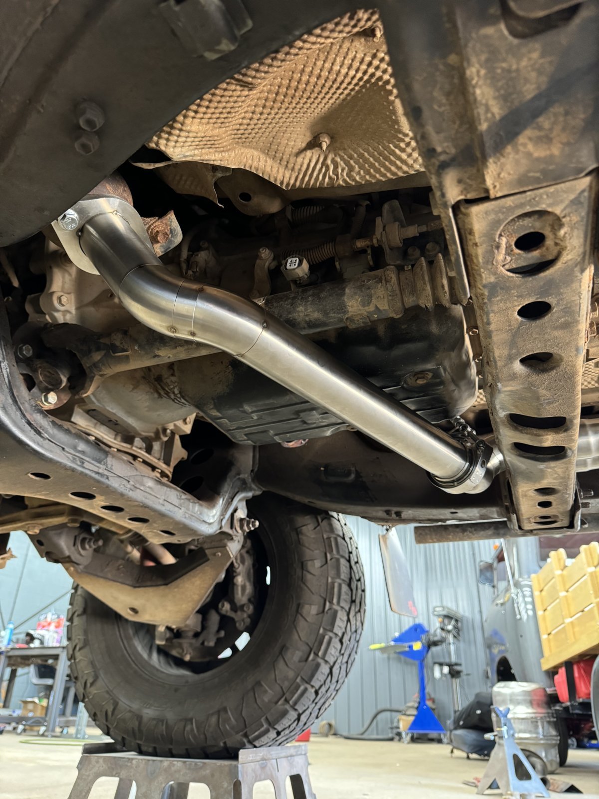

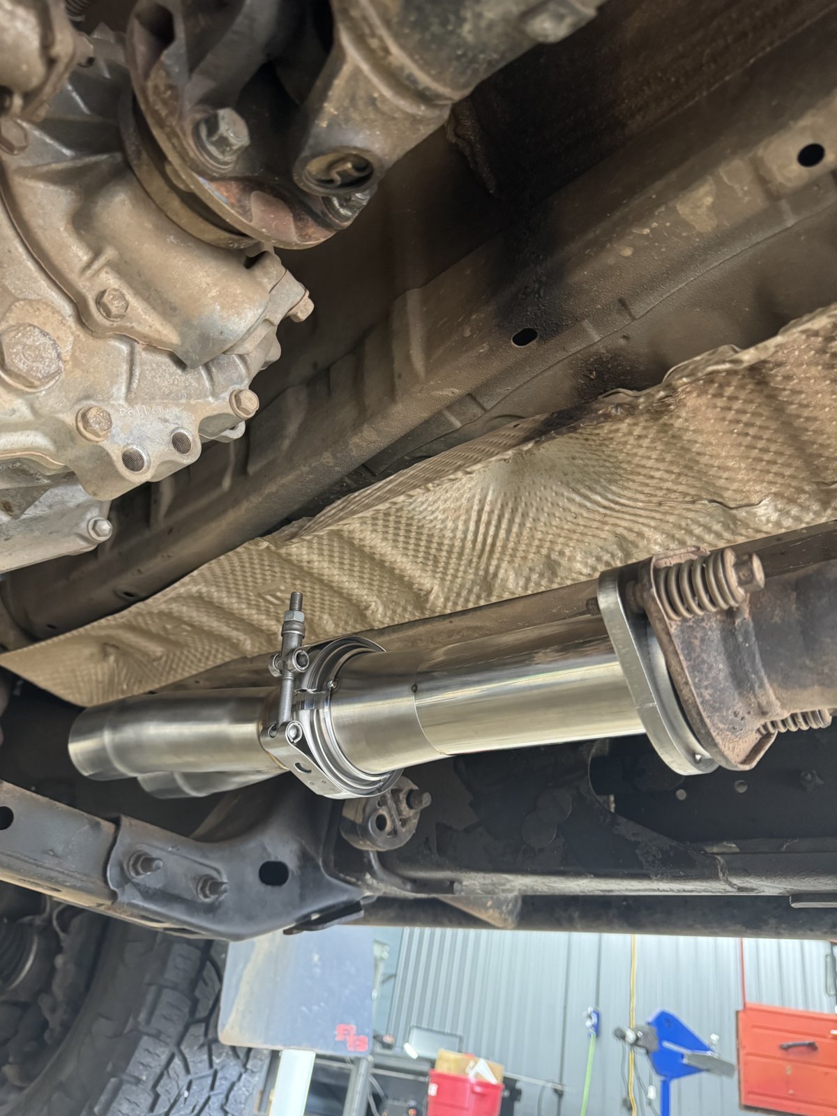

    Left cross over done! Added a V band for 3 reasons.
    1. Ability to drop driveshaft as hassle free as possible. 3 fasteners and the left side is out.
    2. Ability to drop trans pan if necessary
    3. Massive reduction in shipping and handling costs.
