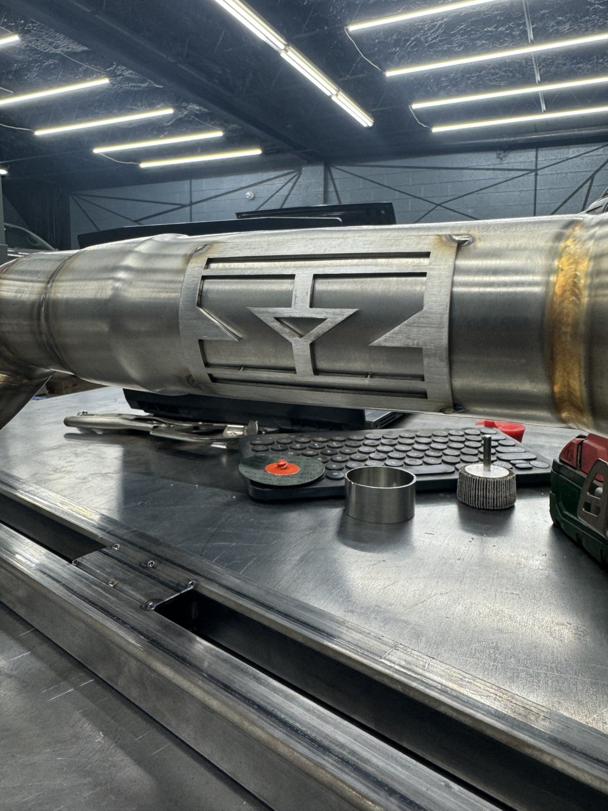

  18. Jul 24, 2024 at 6:08 AM
    #138
    906taco
    906taco [OP] Well-Known Member
    Jun 22, 2021
    #369289
    3,908
    Cory
    08 Taco
    Jig build is underway. But it felt necessary to figure out where the tag was going! Pretty sure there is no comparison to your first released product!
