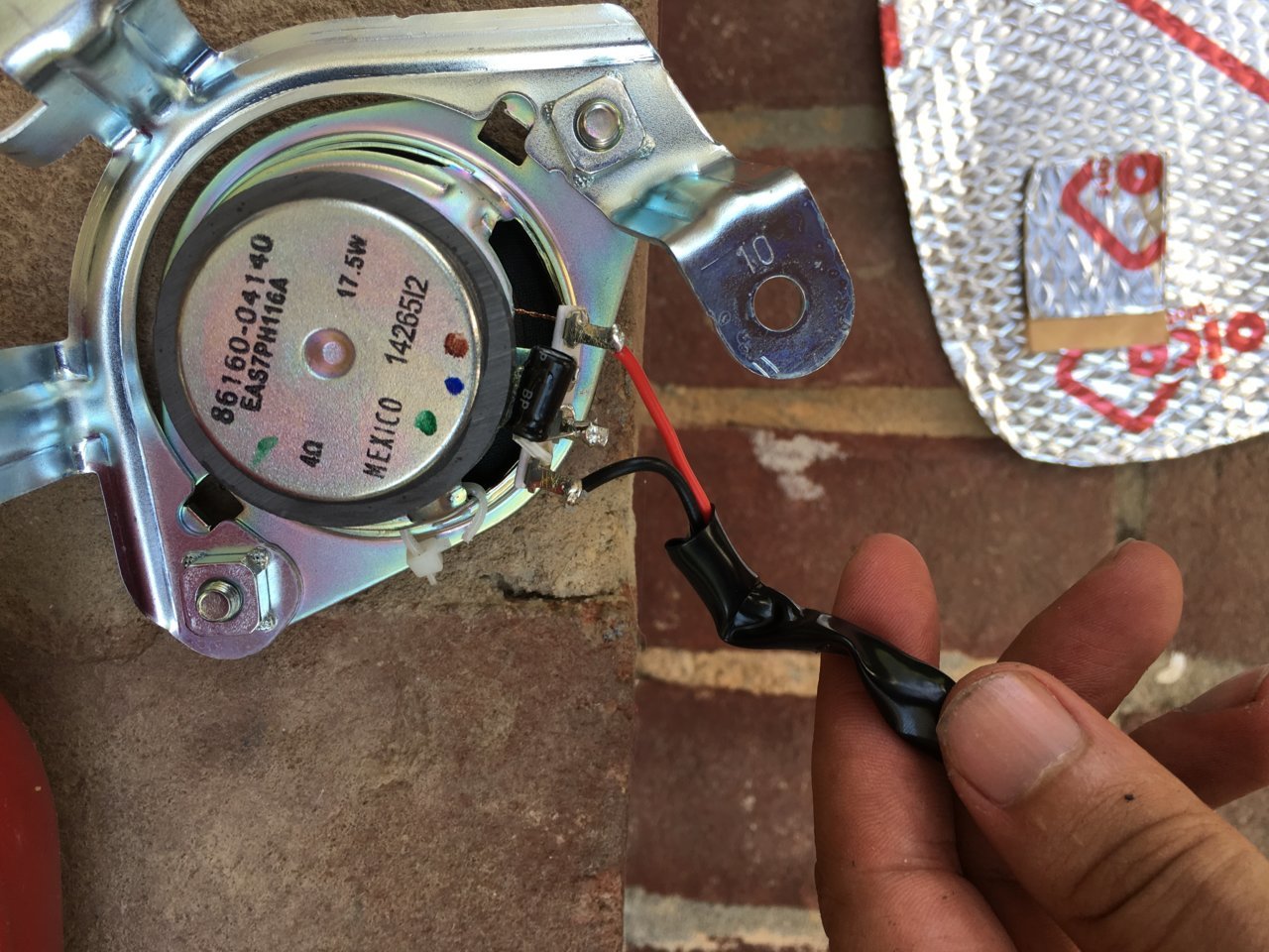

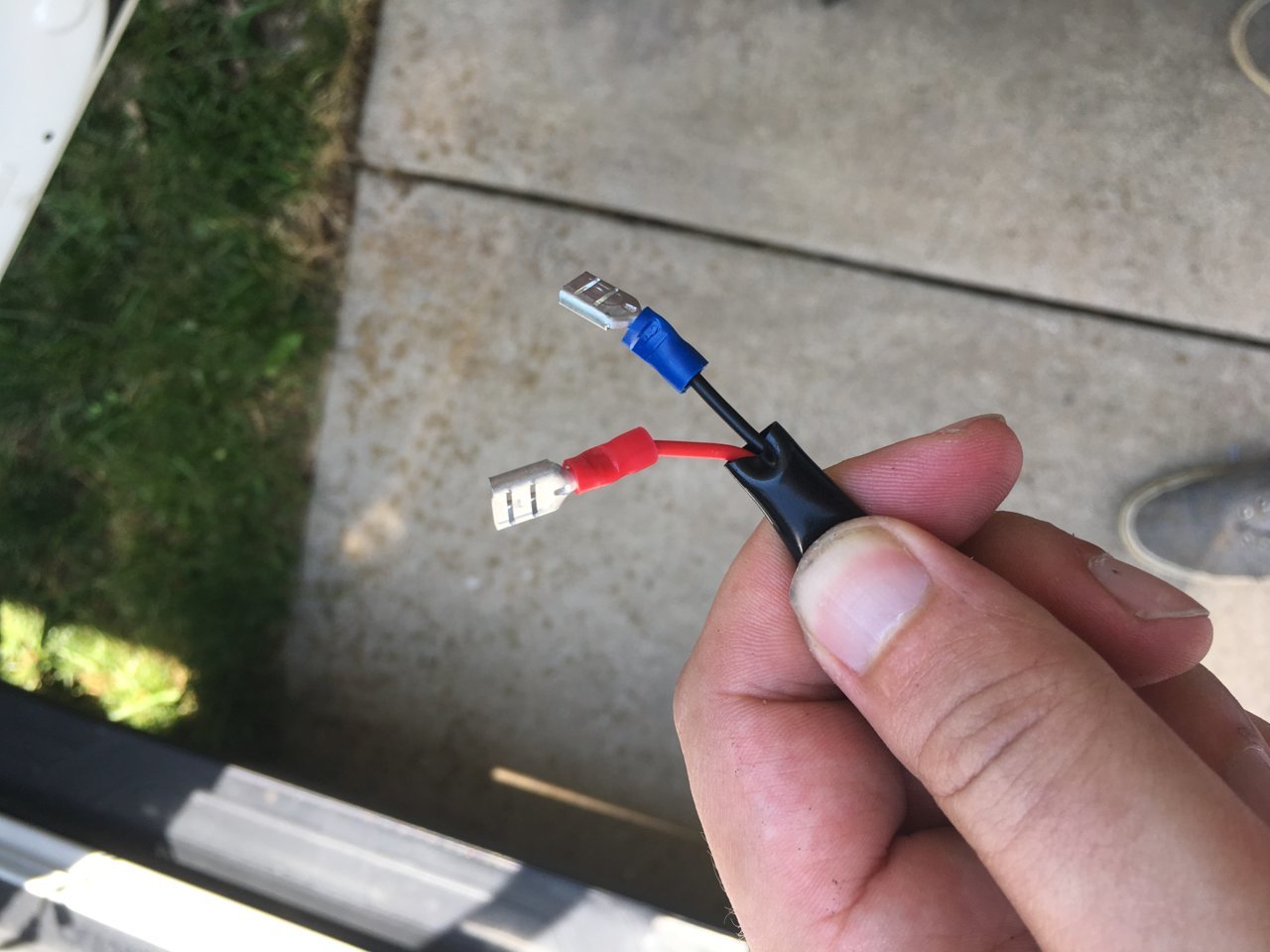

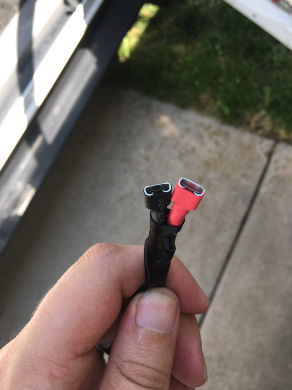

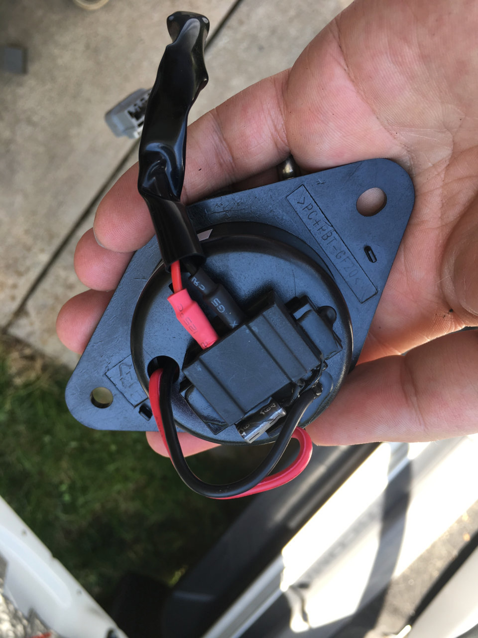

    I made adapters out of the stock tweeter harness, boom - plugin just like stock.

    I used the Subaru Kicker tweeters and didn't modify them at all. They physically bolt in like the stock 2nd gen tweeters, but the factory tweeter plug doesn't work - hence the wiring adapter made from the stock 2nd gen tweeter pigtail.

    Barnburner, is it just the two female flat blade-style connectors that are needed inside the tweeters where the square connector typically goes?

    Red wire to the pink wire and black to the purple on the driver side. Red wire to the green wire and black to the blue wire on passenger side.
