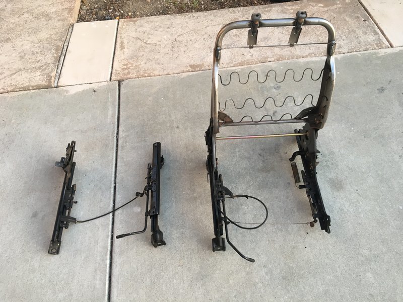

    Go to a chain junkyard on their 50% days and try out every seat you can find. I sat in almost 100 different German cars and they all felt terrible. I ended up buying seats out of a Lexus ES300 with memory foam, leather, heat, and motorized adjustments. What I did is cut the Lexus feet off, grinded the Tacoma brackets to the rail, and welded angle iron to it to retain the sliding function. It doesn't fold forward but I'd rather have the power functions than being able to get in the back.

    The power functions were fun to wire up, there's airbags in the lumbar support so I had to make sure not to send 12v to the trigger wires. There is like 20 or so wires going into the driver's seat.
    The bare brackets you see are the Tacoma 60/40 seats I stripped

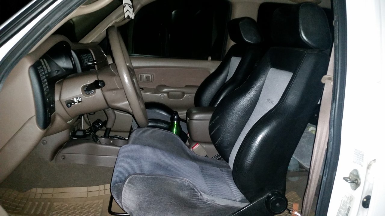

    Recaro Trophy seats from a MK2 VW fold forward. They are manual operation and I ordered Wedge seat brackets to fit the Taco.
