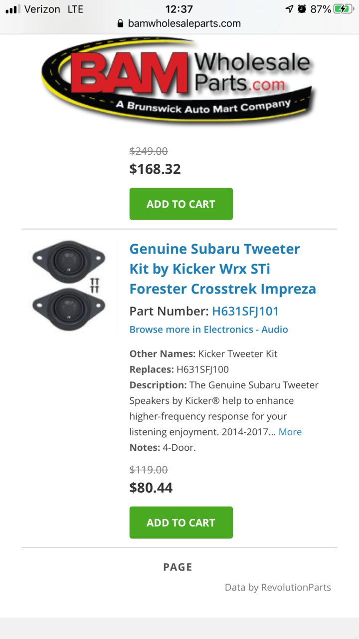

  4. Jan 20, 2020 at 10:38 AM
    Tacospike
    Nov 19, 2018
    #273198
    14,420
    512
    Two Trucks
    $80.44 shipped to your door

    I just installed the Subaru tweeter they are made by kicker .the rest of the speakers are all stock .this upgrade only works on the non JBL systems .u can buy them on the list of links the other guys provided .
