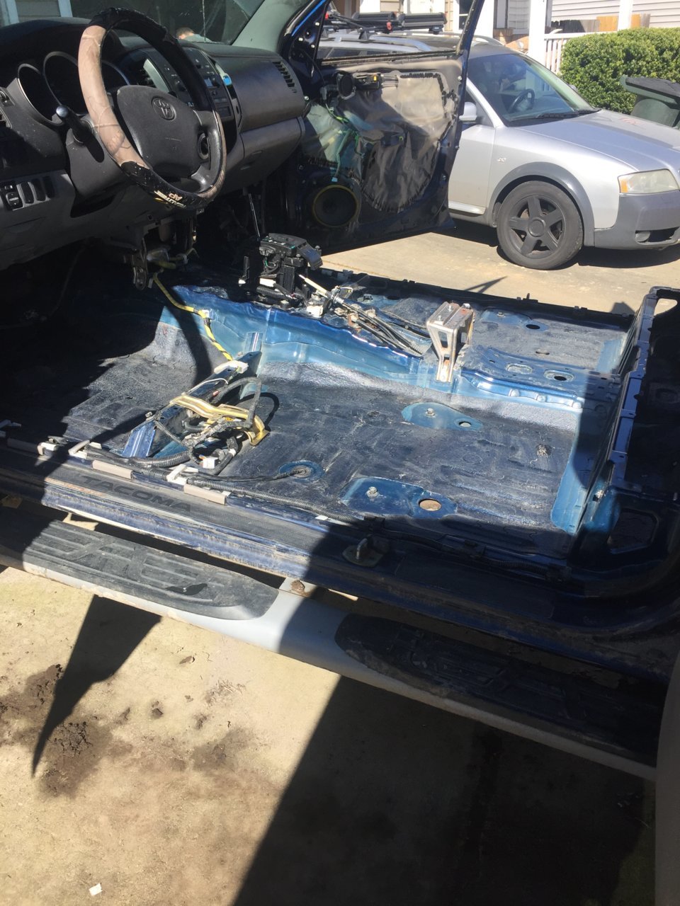

    0430C51F-A3DE-4767-B4E0-50384251D23E.jpg First thing I did, also the vinyl flooring from the Baja Tacoma looks awesome. Seen lots of threads on here about that. Defiantly going that route. Will have pictures of it once it gets here
