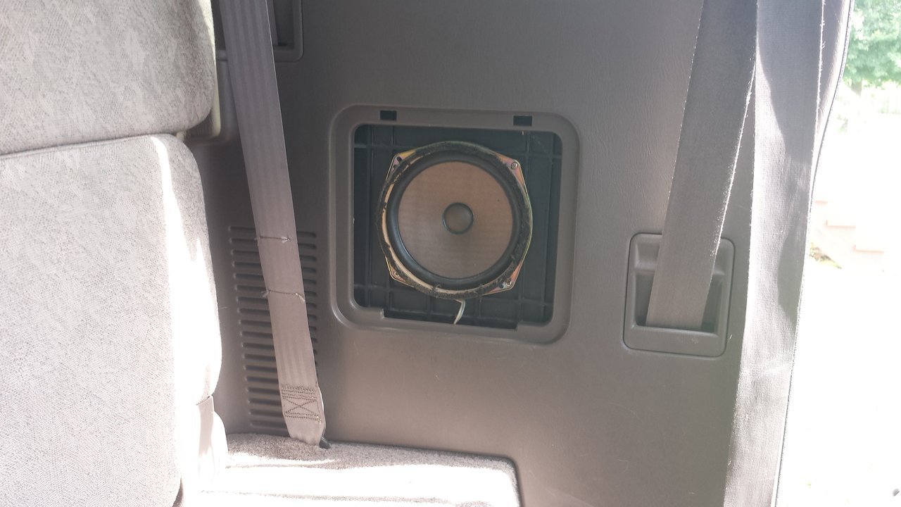

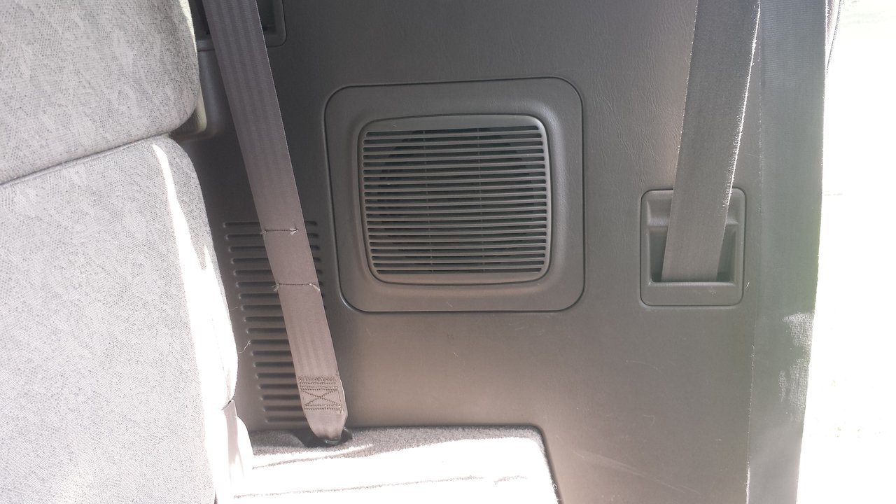

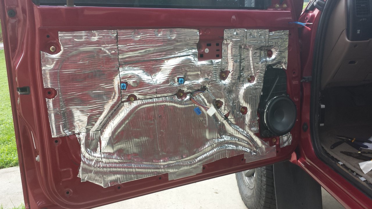

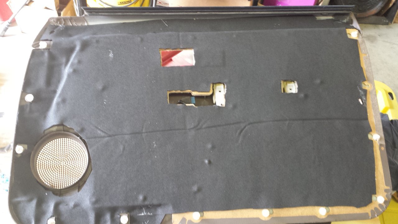

    I can't find where anyone has done this. In the spirit of keeping my truck as practical as possible, it seems like this location is an excellent place to mount a 8" sub in each panel without giving up any space at all. Space currently had 6.5 stockers. Would do a good bit of deadening on the rear like I did on the front doors(inside and out).
    Truck is a 2000 Tacoma ex cab. Pioneer double din pushing Infinity Ref 6500 components now. Considering a pair of 6.5 or 8's subs with an Alpine mrv-f300 pushing all speakers.
    Anyone else done something similar?
    Here's pics of the rear panels with stock speakers. Also included pics of my front doors just for fun.

    Thought about it yeah. Looked into it too. It'll be a project - that's for sure. Maybe no more than building a proper enclosure, but not easy. A peek inside my '03:
    Seemed to me like if you built a baffle kinda flush with the panel you'd probably have a good cube to use in each side. The trick however would be sealing the hole & dealing with the massive hunk of sheet metal back there - which by my estimation is the one place in the cabin most likely to have resonance issues and by a good margin. Glassing this in seems like a good idea, but again much work.

    Thanks for the response. I didn't really think about building an actual enclosure. I can get enough scraps of 3/8 lexan to build an enclosure and glue it together. Maybe do a few internal braces. I really appreciate the pictures. I'm assuming that my 00 looks similar/same as yours. I have not removed all of the interior panels to see exactly whats back there. I guess you have 6x8's instead of 6.5's in the rear, right? So maybe the thick plastic panel that the speaker mounts to is the only difference.
