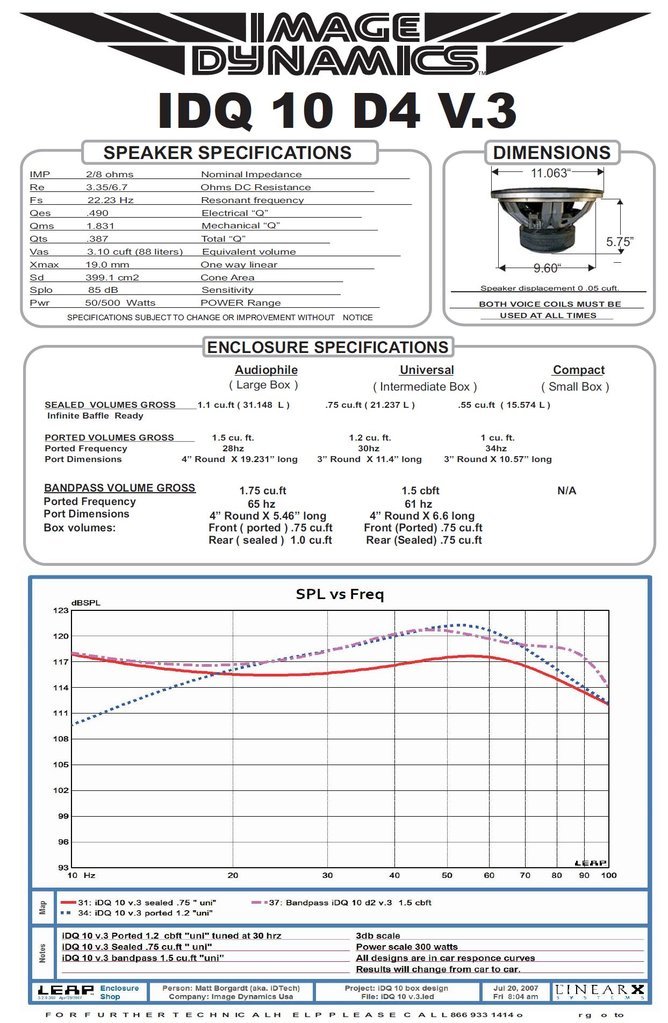

    I found this information on it...not sure if it has everything that you need tho.

    Le is missing, but somehow it passed the driver integrity check.
    I also think they got their ported & sealed graphs backward in the FR graph above. Also never seen a company provide an FR graph with drivers in enclosures but not free air.
    SPL
