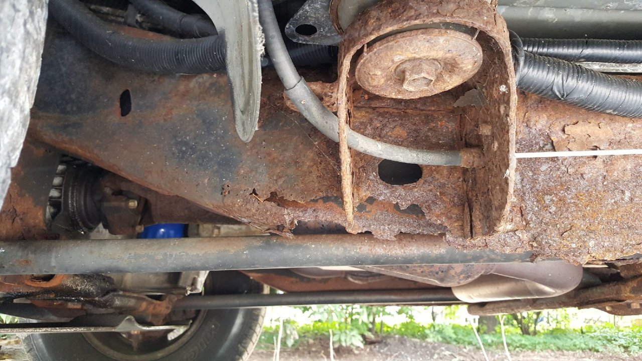

    Yes let's put a Chevy frame on there...
    3498d1528891643-99-frame-rust-repair-res_4c893fa6d99a590b086fd402ac97b33712f11e9a.jpg
