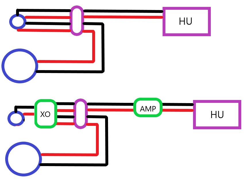

    OK, here is something I learned. The front doors get their signal from the speaker connection at the tweeters.
    There are three scenarios with wiring components to the front (I believe this is correct, but diagram it out yourself):
    1). Each speaker of the component set have their own cross-over electronic parts (capacitor on the tweeter, and inductor on the woofer pre-soldered on the speakers).
    Get a harness from Amazon (see below) and unhook existing tweeter, plug the harness into the harness at the dash, then wire the silver wires with slip on connectors to the tweeters. done.
    2). The component set has an inline capacitor cross-over you need to attach to the (typically + signal) going to the tweeter. Example: Infinity Primus 693C.
    You'd cut off the (+) silver wire of the new connector below, and install the external cross-over inline on the (+) line, and from there, you re-attach the speaker wire with clip and go to the tweeter. The negative goes to the (-) of the tweeter.
    3). If however, there is a cross-over "box" with a single (+) (-) input, and two (+)(-) outputs (as is the case with the Kicker component speakers), then that cross-over box is for both the tweeter(dash) and the woofer (door). Example: Kicker 46CSC6934
    Now you need to know on the harness, what wires will feed the tweeter, and what two will feed the woofer.
    The (+) (-) wires (4 in total need to be separated) and the two in the harness coming from the amp or head-unit need to go to the (+) (-) input to the cross-over. Now we need to deal with the boxes two outputs
    Wire from the cross-over box tweeter output wires to the silver wires with clips to the tweeter.
    Wire from the cross-over box woofer output back to the 2 wires going back into the connector of the harness for feeding the woofer.
    I just purchased the following harness, and because I'm Option 2, my job is easier. If I need to go Option 3, then I'd consult the guru on here for the pin numbers and wire colors for the harness "in/out" connections.
    Have I lost anyone? :duel:

    There are diagrams of the 4-prong dash connection floating around on this site. Two prongs at the connector go from head unit to tweeter, the other two go from tweeter to door woofer. The stock crossover was built in to the tweeter itself.
    What I did was buy the matching metra plug off of crutchfield. Then I wired it up so that the plug was connected to my new crossover - two prongs went to input, the other two went to woofer output. The new tweeter gets wired directly to the crossover. No cutting or splicing of factory wires needed with this method - its all plug/play and reversible.

    Good info. :thumbsup: Will probably add the Sony XM-S400D or Kenwood KACM1814 amp next.
    Keep meaning to ask, is this the wiring harness you used?
    https://www.amazon.com/dp/B09DTY8PMD/?coliid=I178F81I7P9HWW&colid=2UV4IDMTR1NJ0
    If not, link please plus how you ended up wiring the speakers and power to the amp? TIA!

    That is exactly the same harness I used to place the Sony amp between the Head Unit and the speaker harness going out to the speakers. No cutting of OEM harnesses. Cut the Red Wolf harness in half, and the female end connects into the back of the HU. The mae end connects to the factory wire harness.
    Power - I ran a 15A circuit all the way back to the battery with a slightly higher gauge wire (12AWG). The negative was wired to a bolt that is part of the dash assembly and grounded. For the SONY to come on, I had to wire the remote wire back to an Add-A-Fuse mounted under the dash at the fuse holder. I think I used a 2A fuse for it. I used a circuit that is "switched" meaning it goes hot after the ignition is turned on. :cheers:

    Yep, excellent diagrams. What you show here is the original wiring, and the option 3 I described, were the output of the amp feeds the cross-over (I guess placed down into the speaker cavity and sits in the dash). This is the Kicker example. Then the tweeter output of the cross-over box is wired to the tweeter. The woofer output of the cross-over is wired back to the connector to feed the woofers in the front doors.
    What you don't show is here is option 2 where the top diagram is used, but the red (+) of the connector feeds the woofer, and also feeds one end of the "inline" capacitor / cross-over, that then goes onto the tweeter.
    Thanks for diagramming it out.
