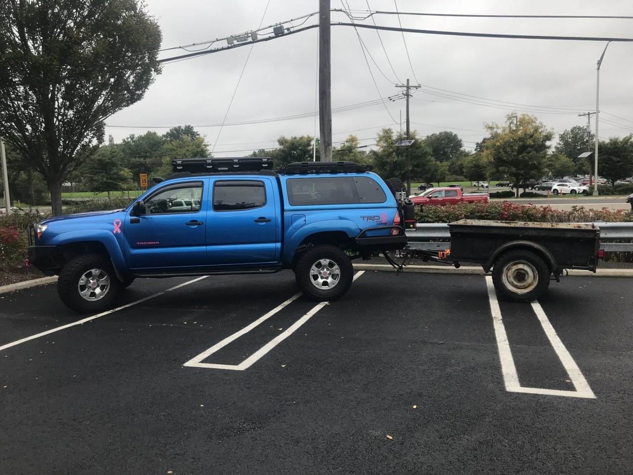

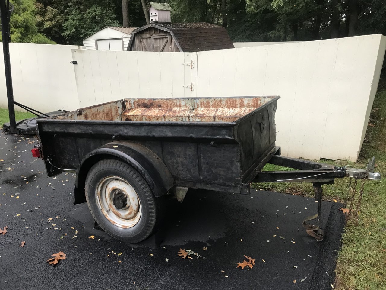

    Bought a Trailer

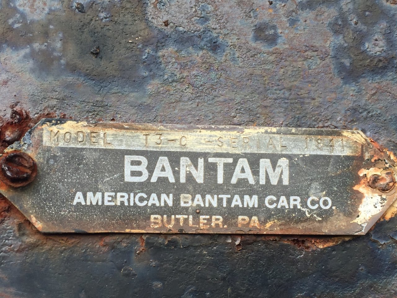

    Model: Bantam T3-C
    Serial Number :1841
    Built: 1946
    American Bantam Car Company in Butler, PA
    GVW: 1050 lbs
    Payload: 500 lb
    Dimensions:
    38" X 72" floor X 18" Bedside Height
    Upper opening (at its widest): 48" X 72"
    Original Tag:
    Overall objective for the trailer:
    Still tossing around ideas. I think I want to keep it as true to the original model as possible.

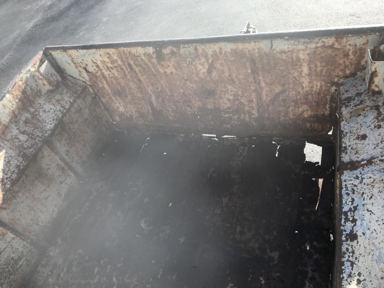

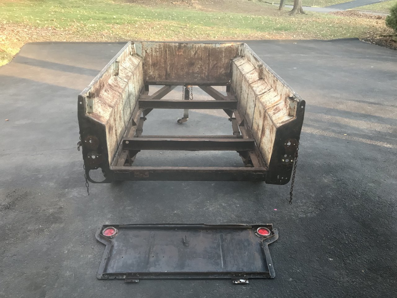

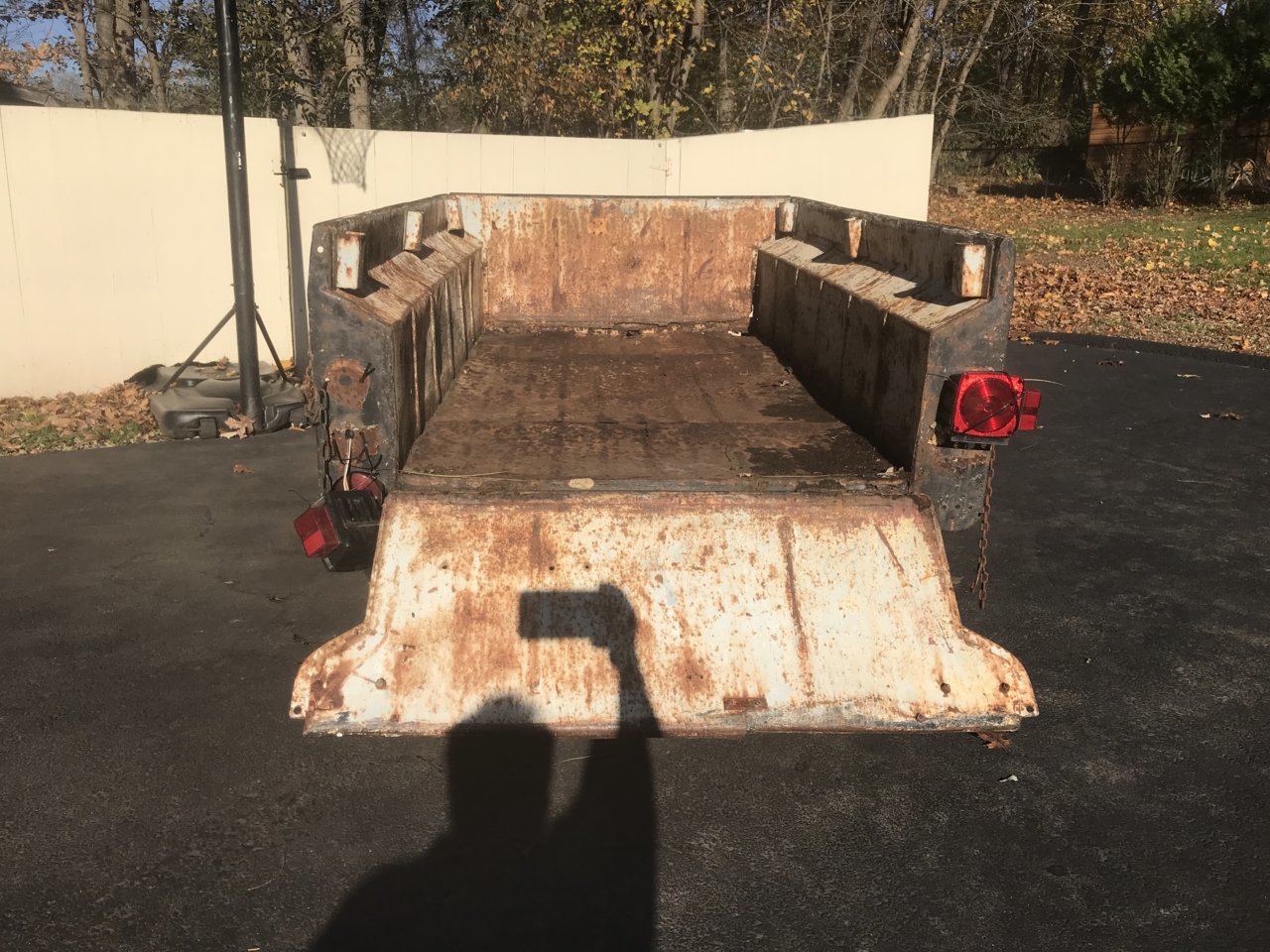

    Rotted floor. Left and right bed sides are sound. Front and tailgate is a little rough.
    3E76D25B-F246-4B1F-82C3-AD375569B0BB.jpg 48EA9F6E-1B09-43C9-B6A0-FE7100F1A329.jpg
    Floor gone!
    Looks like the floor is 16 gauge (best guess)
    I’ll try to replace with 14 gauge.
    Floor dimensions:
    38” W x 72”L
    C-channel frame has surface rust but looks solid. Probably will just clean and prime and paint.
    Tailgate and Front bedside panel needs work.
    Edit: 1/12/2019:
    Tailgate replaced with 1/8", 1"x1" square top tube, 1"x1" angle and flat reinforcement. four weld-on 1" x 3" mild steel hinges.
    Front bedside panel replaced with fold-down version: 1/8", 1"x1" square top tube, 1"x1" angle and flat reinforcement. four weld-on 1" x 3" mild steel hinges.

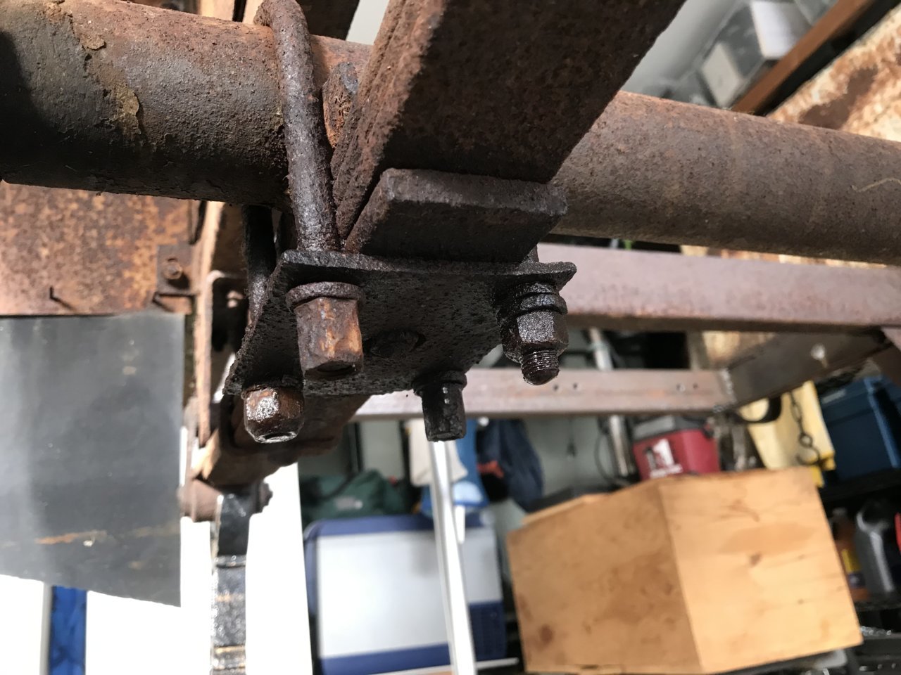

    Springs, hangers, ubolts all look good.
    Edit: New axle ordered: Taco Bolt 6 x 5.5" bolt circle, 53" inside hub to inside hub. Future brake capable.
    Edit: 1/18/2019: Springs might need to be replaced:
    35.5" eye to eye. 2" wide, 1.75" tapered at eye.
    Edit 2/28/19: found that current springs are wrong size and not matched. Left sags lower than the right sides.
    I just confirmed that the leaf spring is the exact spring used for 1945-53 Jeep MB, GPW, CJ-2A, CJ-3A.
    1.65” x 35.5” eye-to-eye. No taper.
    I’ll use 10 leaf springs and pull leaves if the ride is too stiff or bouncy. https://www.quadratec.com/products/918201_02.htm

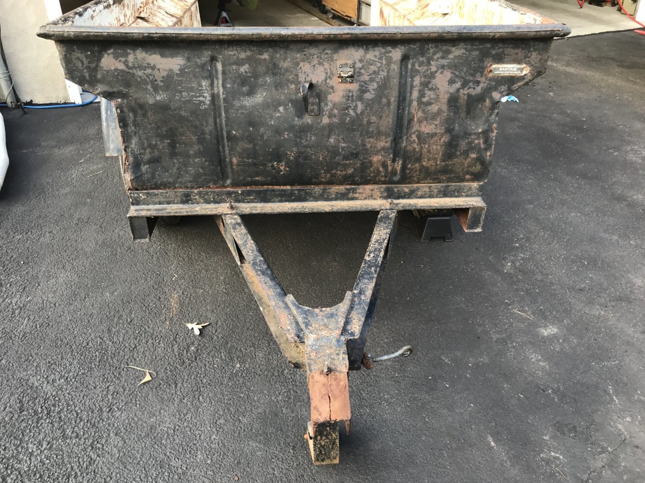

    Hitch, Coupler and Wiring.

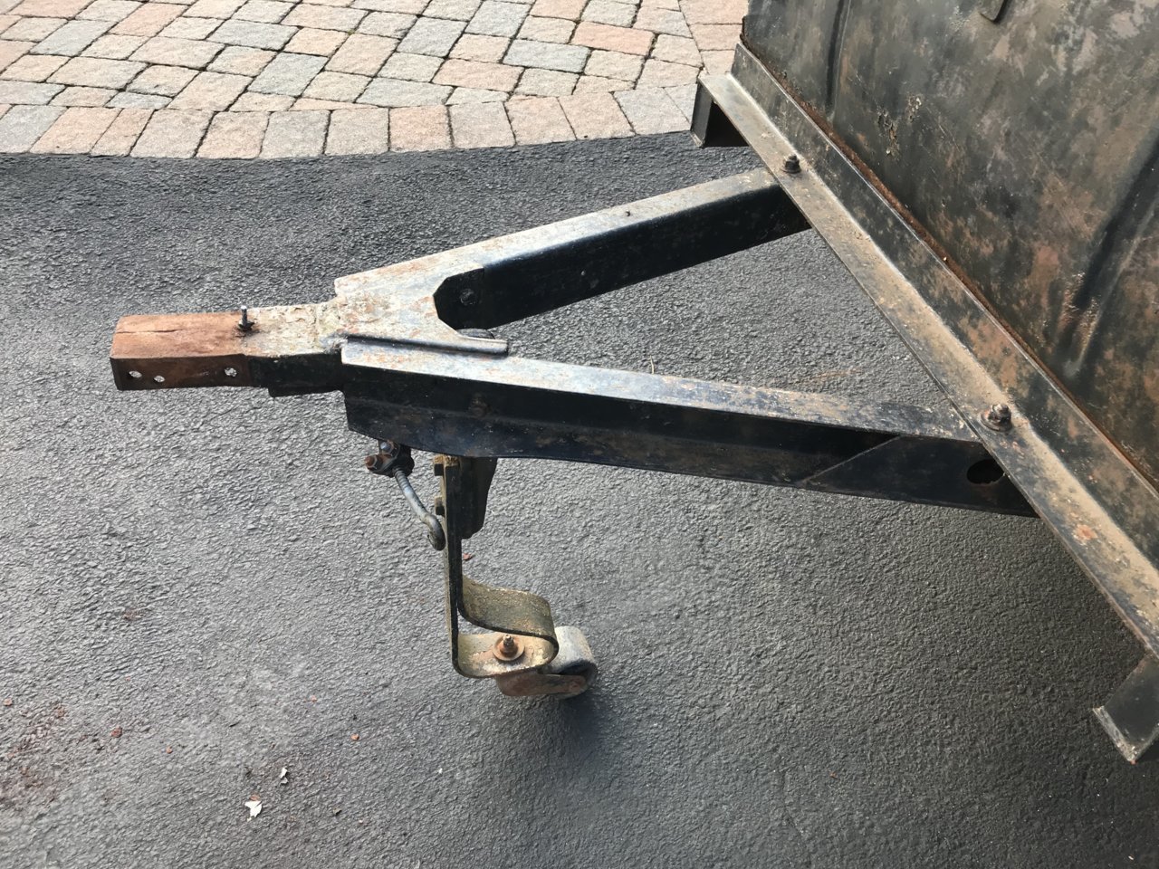

    I believe the hitch coupler is not original. It’s for a 1-7/8” ball. I’ll need to research this.
    Edit 2/28/19: I replaced hitch coupler with a class IV rated 6500 lbs, for two inch ball. Two 1/2” x 3.5” Grade 5 bolts are fastened vertically into tongue. And one massive 5/8” x 4.5” Grade 5 horizontal through bolt.
    I’m gonna be top loading my not-yet-acquired 12.5 foot fishing kayak, and want to keep the center of gravity of the kayak forward of the trailer axle. So I think I want to extend the trailer tongue length. It’s currently 32” from the leading edge of the trailer box. I’d like to add about a foot more of trailer tongue length. Edit: Just calculated that I need to add 6 more feet of tongue length. But I’m not quite sure how this would affect the handling/tracking of the trailer. Edit: Just calculated that I need to add 6 more feet of tongue length.
    The taillights are classic, circa 90’s off-the-shelf auto parts store trailer lights wired via wire nuts to a flat four connector. The entire light set and wiring harness will be replaced. I need to research a LED trailer light set that would still match the era of the trailer.
    For future reference.

    Need to extend the tongue. Somehow add 6 feet to the end of this. To clear the nose of my kayak and give me turning room clearance from my rear swingout.
    Ideas:
    Folding tongue
    Folding tongue instructions

    Cut out the rotted floor.
    Will weld in 36” x 72” 14 gauge sheet metal.

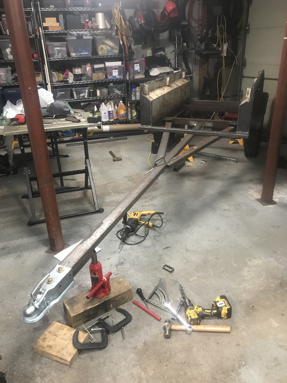

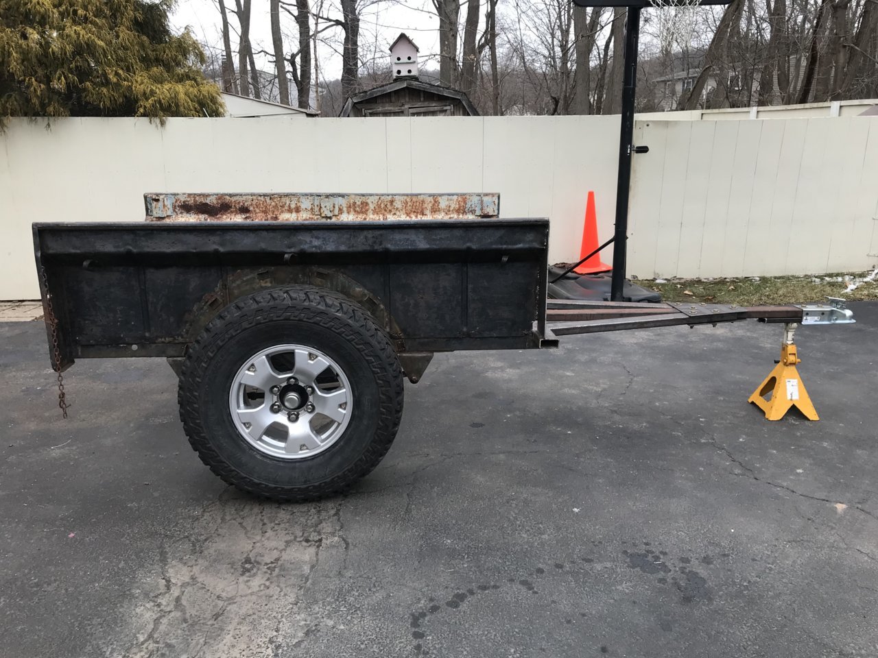

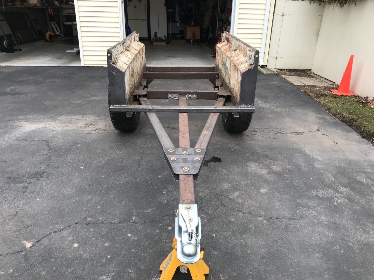

    Finally getting somewhere.
    8.5 feet of tongue length. Should clear my kayak without using a hitch extension in my truck receiver.
    New front and and rear 2 x 3 cross braces.

    Extended tongue for kayak capacity
    Skierrichy and koditten like this.

    Are you putting cross bolts on the tongue coupler.? The bolts that you have in there now are not the strongest way to attach the coupler.

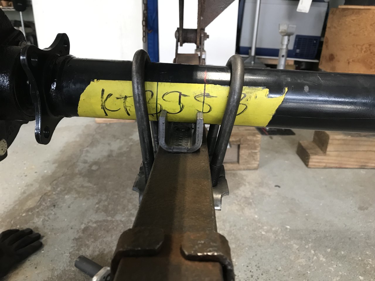

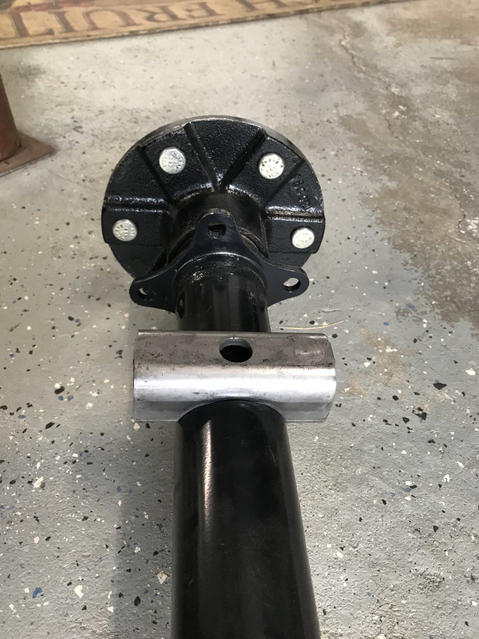

    Axle and fender removal.
    Old stuff
    2 u-bolts, four different sized nuts
    Need to weld these perches onto the new axle
    New U-bolt plate is made for standard 1.75” width springs. It appears that someone installed the wrong width springs in this trailer’s 70 year life.
    @Grand dude found me the elusive 1.75” x 35.5” CTC leaf springs at a military reproduction website. https://quartertonparts.com/product/mb-gpw-cj2a-cj3a-m38-a-612-8-leaf-front-spring-new/
    Axle bolted on and wheels installed. Everything is mocked up, nothing welded until I finalize my spring and fender purchases.
    AC3AB89A-DB9A-49FC-8541-6ED35A91F242.jpg 43FDF8B7-12C4-4E73-82C4-B342B8911A62.jpg
    Grand dude and Skierrichy like this.

    Yeah. I haven’t finalized my tongue length. Once I do that, I’ll drill the holes for the cross bolts.

    Lloyd I looked into how brake mounts were setup in reference to the spring perch, I saw a couple were parallel to the spring perch
