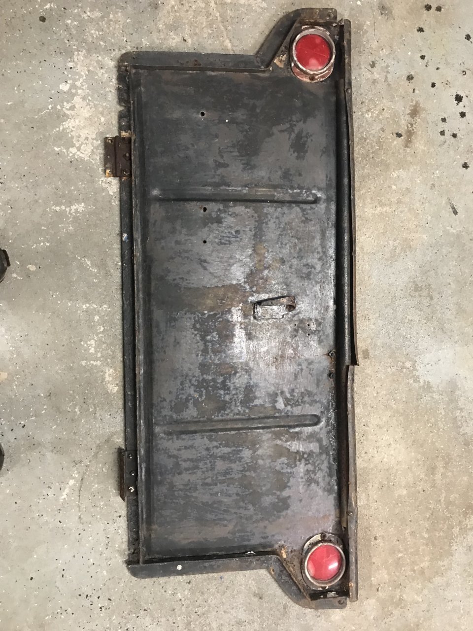

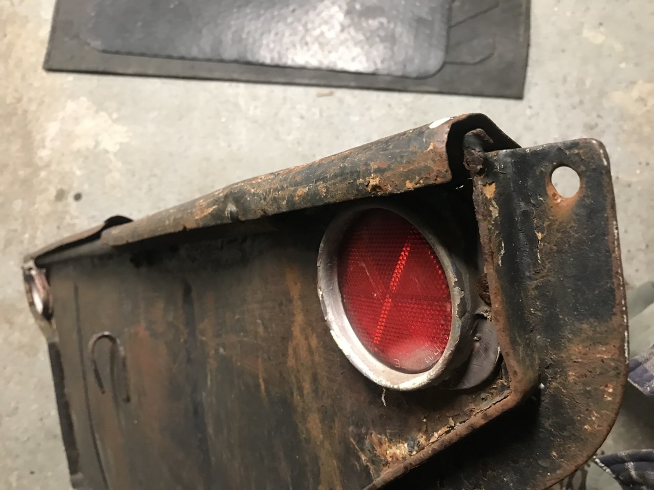

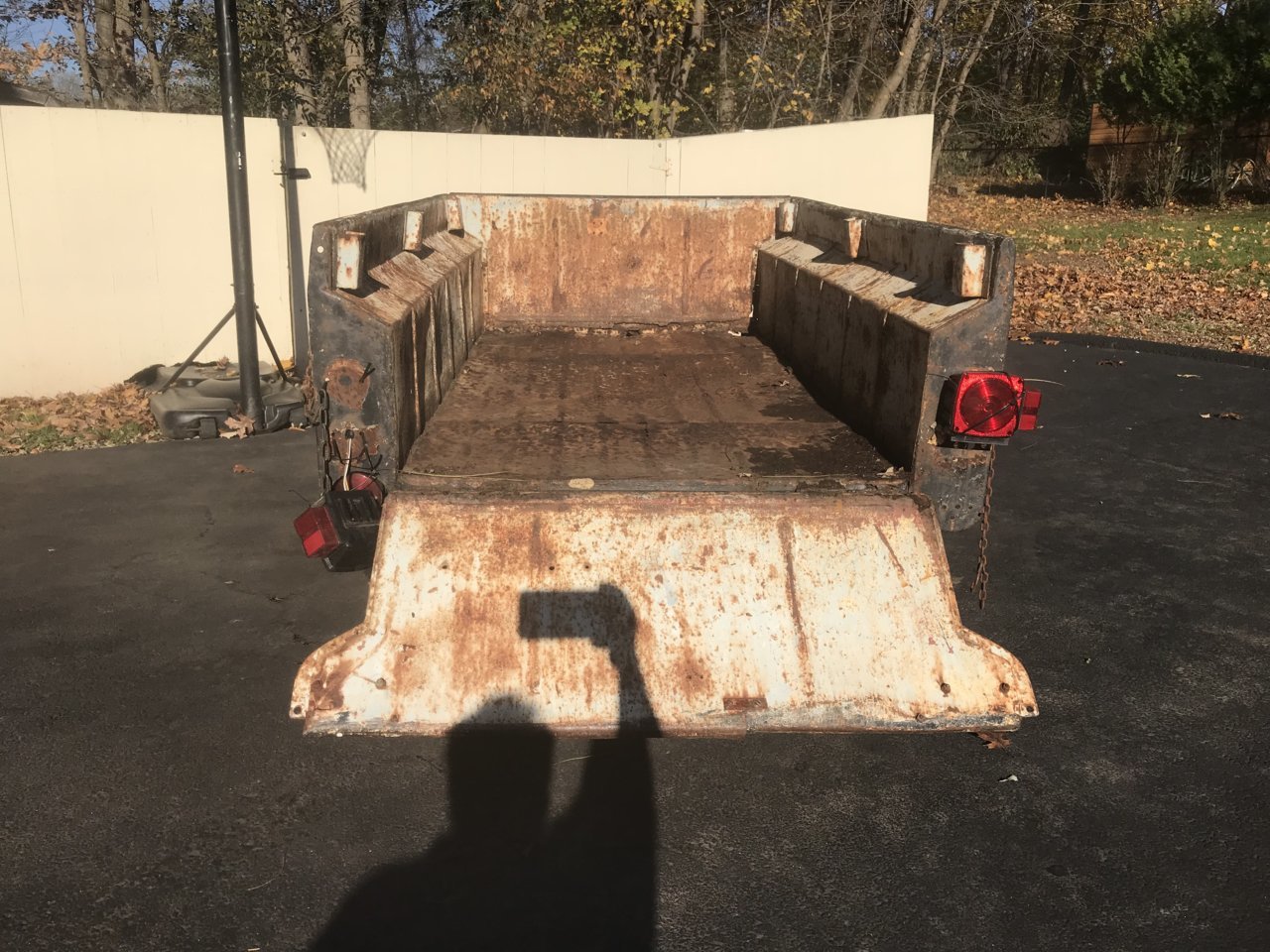

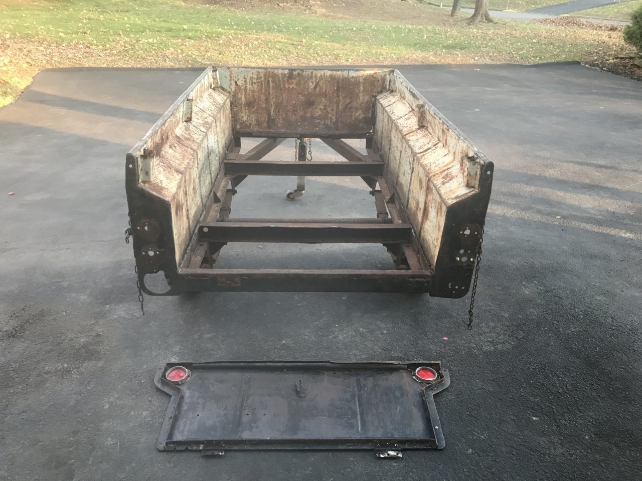

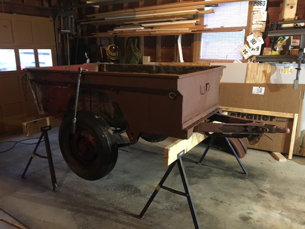

    Old tailgate and front bedside:

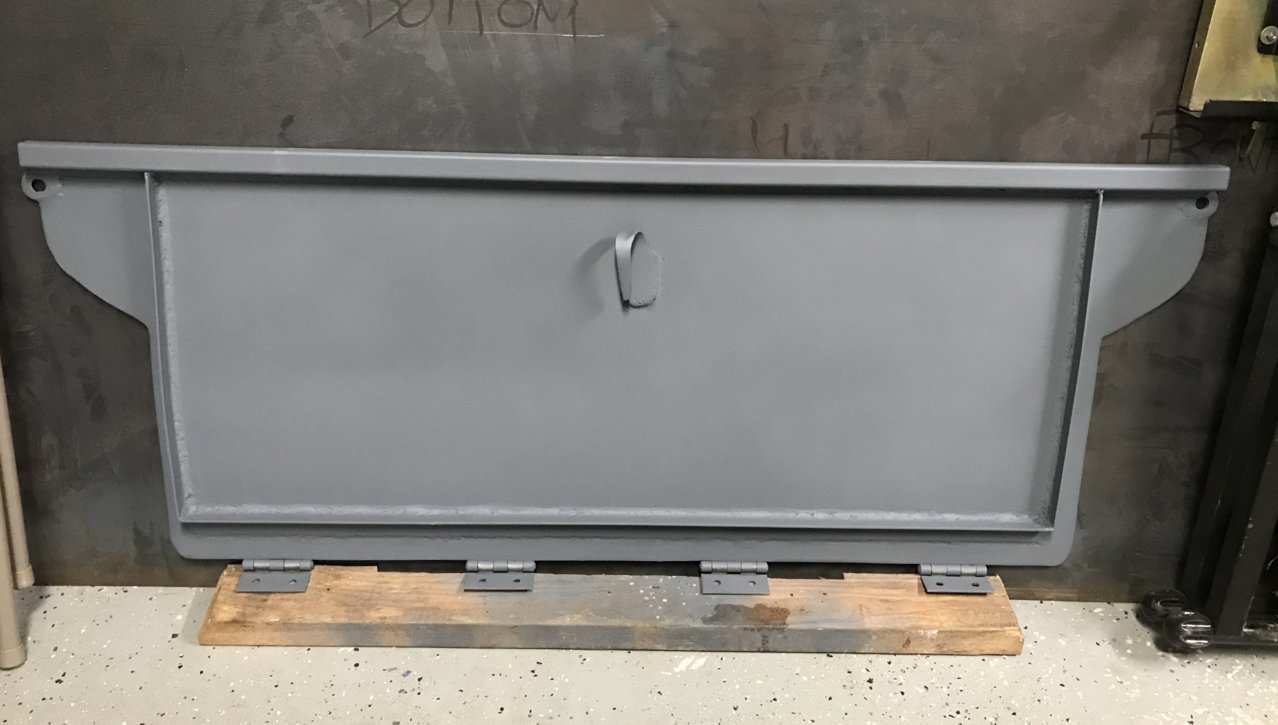

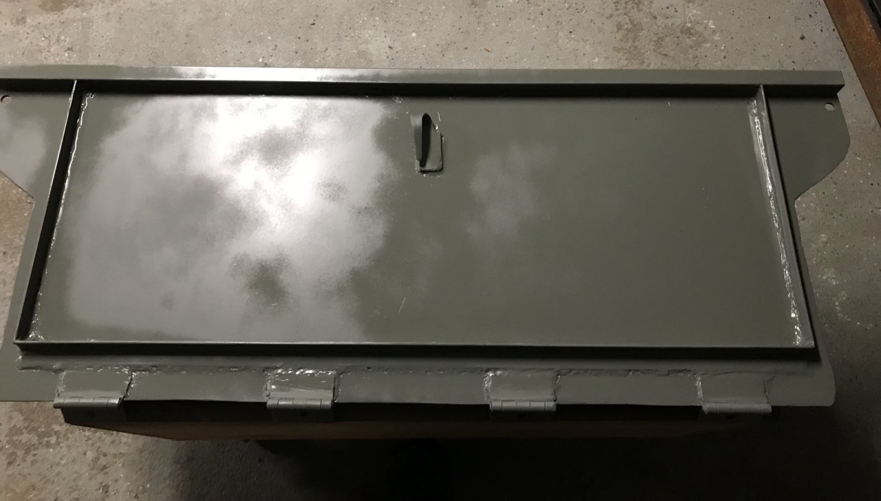

    New tailgate:
    New front gate:

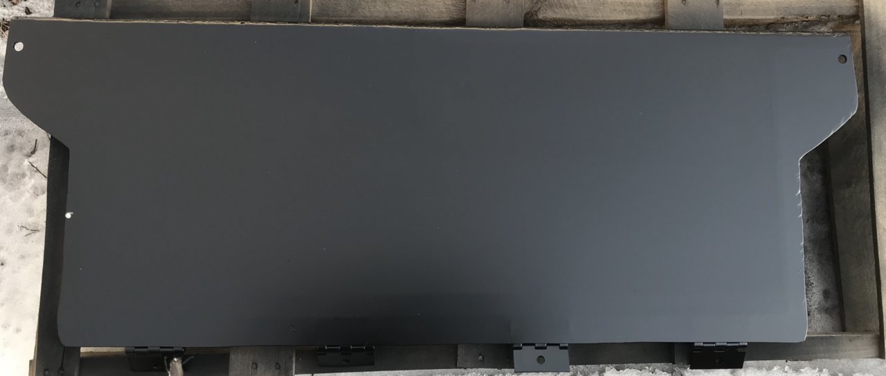

    Tailgate:
    Fresh primer:
    Fresh black satin topcoat:
    Fresh bird crap:
    REALLY???????!!!!!!

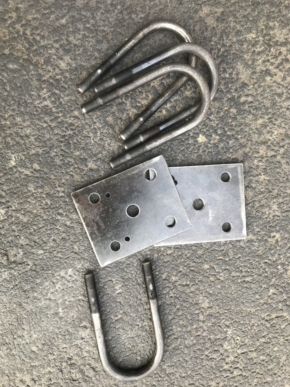

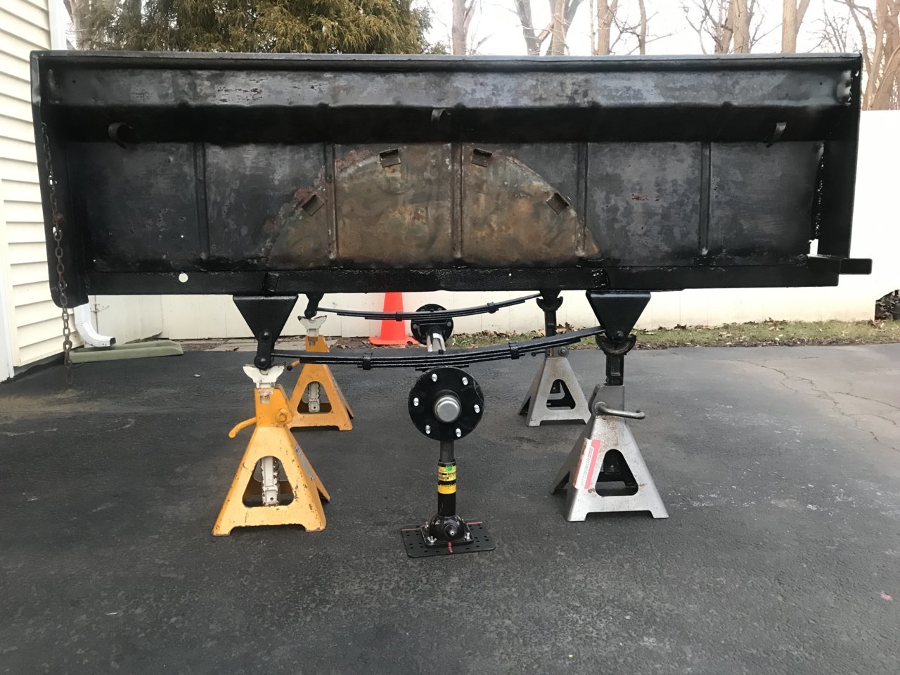

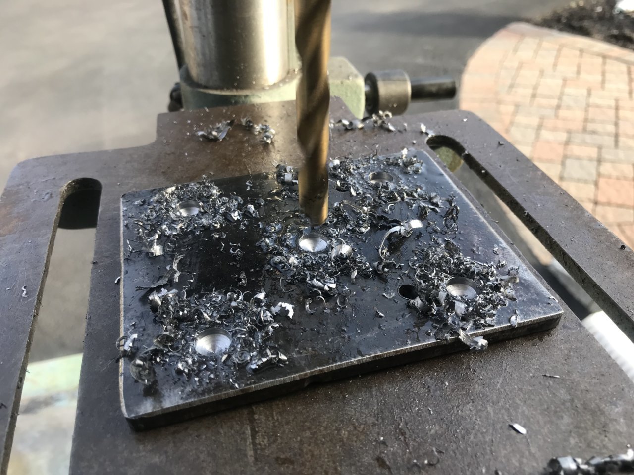

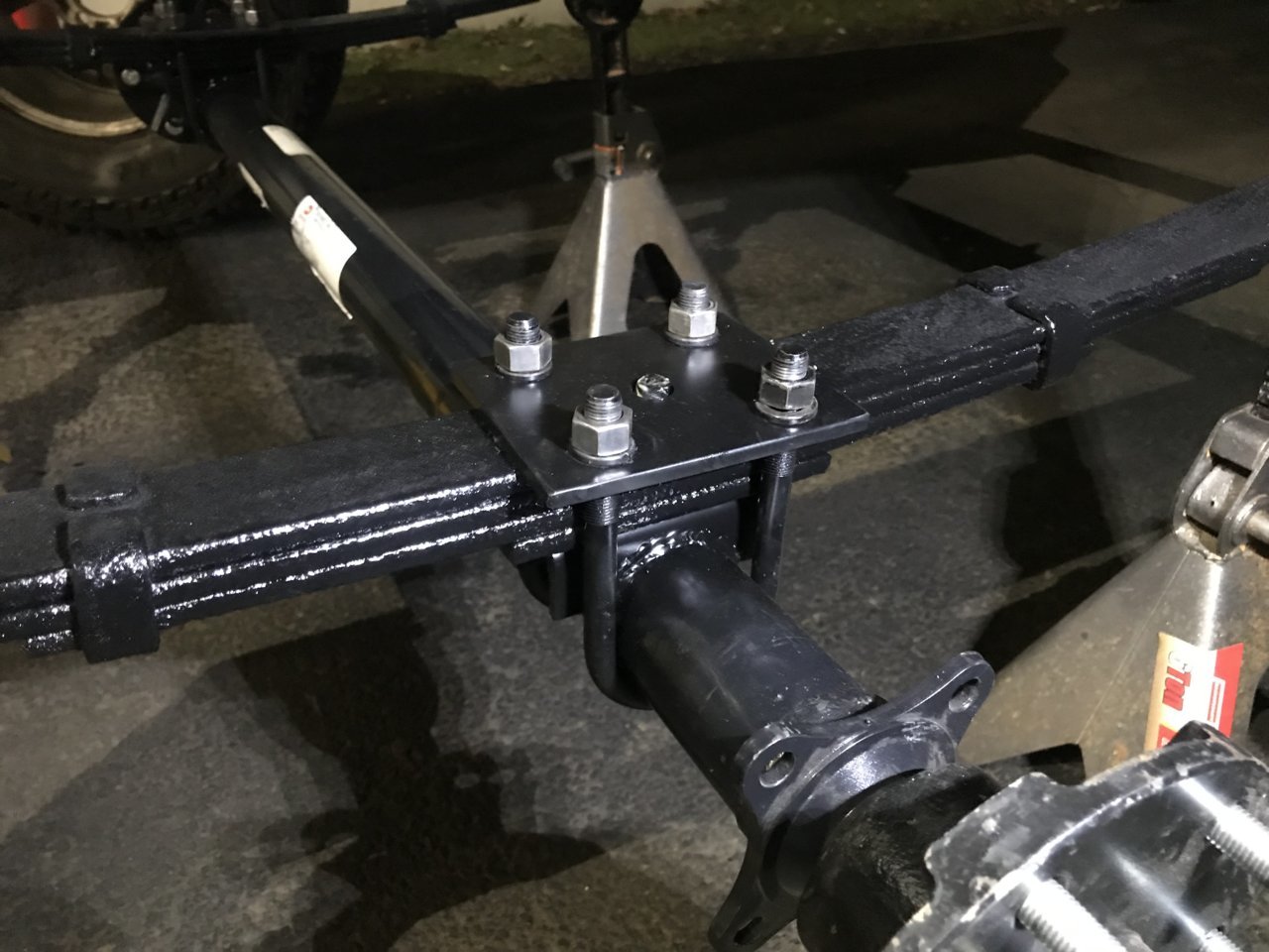

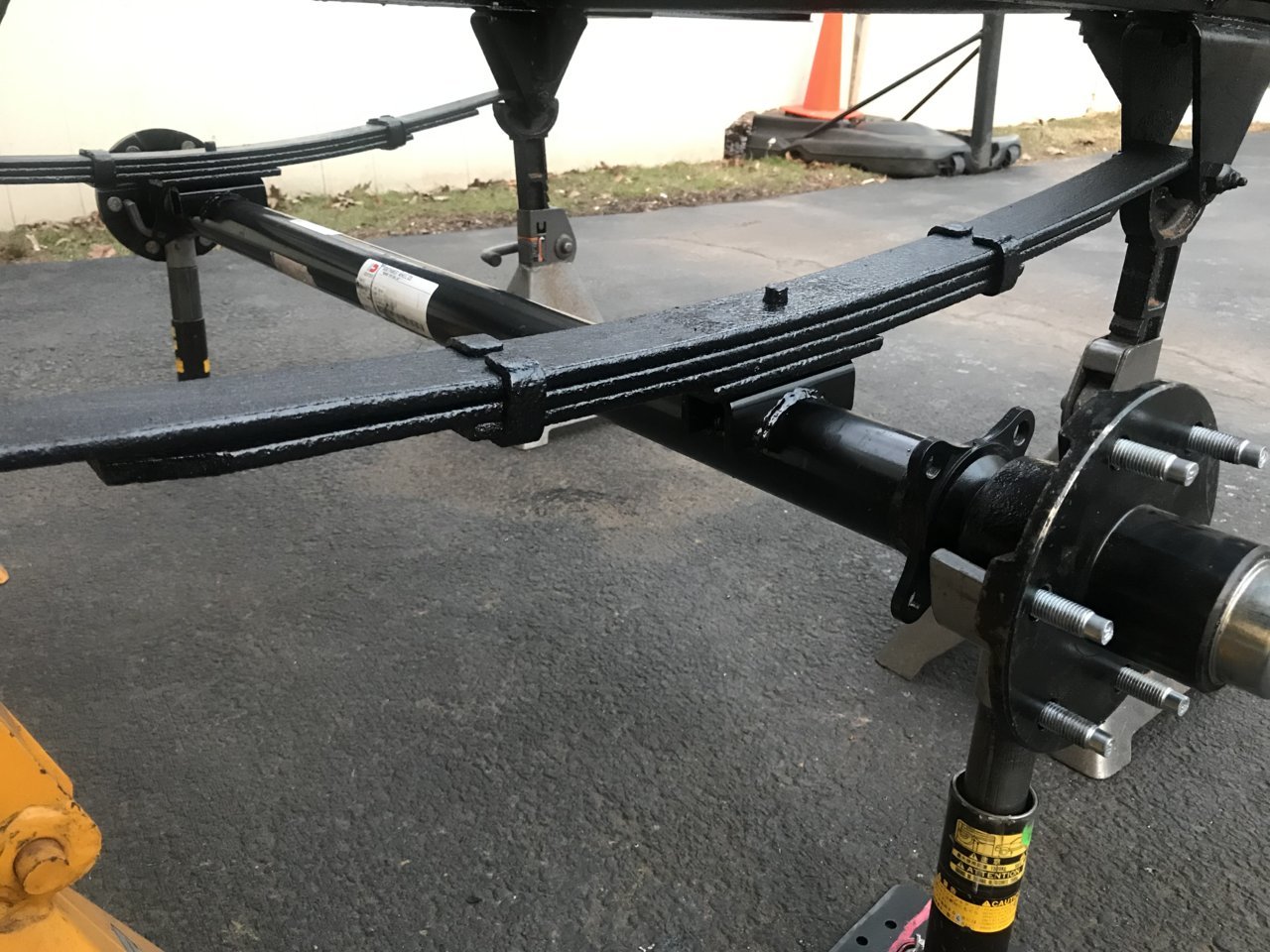

    New u-bolts are splayed at an angle because the U-bolt plate is designed for 1.75" width springs and the trailer springs are 2" wide.
    Had to fab my own 1/4" plate. Came out quite nicely:
    Axle perch needs to be welded on.
    Decided to try axle under the springs. Not sure if that’s how I want it. The trailer seems a little high.
    All bolted up.

    @Rexfordian13 - Are you able to source parts for this trailer? I need leaf springs and the current ones aren't even close to the 1.75" x 35.5" (eye-to-eye) 8-leaf. The current is 4 leaf, aren't a matched pair, and one side sags more than the other.
    Leaf springs for 1941-53 Jeep MB, GPW, CJ-2A, CJ3-A are bolt on.

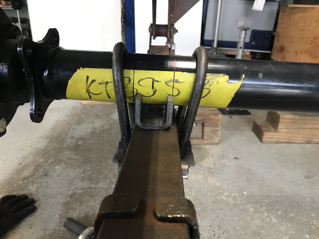

    Found a great deal for a 10-leaf pack with exact fit. at Quadratec.com, but still looking for the spring bolts, 7" x 2-3/8" ID u-bolts and shackles. Any ideas?

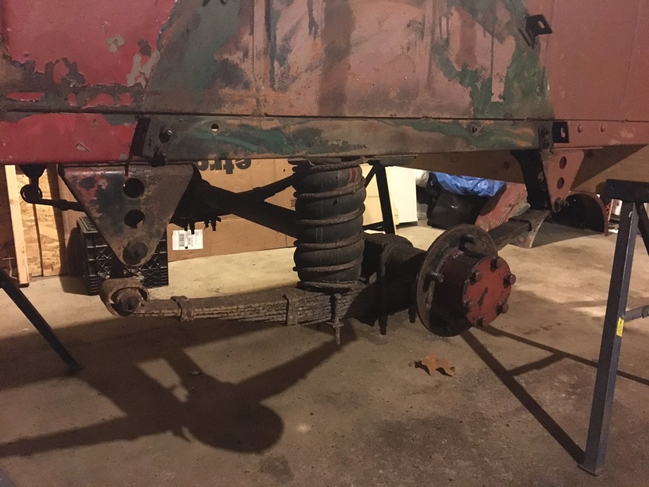

    I picked up some leaf packs several years ago to replace mine, they were not the suggested Jeep packs but something from a shop that seemed like they would fit. They’re buried in the garage right now, I’ll see if I can find them and post pics and details. Currently, my originals are in rough shape.34479C84-E3F2-4114-9B85-1A7E18196495.jpg
    Airbags are toast...

    Your trailer is a T3-C ?

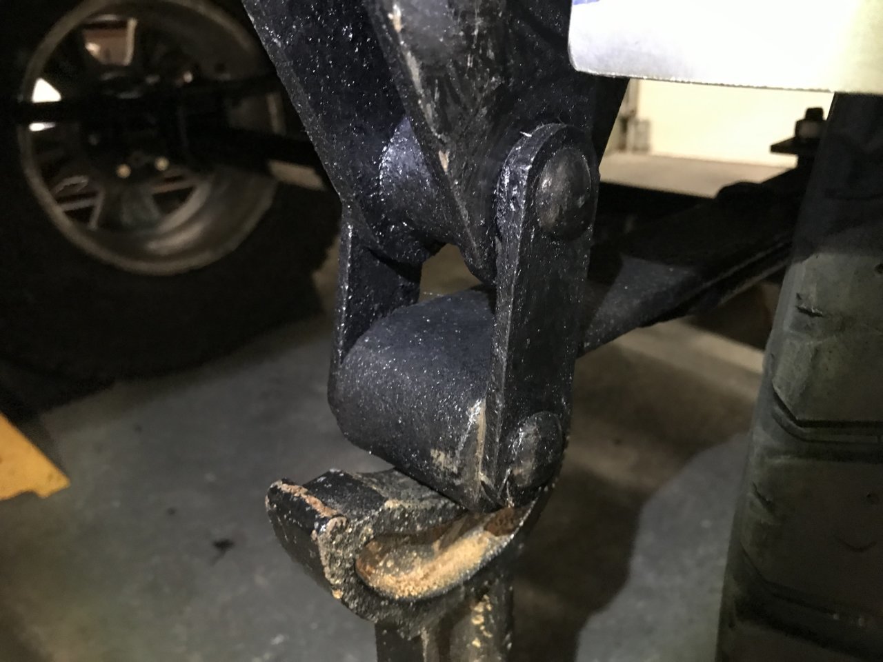

    The mystery of my leaf suspension is starting to unravel. Not only is my 4-leaf springs wrong and mis-matched, the rear leaf shackle appears to be wrong.
    I might be able to get the correct rear shackle after looking at your pic.
    This may be it:
    https://www.quadratec.com/products/918270_13.htm
    I count 8 leaves in your pic. When you get a chance, can you measure the depth of all
    8 leaves so I can figure out what length u-bolts I need?
    Can you also measure the OD of your axle? My aftermarket axle is 2-3/8” OD. Now I can’t seem to find the correct U-bolt with the ID that fit my axle AND long enough to manage 10 leaves.
    https://www.quadratec.com/products/918201_02.htm
