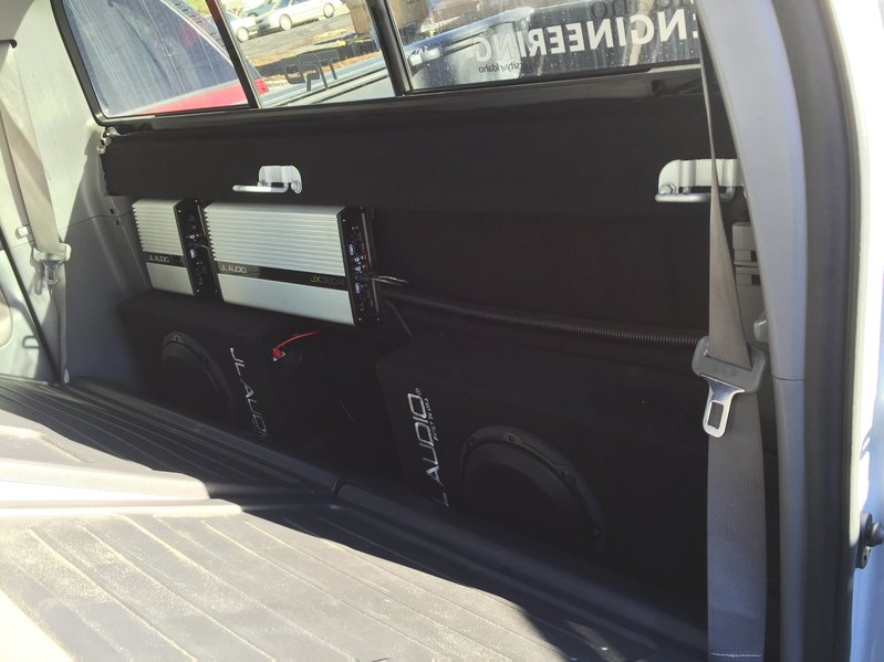

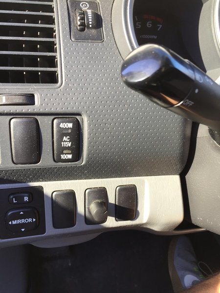

    In my second gen I have two 8" JL microsubs and they sound very very good. People are totally shocked when I tell them it's just two 8" subs. The subs come with a ported box and after removing the plastic behind the seats of a second gen, they fit. For my truck, the two single boxes fit better, but JL makes a box that can fit two. Not sure how it would fit your truck, just thought I'd throw it out there. I can get pics of mine if you want.

    four JL 8s behind my back seat

    That's how mine is set up. I listen to everything from metal to rap. It all sounds really good. I have them powered by a jl 500x1 amp and it came with a bass knob so I can tweak the bass volume very easily. I couldn't be happier with my setup.

    I will get some pics up tomorrow...it's the storm of the century outside lol
    I have a JL jx500/1 for the two subs and then a jx360/4 pushing my focal ps165 door speakers. Components up front, coaxials in the rear. Love love love it
