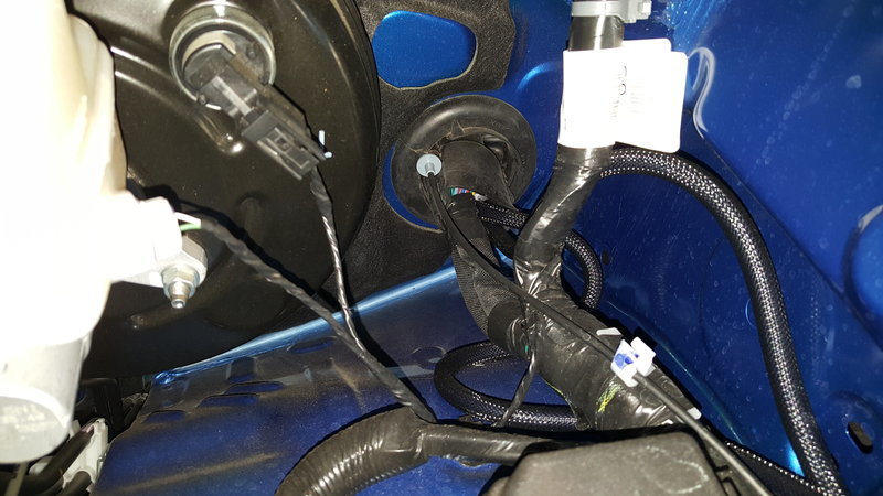

    For those installing yourself. Where are you running the power write for the amp?

    I have seen people run them through the rubber grommet in the firewall on either the driver side or the passenger side - there is a grommet on each side. I have also seen where people have drilled their own hole in the firewall on the driver side, installed their own grommet then ran their power wire through that

    I went through the firewall using the main harness grommet on the drivers side.

    I plan to go through one of the grommets, haven't decided what side yet. Right now I'm working on figuring out how to make the sub box, then I'll work on the rest.
