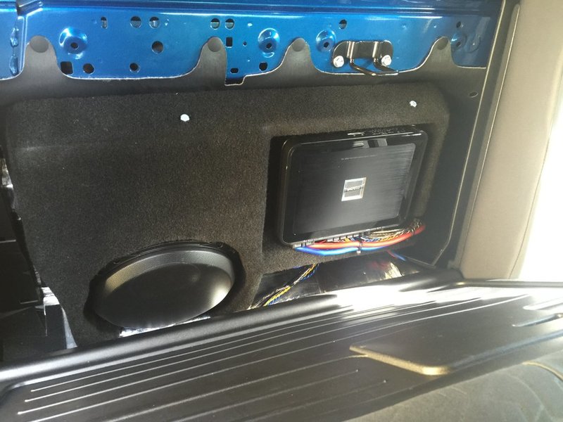

    Yep the vents are a pain in the ass. I ended up building a box that would get around them. None of the box builders have a pre-fab option yet and the second generations won't fit. Mine is not done yet, but it's installed and fits up. Here's a couple of picks.

    Thanks. No I just removed them. They reshaped them because of the vents making it hard to build a box to fit in them. The curve in on the bottom and sweep out at the top. There also like $700 to buy new ones. I wanted to make a build that didn't cut anything so I could put it back if I needed too. I did cut out the child safety hooks. My car seat days are long behind me. Other than that the box fit right in. It bolts to the back rail.

    That would be pretty tight. The subs I am running are Sundown SD-2 8's. They are 4.75" mounting depth and I use every inch of it. They rest about 1/4" away from the back. Because I had to stay under the vents it limited me on how much mounting surface space I had. You might be able to get them to fit, but tight for sure.

    Yeah the two plastic bins between the rear seat and the back wall. I went to Toyota just to see what they would run before I cut them and when they quoted me $700 I changed my plan. I will look and see if I have my photos of that area. I started a build thread for mine and plan on adding some more photos. You can actually see the vents there. As far as covering them I found out that you cant really. For the fan to work when pulling outside air the vent needs to be there or the fan just spins and gets hot. They really put these things in the absolute worst place for upgrading the audio.
