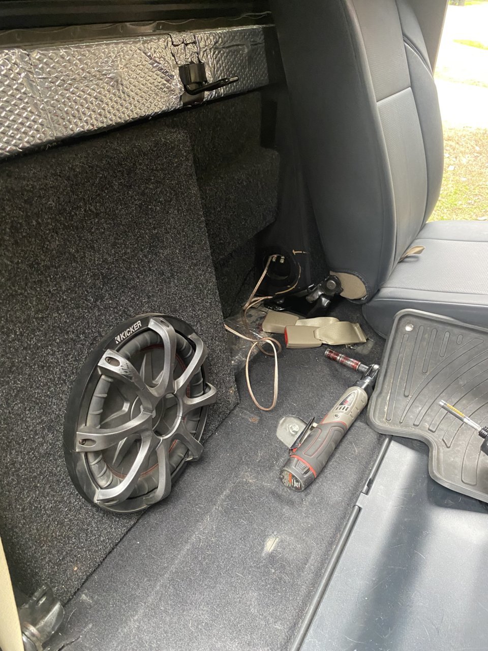

    Ive got 2 kicker comp RT in a ported box 800 watts RMS. It slams pretty good. Ive had it for 5 years and i cant complain at all. Im running a kenwoood KAC 9106d. Its been great and leaves some headroom for the future or just nice to not have the amp running hot on max volume.
