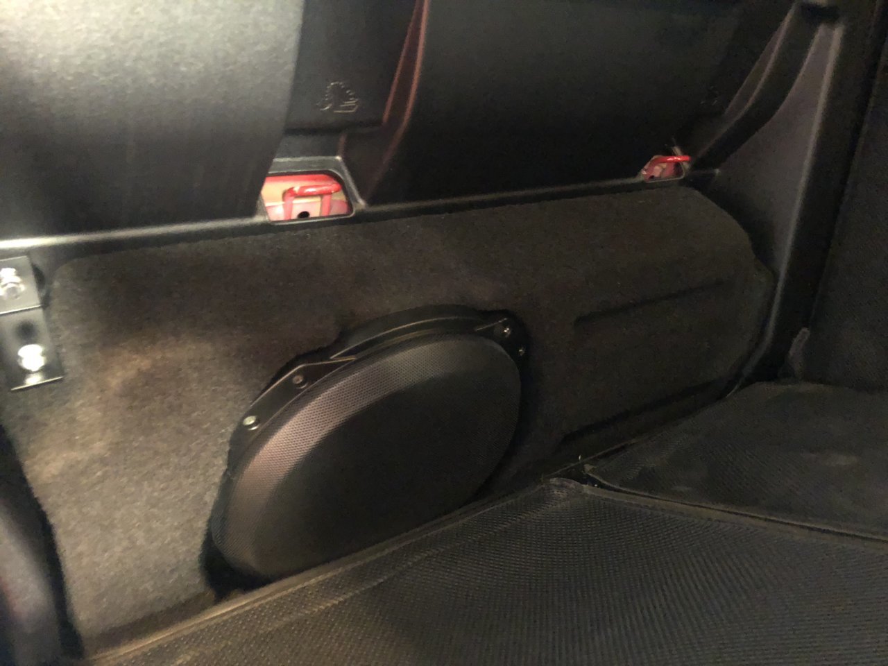

    Just put kenwood components 7" in front doors with tweeters in dash and a JBL micro 8w3 behind the seat with running off a JBL 400/4 sounds great

    Did you use any foam around door speakers or just dropped door speakers in?

    Used MESA damping mat around the bracket in front doors . I left back doors factory as. I like all sound coming from the front.

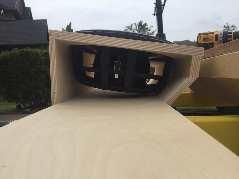

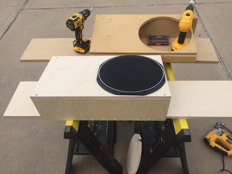

    While there are some good options in this thread already, I thought I'd offer my experience. I was able to build a box to fit a 12" JL 12TW1-4 subwoofer behind the rear seats. I'm using a JL XD600/1 amp, and the sub sounds pretty good. I've never been happy with 10" speakers or smaller, so I pushed the design a bit to fit the 12". I already had that amp and a JL XD600/6, so I used those in combination with an audiocontrol 6 line out converter. I don't love the lineout converter, though, as i dont think it processes the highs as well. But the sub sounds really nice.
    This is a shot of the box before I finished it, showing the basic layout. I mocked it up in MDF first (the above box), and then built a final version out of baltic birch plywood due to some of the dimensions required (I had to use 1/2" material in a few places, and I don't like using 1/2" MDF on sub boxes). You can see in the second image there is very little dimensional margin with the sub in place, but it gave me the proper cubic feet for the speaker. The amps are both mounted on the right side of the sub, and the line out converter is on the left. I don't have a shot of it installed handy, but if you're interested I could get one. I had to remove the two storage compartments behind the seats, but otherwise this fit without modifying the truck.

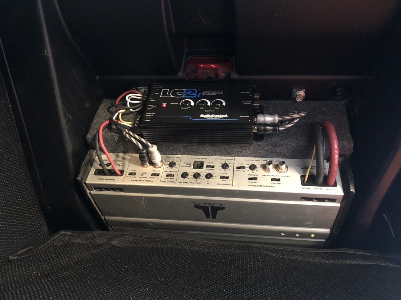

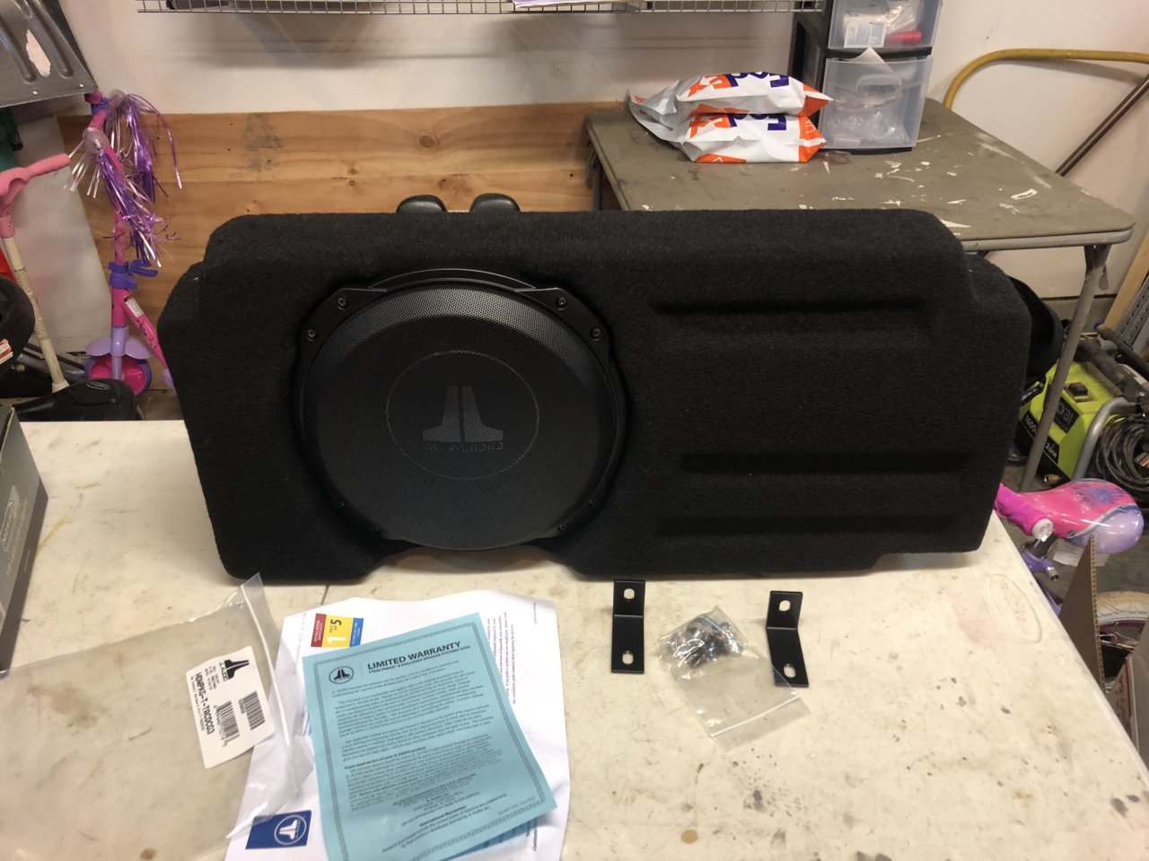

    Installed JL stealthbox it has a 10 TW3 Powered by a JL 500/1
    In the smaller bin I built the amp rack to hold the 500/1
