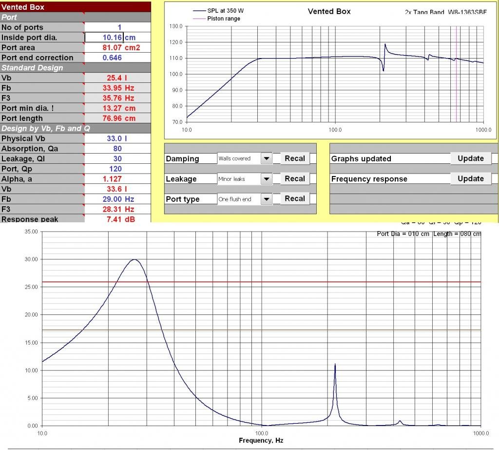

    You know what would be killer is two of these 8's in a 1.5 cubic foot box tuned to like 29hz. Use a 4" port. It would KILL and would sound fantastic. The enclosure models I've done look great. FR is very flat and the F3 is extremely low. I'm thinking about using two in my RX7.
    http://www.parts-express.com/pe/showdetl.cfm?partnumber=264-920
    Here's the model.
