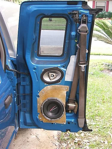

    I would do something like this, and i believe it's a 12, so a 10 would save even more space.

    Yeah it's perfect for hitting the lows for any genre. I also have an after market radio so I can tune it even further

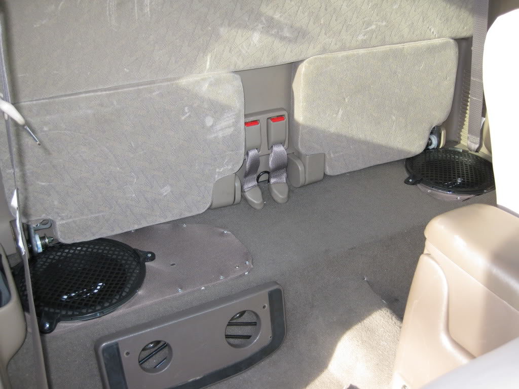

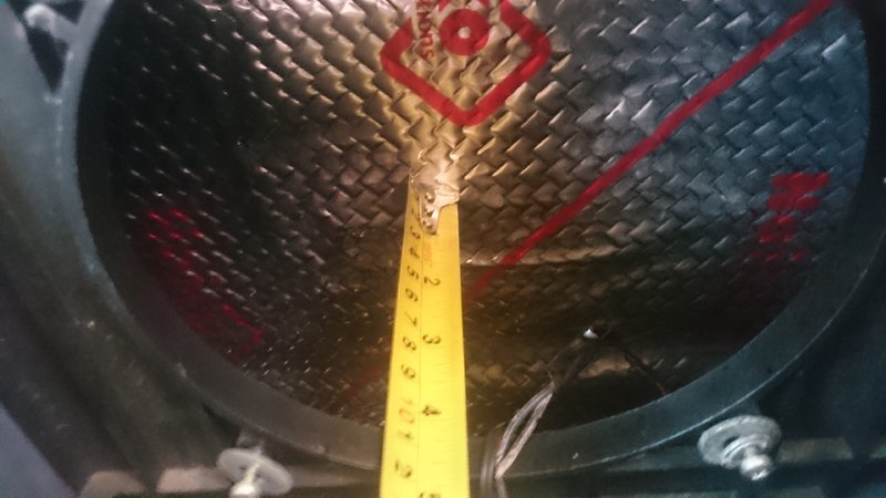

    Thats my plan. An 8" sub will fit PERFECTLY in the speaker cover. Youve got about 4.5" mounting depth to play with and more than enough volume for an 8" woofer. Theres space for some 3.5 or 4" speakers to be surface mounted on the bottom of the panel

    I used one of these https://www.supercrewsound.com/95tacoecconsole.html in my extended cab. It added a nice bass kick, but not teeth rattling bass by any means. Plus side is it kept the rear seats useable. I screwed a couple cup holder to the top of it for the kids too.

    I've thought about that option as well. I've been looking at several different ideas. I had an 8" JBL GTO sub that I really liked. I made a custom box that fit in place of the fold down seat behind the driver's seat. It only stuck out about 2" more than the folded up seat did. Unfortunately it was stolen when my truck was broken into a couple weeks ago. I've thought aboutre placement options such as:
    a. doing the same thing again with a Pioneer shallow 10 and bolting it to the back wall
    b. running 6.75" kicker subs in the stock location free air
    c. using some other 6.5" subs in the stock locations with either glass or spray foam and sound deadening
    d. running 8" subs glassed in the stock location.
    Not really sure which way to go but am open to any of them and others as well. Like most i need to space in the back and just more low end for SQ purposes. Not so much for seating but for ski and MTB stuff.

    Is that a Tacoma? I've never seen that style door before.
  19. Feb 1, 2017 at 2:09 PM
    #39
    WildLand
    WildLand Does Ursus arctos defecate in deciduous forest?
    Dec 16, 2012
    #93212
    10,487
    Josh
    NM
    16T4RSR54WD
    Nah, Ford Ranger
