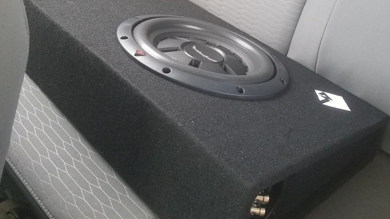

    I chose a shallow mount 10" and fibreglassed a box into the right hand pocket behind the seat. I wanted an invisible system. It works for me. The other option is some of the spacesaver subs out on the market. A little bit more money but less work building boxes...

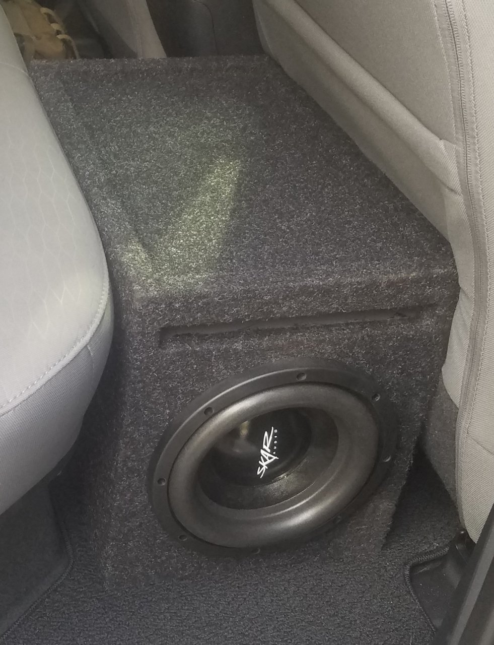

    I had an 8” sub behind the driver rear seat, didn’t like that so I got a 10” in a bigger box behind the passenger rear seat. Sounds way better and cleaner. Feeding it around 600w RMS.

    A shallow 10 behind the rear seats seems to be the best compromise for these trucks.

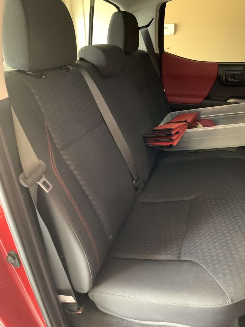

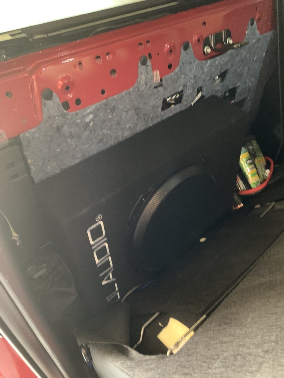

    I played around with sealed and ported 8s, 10s and 12s in various spots.
    Finally settled on a sealed 10 behind the rear seat. Gives the best overall sound for every type of music I've thrown at it.
    The final setup...
    I also pulled the plastic from that section of the rear seat and recovered it in fabric to limit rattles and still allow the most sound and clearance.

    Travis
    Did you paint the metal behind the rear plastic panel and add the carpet on the back wall above the box?

    2017 SR5
    Yes, the rear wall has Dynamat and carpet to finish it off.
    There's just not enough room for a 3rd/4th order bandpass box back there unless you're willing to ditch the entire seat.
    I wanted everything to look stock so that wasn't an option .

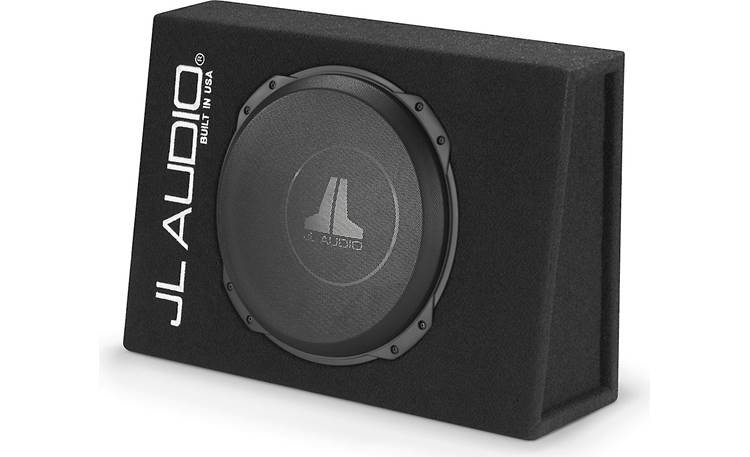

    taco tunes tends to be the go-to
    supercrew sound, sound off audio, the sub box shop, as well as ebay also all carry different variations of the same idea.
    and that's just pre-built boxes only. crutchfield has at least the jl audio option for a pre-loaded enclosure.

    has anyone heard these in the wedge box, or heard them possibly facing backwards? I see a 10in, 12in, and a 13.5in.
