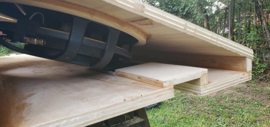

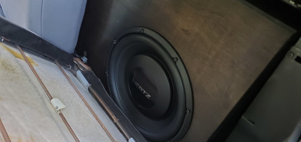

    I know it's approaching a 3 year old thread response but still raises an excellent point. Most of us here bought the trucks because we knew they were going to last 15 years minimum up to 350,000 miles so might as well keep the threads going. Deacon Blues is absolutely correct about magnet diameter width playing a huge role in getting subs to fit with enclosures behind the rear seats. I'm pretty handy with fab skills both with wood and fiberglass ( been doing this for over 20 years) and noticed that the shallow mount subs I bought ( HERTZ MPS300) for my enclosure while around 3.5 inches deep still had more magnet/motor width that in a sense didn't offer much benefit in the way of mounting depth than maybe conventional subs up to a point. In other words I probably could have installed two conventional 12 inch SQ focused subs ( magnet depth 5.75) or three 10 inch in my DIY enclosure than these shallow mounts which can get costly. Sure the shallow mounts might be better given a different install situation where a box has to be more slim across all dimensions under a seat or somewhere else but with these angles required for the tacoma maybe not so much.
    See my pictures attached for what I'm talking about..Going to likely route out an 7.5 inch diameter hole in the back of my existing box per side where the subs mount and fiberglass the opening closed with about 4-5 layers of glass for extra clearance vs the 0.70 inch plywood. I can then build wooden rings to space out the subs to get any extra depth I need. I might have purchased these shallow mounts for no reason at all and can get two 12's I have on hand modest depth subs ( 5.75 or more depth x 6 inch magnet width) to fit in their place. These shallow mount subs are better than they used to be in the past but i still think they are somehow limiting the snap and quick response I'm used to from regular subs....
