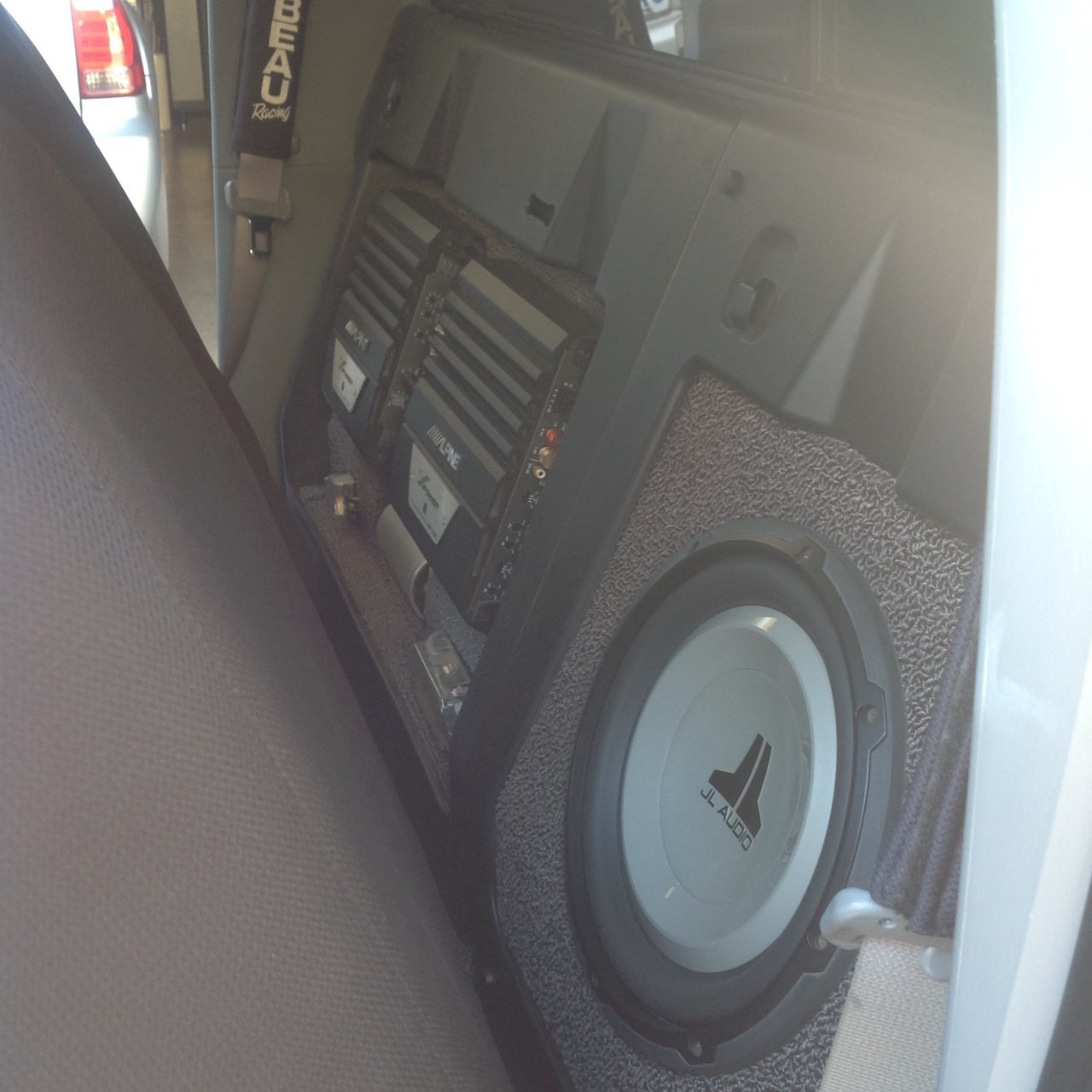

    I put a 10" compact kicker sub in my truck and custom built a sub box to sit on top of the transmission hump right behind the center console. I have the access cab and space is already limited in the cab and didn't want to loose any seats or storage space.
  15. May 8, 2018 at 9:29 AM
    Evenflow
    Evenflow Well-Known Member
    Jul 15, 2013
    #108344
    5,766
    Jason
    San Diego, CA
    06' DCSB 4x4
    Yes
    DIY, still has all of the OE panels used to trim it out and the single 10" hits plenty hard

    I have a single 13TW5V2 - and really want a 2nd one. A 13" is impressive to look at, it sounds super accurate, very high sound quality. But since its thin, it doesn't have a very long z-max which limits its output level. It should be capable of doing a bit more sound when fed its 600w, but it can't by itself. Probably should have gone with two or three 10W3, and fed them 1200w (with the gain down). If I had time, I would be looking into doing a fiberglass box to fit whatever I want.

    They are 10 year old Alpine amps can't remember the model #'s ? One two channel bridged to the sub and a 4 channel running Alpine R series seps in the front and rear doors. Truck is an 06' and I built this set up back in 07'. The sub is a JL slim line 10" and the box I made from MDF and fiberglass. Basically just cut the " buckets " out of those storage compartments, reinstalled them, took measurements and built a custom box to fit behind the panel. Same for the amp rack panel.
