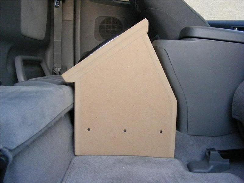

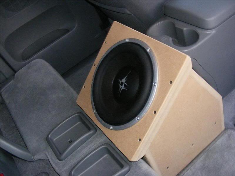

    this is the best one I have found so far for access cabs. it has .96 cf, good for a 1O" sub. Nice flat top keeps the sub protected (down fireing)
