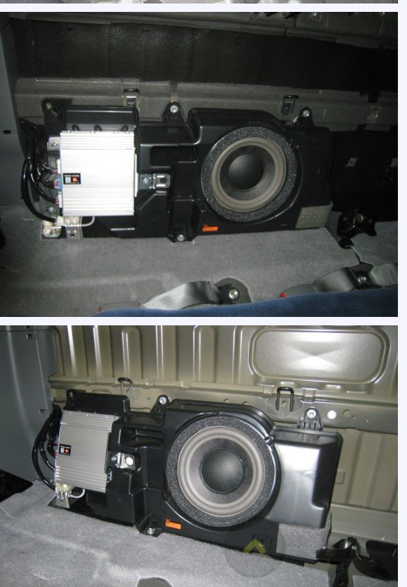

    That is not what I have. I have this[​IMG] Ok so I have been doing some research and realized that the LOC has to tap into a speaker source.@diamondw mentioned that I could tap into the wiring for my stock sub. I would just take the LOC and tap into that wiring and it would work then?

    Looking at both pics, i can see it hiding behind the trim... Is that sub enclosure made of plastic?

    Yes

    That black box with the amp and sub is made of plastic...o_O
    Wow.

    Yeah it rattles like no tomorrow. I just want a new sub with bass!:confused::annoyed:

    I have already pulled that stupid cover off months ago and it still rattles but not as much and only at certain times. I just want something that produces actual bass.

    Oh man, I'd rip that out in a heartbeat. Honestly, rip it out. It's just gonna take up space that you could use to mount a sub and an amp. And you'll be eliminating a rattle.:thumbsup:
