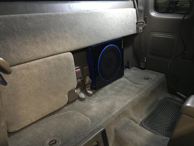

    I used to have a '97 5 lug extracab. I had a 10" sub that I put under the passenger side rear seat. I had to cut a bit of material from the compartment opening, then made an mdf plate for the speaker, lined the inside of the compartment with sound insulation, then mounted the speaker/plate flush with the floor so you could still sit on the seat when folded down. The airspace in the compartment probably isn't ideal for a sealed box, but it sounded fine, and was unobtrusive since the seat was still usable, and looked 100% stock.
    When I sold it, I was able to put the door back on, and because I didn't need to cut any of the carpet, you would never know I had a speaker there. I would have re-used it on my new truck, but I ended up with a doublecab.

    The sub I had in my 5 lug I kept, and built a small box for it to fit behind the rear seat of my doublecab (had to remove the plastic cap on the back of the seat and cut out the liner on the back wall.
    Again, probably not the best sounding setup, but with a moderately powered kenwood deck, stock speakers, and the 20 year old sub (yes, seriously), it sounded just fine. My amp recently crapped out, and I haven't replaced it yet. Mostly because I don't drive it every day any more so it (the sound, or lack thereof) doesn't bug me as much. I may just end up getting one of those self powered units that fit under the seat, to regain a little storage behind the seat.

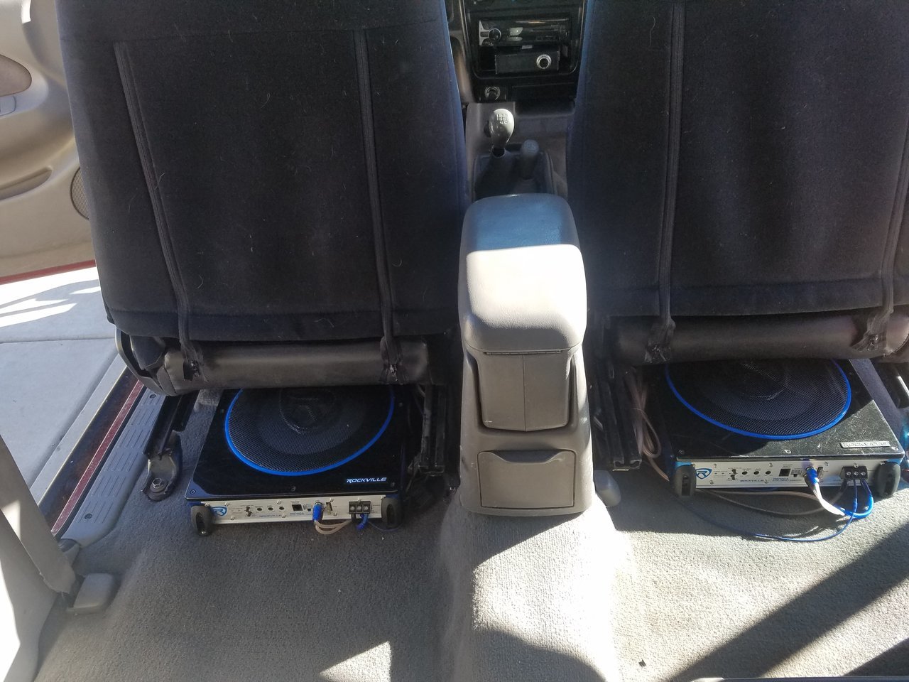

    my whole setup was under 500, which isn't too bad for a nice upgraded system IMO.
    Kenwood Stereo, with wiring adaptor, $130
    (4) Rockford fosgate speakers, $90
    (2) Rockville 10in Subs with wiring, $120×2=$240

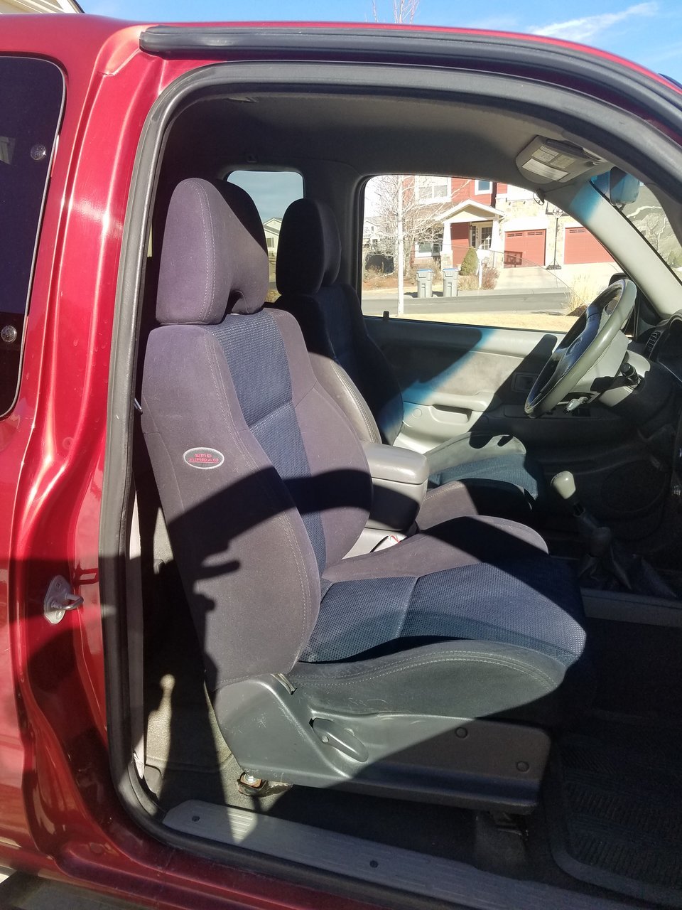

    Nice!! What yr wrx did these seats come out of?
  10. Feb 3, 2018 at 6:58 AM
    #30
    Tacofire98
    Tacofire98 Well-Known Member
    Jan 5, 2016
    #174116
    882
    Jake
    Castle Rock
    01 TRD
    02 or 03
